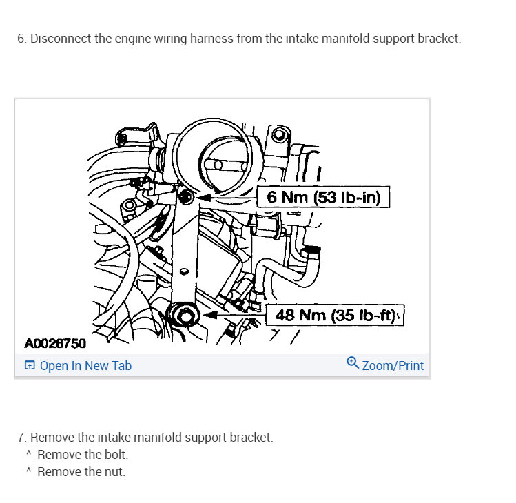

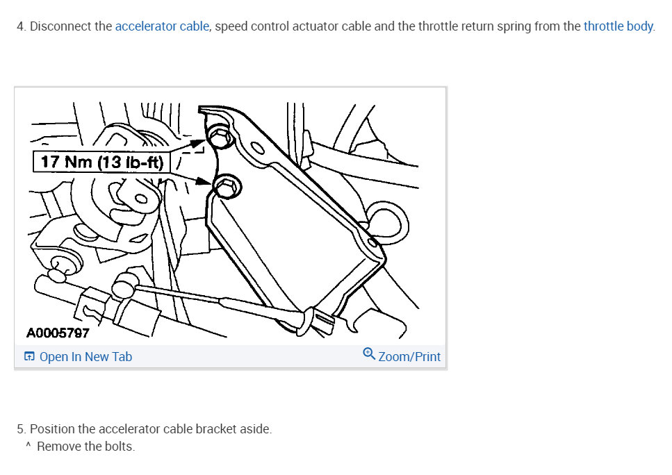

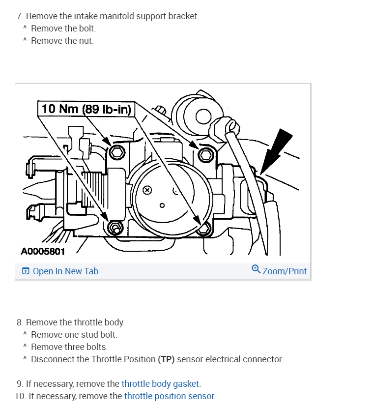

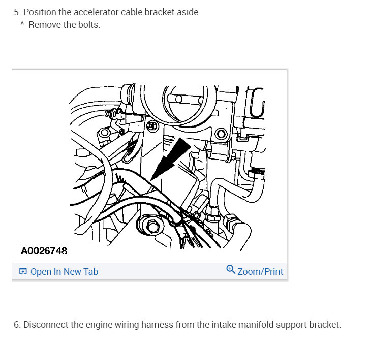

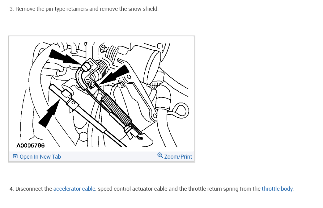

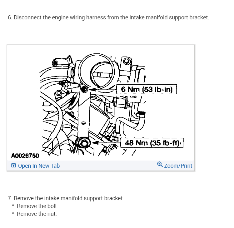

I would service the throttle bore and replace the idle air control valve, which is on the throttle body as well.
Here is a guide to help with instructions below to help you with the repair:

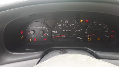

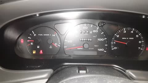

This has actually already been done. I forgot to mention it as it was late on my initial write up. The IACV was one of the first things I replaced since the old one was 20 years old. I am uploading a video of it trying to start during the night when it's roughly 80 outside. Once it passes 90 this afternoon, I will take another video of how easy it starts and stays running.

Once the cabin reached 90 degrees, as stated in the first post, I was finally able to record video. The two videos attached are taken 6 hours apart. If it is below 90 degrees, especially in the cabin, it will not run. It is beyond perplexing as with no CEL it is hard to diagnose, and I have replaced so much already. Hoping having both videos can help.

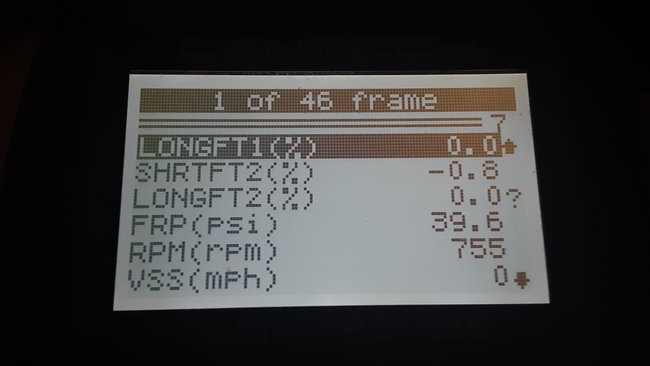

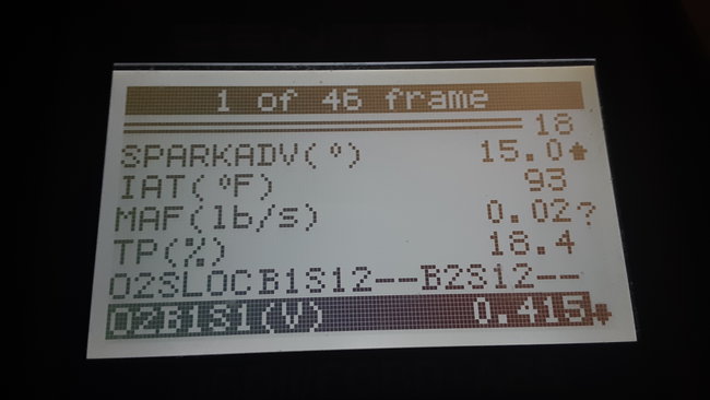

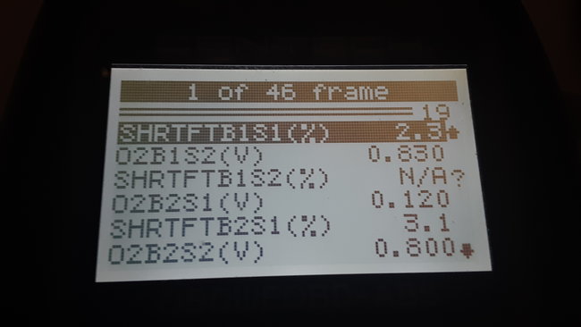

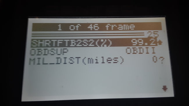

Here is more information to add.

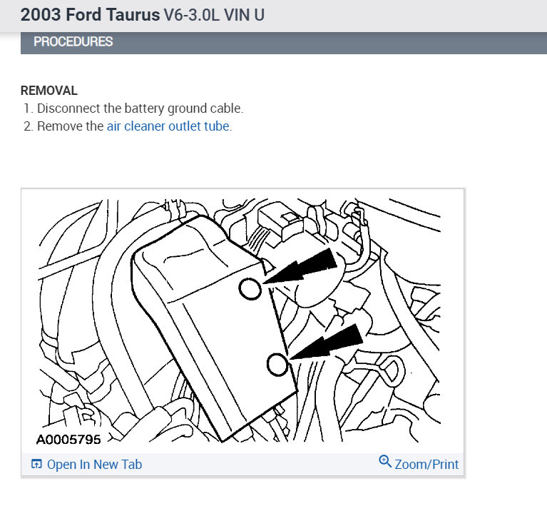

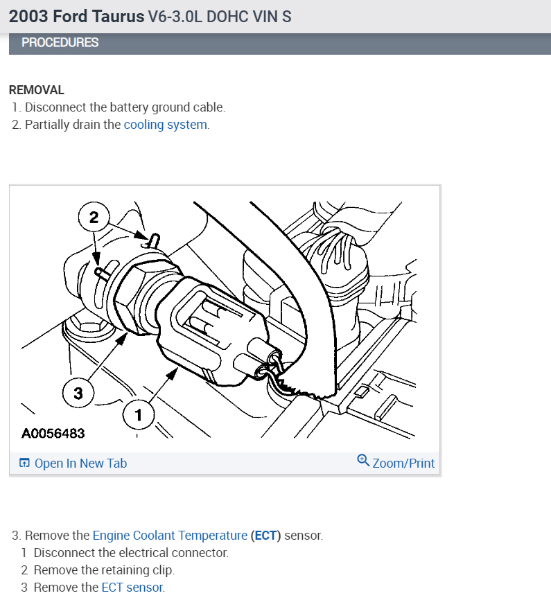

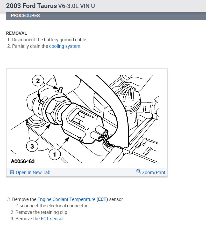

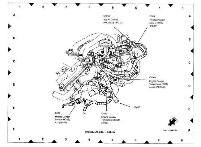

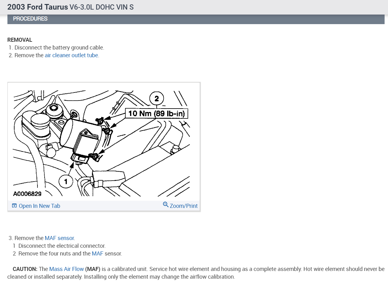

Thanks for the video and the data, I noticed on the last data pic the MAF sensor reading is close to 0 was this with the engine running? If so the MAF is bad, or you have a leak between the throttle body and MAF. Also, if this is not the case, I would swap out the engine coolant sensor, here is the location of both sensors so you can check it out. Check out the diagrams (below). Please let us know what happens.

Yes, this was recorded live data while the engine was running. I had to wait till it warmed up outside for it to start and stay running. Will only do it when it goes past 90. It is strange the MAF has not triggered the CEL. I will look into this and get back to you as soon as I can. Heavy rains here at the moment.

No can do. I'm in Texas and we need it. XD I have ordered a new MAF and should be here in a few days. I honestly didn't notice how low that voltage was. I hope we can solve the problem. Fall is coming and since it won't start or run when it gets below 90 going to be a problem.

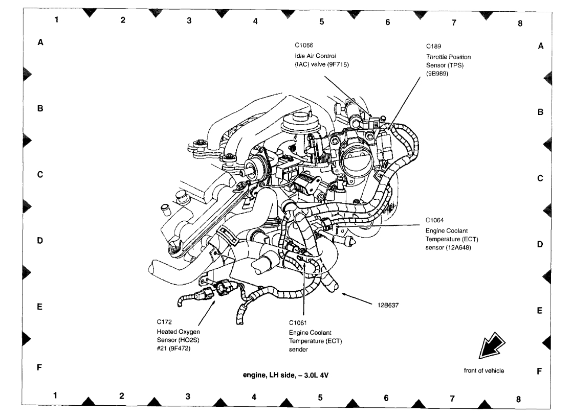

Okay, it sounds like the engine coolant sensor is bad here is the location so you can check it out. Check out the images (below). Please let us know what happens.
