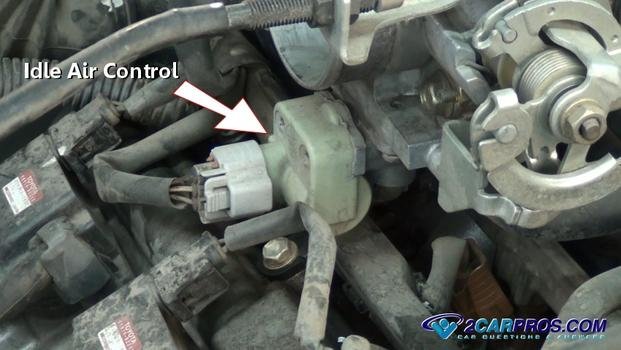

You will need a scanner to do this. However, many of the nationally recognized parts stores do it for free. Also, when you reply back, I would like to know what the idle speed. It may be an issue with a idle air control valve not increasing the idle under a load.
Here is our web-page which explains its function. I have also attached a picture so you know what you are looking for.

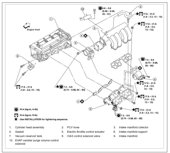

Ken, as it turns out the vehicle does not have an EGR valve or an IAC valve, it does have an intake manifold runner valve, could this be the culprit?

It does not sounds like it. It sounds more like the throttle body or throttle pedal position sensor needs to be replaced. It stalls and revs to 8,000 rpm?
