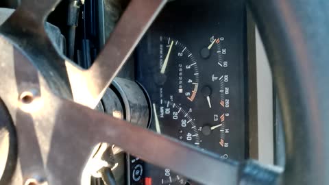

Vehicle had no previous signs that something was going bad. No sputtering, etc. Being that I had (within last 4 months) replaced the fuel filter along with a bad fuel pump, I looked elsewhere towards the problem. After noticing that I had a weak spark, further investigation revealed that I had a bad coil, cap and rotor. So I replaced all three, along with all new spark plugs and wires. Same problem still existed. I was then told that the distributor pick-up could be bad. Which it was severely worn, so I replaced it also. Same problem still existed. I then looked back towards the fuel. So I checked fuel pressure by dissconecting the fuel lines directly behind the carburator (to maybe rule out the possibility of a bad regulator. I did not test with a guage, but the fuel pressure was weak (5-10 lbs. maybe) streaming from the dissconected fuel lines.
This pressure I am told should be around 50 lbs. A mechanic that was standing there said that was definately a bad fuel pump. Telling him that I had recently replaced it, he still insisted that it was bad because I had bought a cheap one from the parts store. SO, I drained and dropped the tank again. Replaced a new sending unit (with new pump and new sock) and new fuel filter again. Started it back up . . . . thinking all was well . . . . then it stalled! It will sometimes restart right away again, and sometimes it will not. It will run for about 10-15 minutes before it stalls. But if I sit in the cab and keep my foot on the gas, I can keep it form stalling. Comepletely let up, and it stalls. Once the vehicle is cold again, it seems to start again. Once it warms up, it seems to stall as described (with no real sputtering or anything) it just dies.
I am now thinking that I could be dealing with a bad Coolant Sensor? Or could this be a bad crank sensor or something? But will say that I am leaning towards some kind of sensor, relay, or module. Where else can I check or look for faulty parts? Your guess could do no harm at this point! (lol) Thank you for any suggestions! My wife and daughter would be extremely grateful if I could get my truck running again and they could have the car back to themselves! Thanks from all of us!

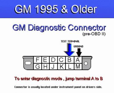

First question for you is, is the SES light on? or intermittently on? If yes check for codes, if none found, check battery voltage with engine running and off, then a real fuel pressure test...you did not say if you replaced the ignition module, which seems more like your problem than the others, but before you go there, remove the idle air control valve and clean the hell out of it and the throttle, and if you have an oil soaked aftermarket air filter, replace the MAF! Read codes this way!
https://images.2carpros.com/forum/automotive_pictures/62217_95_OlderGM_14.jpg
Cross these two terminals as shown, then turn the key on. Count the flashes, a 22 will flash as 2 flashes then a short pause, then 2 flashes, if more than one code is stored, the pause will be longer. The codes will display three times and end with 12. Write them down and post here.
