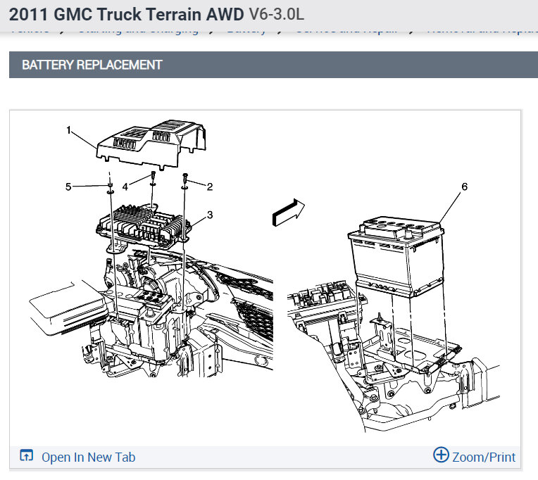

Power comes on, but car won't start and hear buzz from fuse box area.
Jan 13, 2024 at 10:38 PM
  • 54,503 POSTS

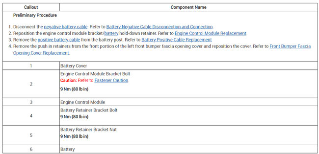

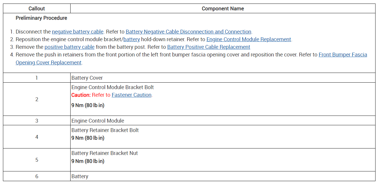

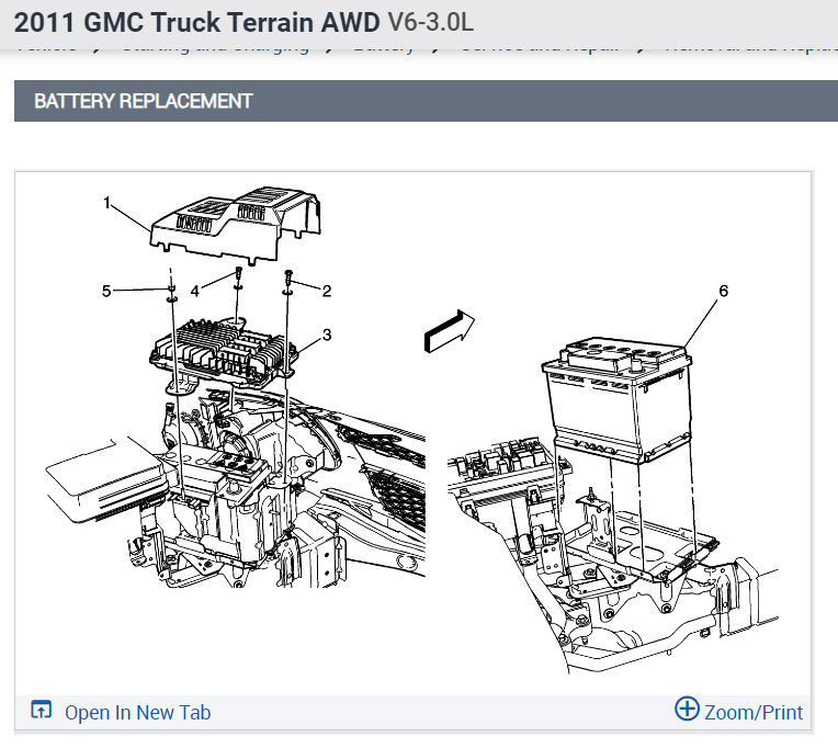

So, even if the system comes on it could be low on voltage/amperage. If the battery is more than 3 years old, I would remove it and take it to an auto parts store for testing which they will do for free.
Here is a guide to help with the steps and how to do the job on your car:
https://www.2carpros.com/articles/how-to-replace-a-car-battery
You can help confirm the failure if you use a voltage meter on the battery on try to crank the engine over while watching the battery voltage which should not drop below 10 volts.
Check out the images (below). Please upload pictures or videos of the problem so we can see what's going on.
