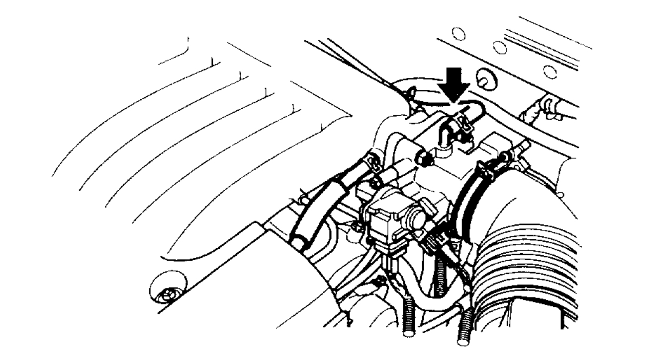

Okay, so I checked all the vacuum lines. All the hoses are good, but I could hear air leaking. On investigation I found what I believe is between the throttle positioning sensor, and another sensor air leaking out. There is another sensor right in front of the throttle positioning sensor. I don’t know exactly what it is. But in between the two I can feel air. Is it possible that the throttle positioning sensor is bad and it’s leaking out of there all of this is near the throttle body. I can’t see any other indication of where else it could be.

Yes, the throttle bore can be worn allowing vacuum to leak out at the butterfly shaft. CAN you remove the throttle bore to confirm? Here is how to remove it, if it seems okay, please service the unit once it is removed.
Here is a guide to help:

I clean the throttle body I even replace D throttle positioning sensor. It was missing the O-ring. No air is coming out in that area anymore, but I still have that little Miss only in drive and reverse Is it bad. What’s next?

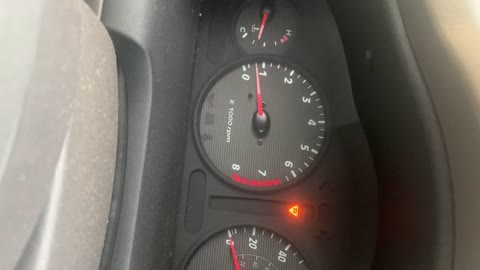

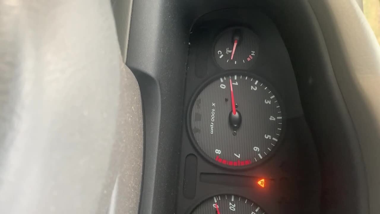

Can you upload a video of the engine misfiring so I can see what's going on? I would run the codes as well. You could have a cylinder that is low on compression.

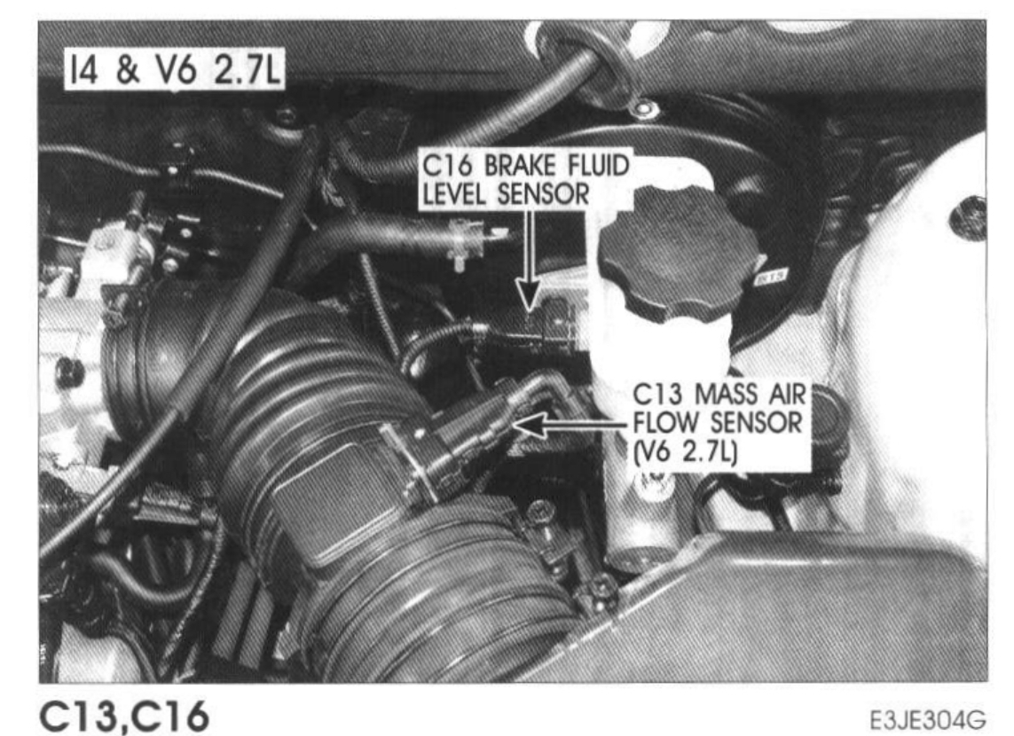

You might want to try to clean the MAF sensor or replace it.
here is a guide to walk you through the steps:
https://www.2carpros.com/articles/mass-air-flow-service

Yep, this is ignition related, thanks for the video. If all the spark plugs are new and correctly gapped, I would do a set of ignition coils and wires. Let me know.
