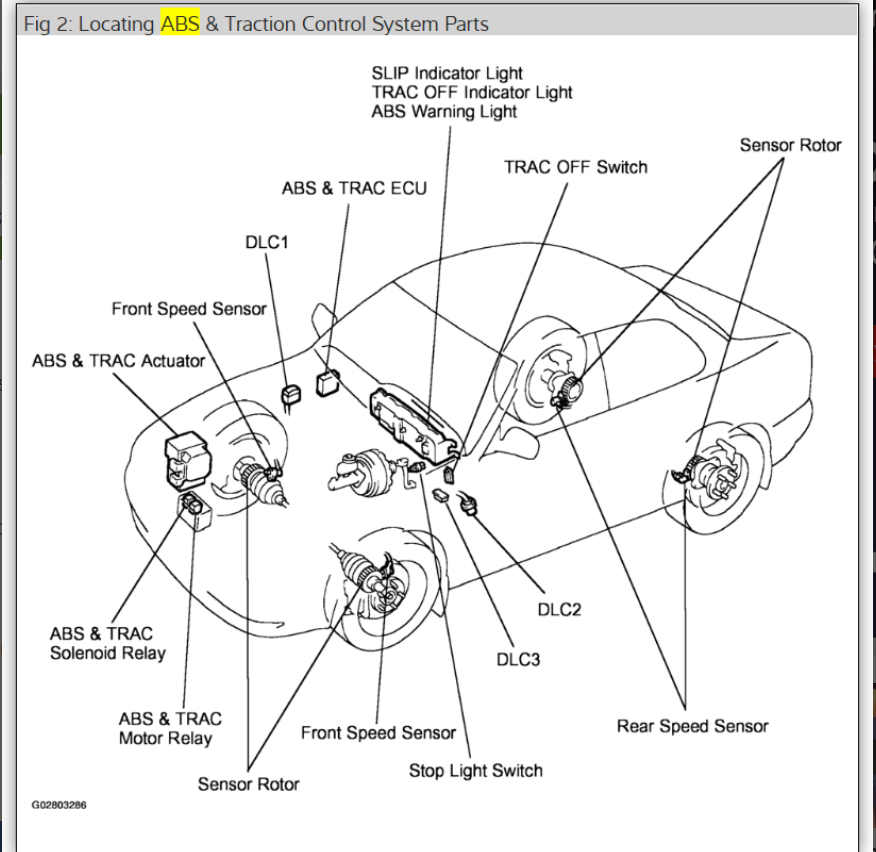

JIS001
  • 3,412 POSTS
Hello and sorry for the late reply. The sensor is located under the center console. Attached image below. Hope this helps you narrow it down.

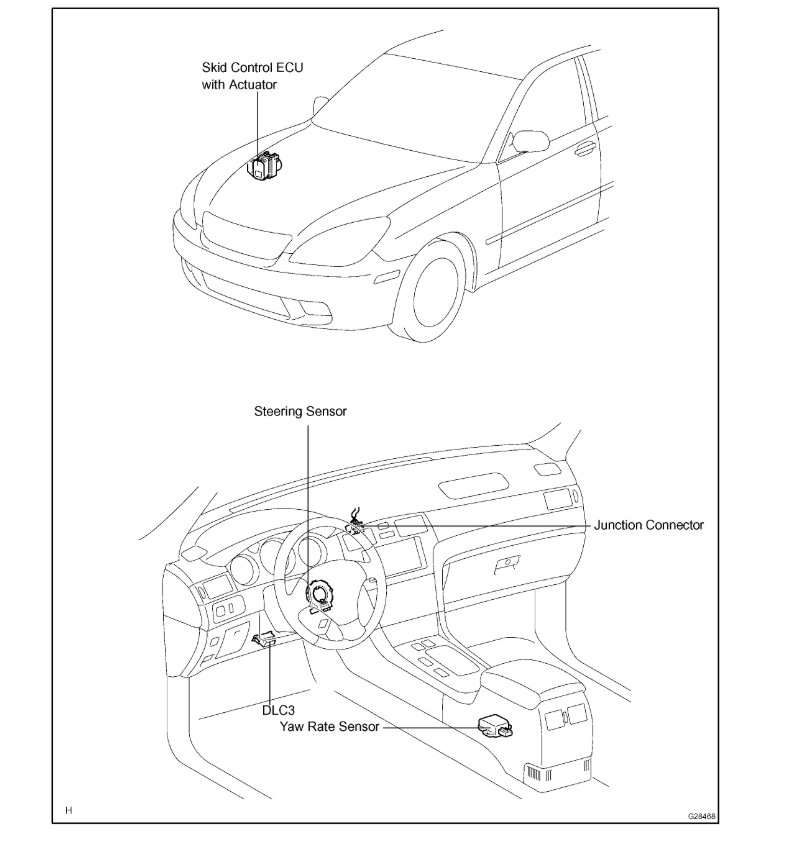

KEN L
  • MASTER CERTIFIED MECHANIC
  • 55,522 POSTS
This is a yaw sensor issue which is located under the rear floor center console. Here is a diagrams below to show you where. (DLC2) Check out the diagrams (below). Please let us know if you need anything else to get the problem fixed.

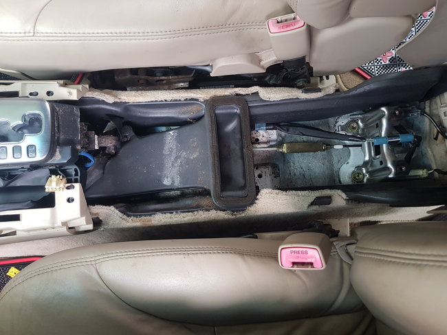

BADEWOLE EMMANUEL
  • 16 POSTS
Image.

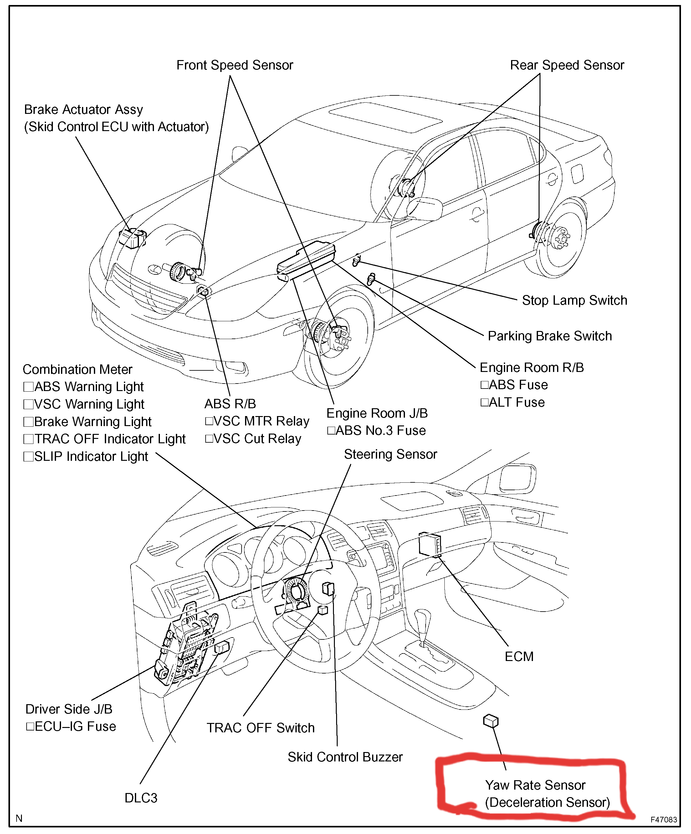

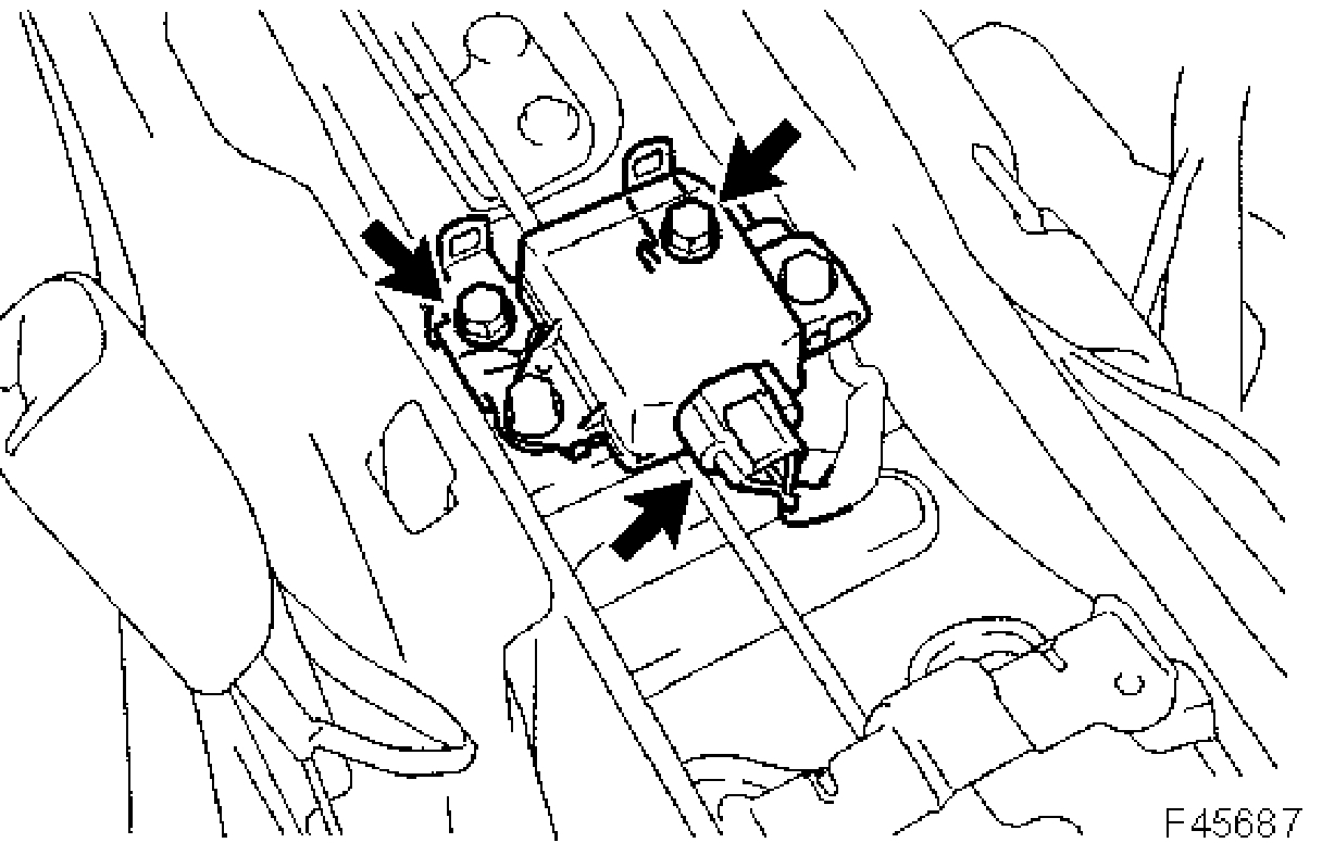

KEN L
  • 55,522 POSTS
Here is a better image. It looks like it is under the center console. Check out the diagrams (below). Please let us know what you find.
Sunday, June 30th, 2019 AT 11:23 AM
BADEWOLE EMMANUEL
  • 16 POSTS
Yeah. That is exactly where searched and I could find it.
Sunday, June 30th, 2019 AT 12:03 PM
KEN L
  • 55,522 POSTS
Is it under that ducting, did someone remove it, do you see a wiring connector? Can you please take more pictures?
Monday, July 1st, 2019 AT 10:56 AM
BADEWOLE EMMANUEL
  • 16 POSTS
It is not under that ducting. I don't see the wiring and I don't know if it was removed or moved by someone else. I don't have the history of the car.
Monday, July 1st, 2019 AT 5:26 PM
KEN L
  • 55,522 POSTS
Yep, someone took it out not knowing what it is. You will need to take apart the car further to see what happened to the wiring harness.
