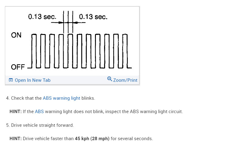

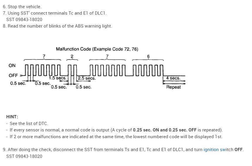

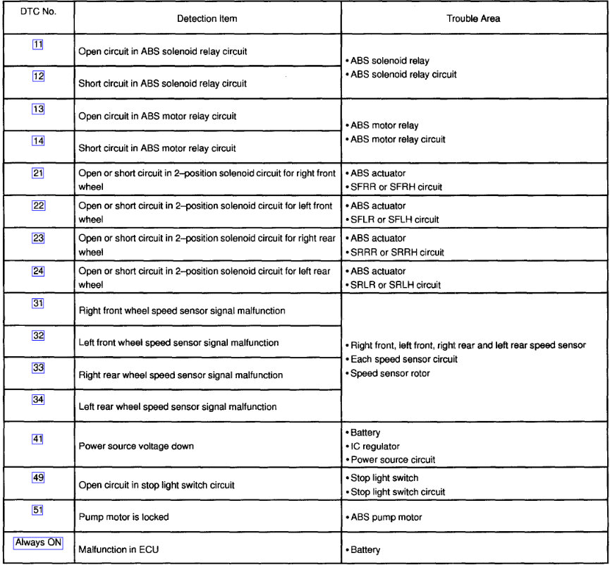

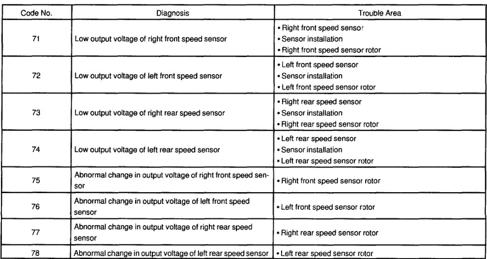

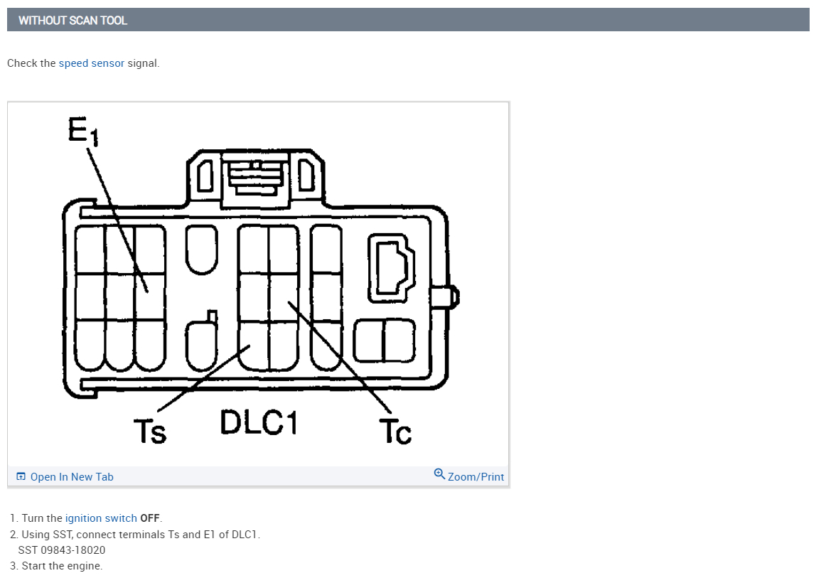

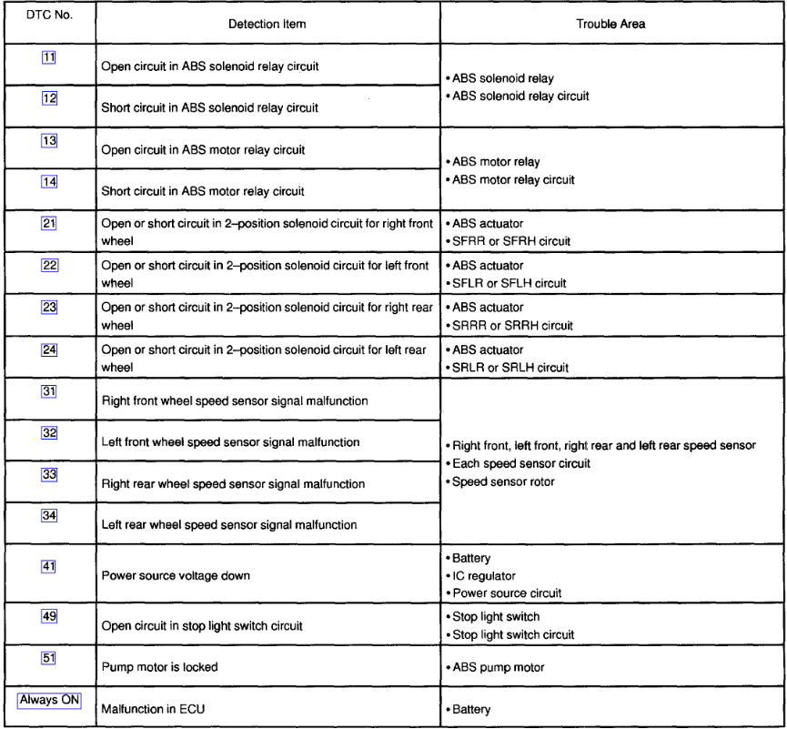

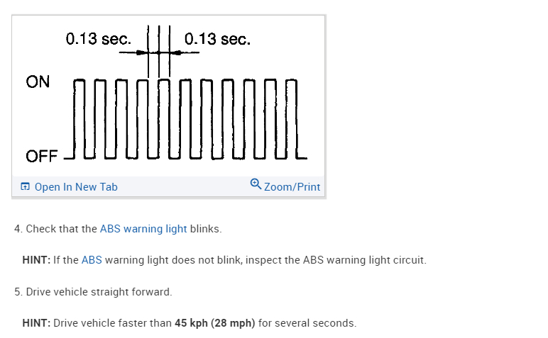

Are you able to count the number of blinks after the 3? The flashes should be a 1/4 of a second apart. Is it possible there is 1 flash and then 3 and then the steady flash after that. A code 31 would be Right Front Wheel speed sensor, so passenger side front. The listing starts with code 11 so there is no code 3. Does it repeat the flashes after two minutes? I'll post the code lists for you.
This is just the ABS light flashing, not any Traction control light as well, correct?

I have come to tell you that I have solved the P0500 by replacing the right front abs wheel speed sensor and the problem solved. I have yet to replace the left front ABS wheel speed sensor to complete the speed sensor circuit.

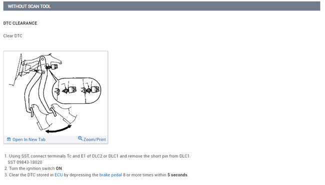

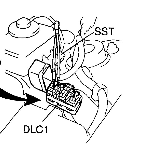

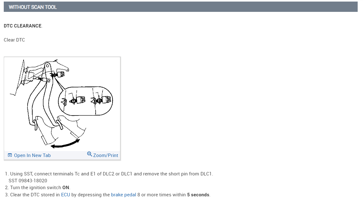

Okay cool, so it was a code 31, To clear the ABS codes without a scan tool, Ignition switch Off,
jumper to Tc to E1 with the Shorting pin removed, Key On, press the Brake pedal 8 times in 5 seconds. Recheck for any codes, Constant flashing means no codes. It doesn't say, but Id assume key Off, then pull the jumpers out and reinstall the Short Pin where it was, and that should be all.

I have done that but it didn't work, I jumper E1 and Ts: it blink 3times and begin to blink faster, then I jumper E1 and TC, that was when I began to get Code 31 and 32 only even after replacing one side of abs sensor

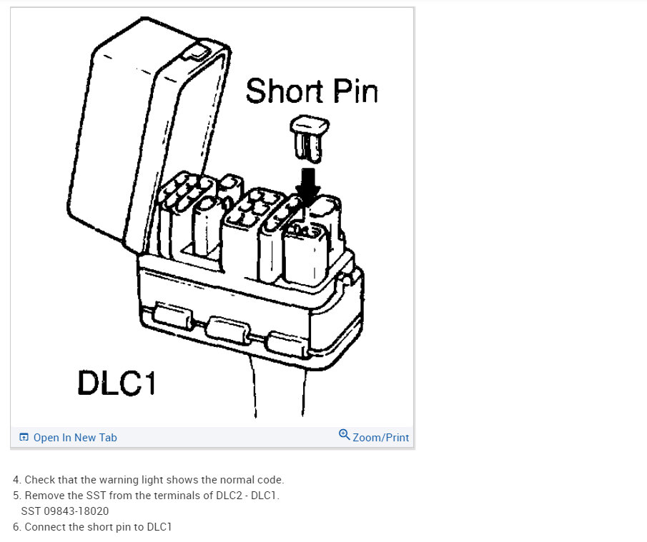

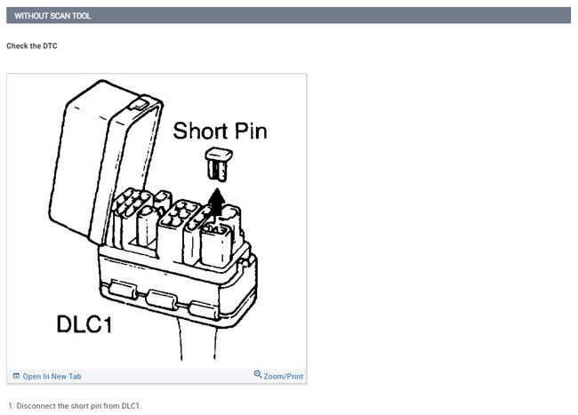

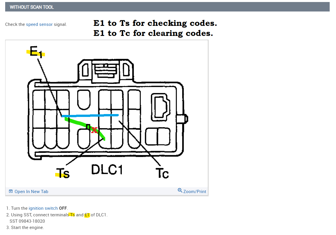

Did you pull out the Short Pin jumper the first time you pulled the ABS code? I'm wondering if service info is incorrect with that. I don't remember the code retrieving section had that included. E1 to Ts is for pulling codes, the E1 to Tc is for erasing codes.

Did you pull out the Short Pin jumper the first time you pulled the ABS code? Yes I did

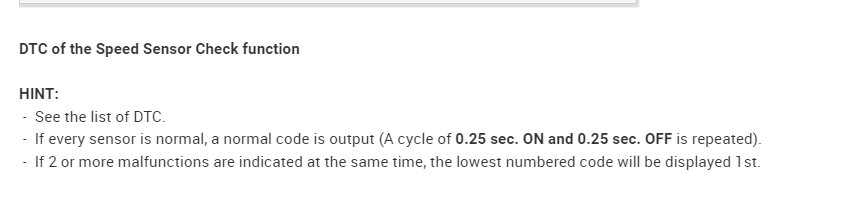

It wasn't in the Speed sensor circuit check, look back at the first code retrieving info on the first page. There was no Short Pin jumper taken out. This is the last code instructions, this was what gave the 3 and multiple flashes after.

On my own vehicle, the short pin was not even there at all.

Which terminal is the correct one for clearing codes E1 and TS or E1 and TC?
Wednesday, August 9th, 2023 AT 8:00 PM
AL514
  • 5,565 POSTS
Tc and E1 to clear the codes, and the Brake pedal 8 times in 5 seconds.

I have done that by jumper E1 and TC and immediately the ABS light began to blink, I depressed the brake pedal and it off, when I released the pedal, it came back and only return Code32 while code 31 is gone. Now if you jack up the right front tire and engage gear and spin the tire, the combo meter will work, but if you jack the left front tire and engage gear and spin the tire, the combo meter will not work. I replaced another used ABS sensor and first wanted to clear it, it wipe and return back. So, I will look for another tone ring and shaft head to retest it.
