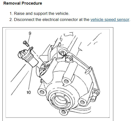

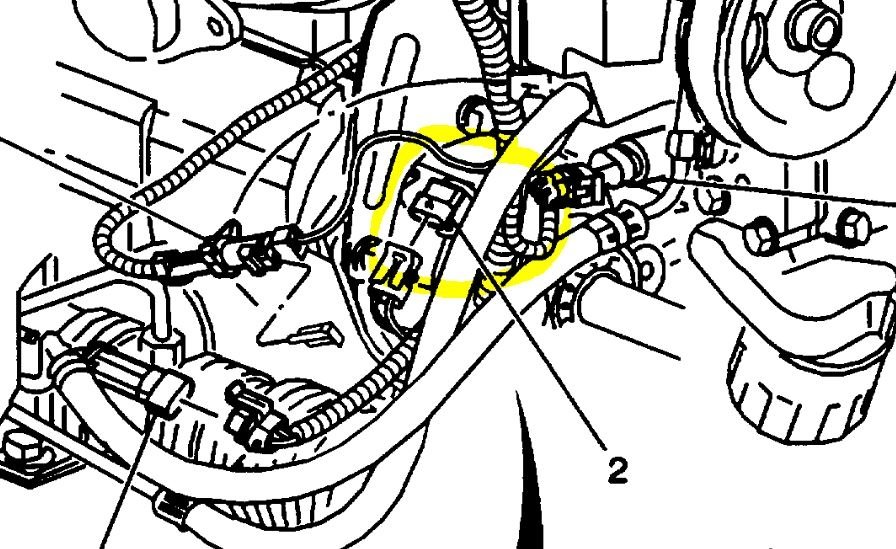

This is caused by the vss going out which is location in the diagram below.

Suddenly my speedometer is not working. I recently had my serpentine belt replaced and I'm wondering if they accidentally did something to the seed sensor? Where is it on the car listed above with a 3800 engine? If I can reach it I'll check it out. Or what else could it be?
Tuesday, July 21st, 2020 AT 1:54 PM (Merged)
Good evening,
Does the odometer work? If it does, it is not the speed sensor. If it does not, then good chance it is the speed sensor.
It is on top of the right side axle shaft where it goes into the transmission. It is close to where they were at replacing the belt.

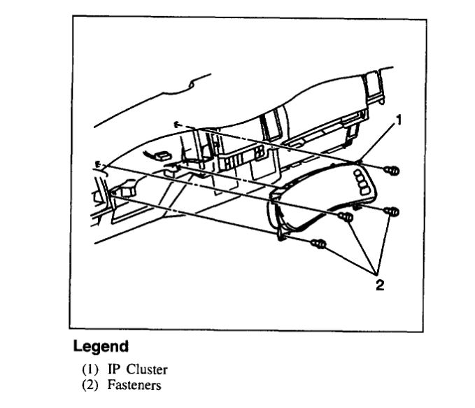

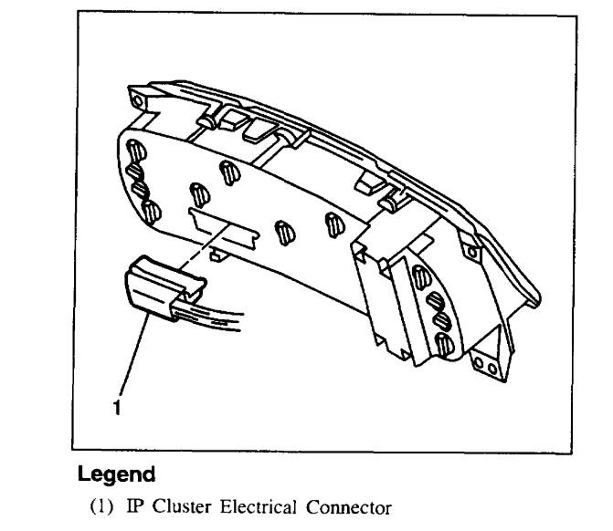

Okay, then the issue is inside the cluster, not the speed sensor.
You will need to remove the cluster and send it out for repairs. There are places you can send it that will repair it in one day. You need to remove it, box it up and send it out.
Should take you less than thirty minutes to remove it.
REMOVE OR DISCONNECT
1. Left and right IP end caps.
2. Left IP accessory trim plate.
3. IP cluster trim plate.
4. Lower steering column.
5. Cluster fasteners.
6. Instrument cluster.
7. Connector from cluster.

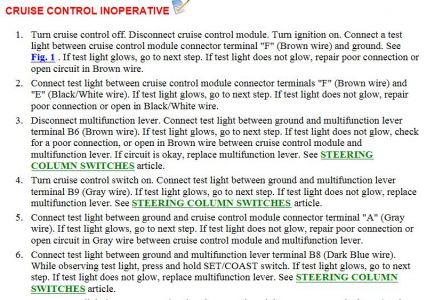

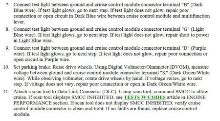

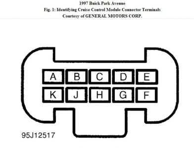

I recently had my 97 Park Ave repaired as it would stop running and when restarted it ran ok but the speedometer had quit working. I took it to the repair garage and they replaced the vehicle speed sensor on the right side of the transmission. Since then the vehicle runs fine but the Speedometer and cruise control do not work and the garage says that the computer is not showing any trouble codes and they also checked all of the fuses. What do you think the problem could be?
KHLOW2008
  • 41,814 POSTS
Hi laz5514,
Thank you for the donation.
The vehicle speed sensor (VSS) sends it signal to the PCM, cruise control and speedometer and since you have the vehicle running well after replacement of the VSS, the PCM is getting the signa but the cruise control and speedometer are not getting the signals.
If the problem is with the Instrument Panel Cluster ( IPC) the cruise control should work as the speed sensor is providing the signal.
The most likely cause would be a broken wire connection between the VSS and cruise control and speedometer.
Here are the testing procedures for the cruise control which might help in solving both problems.
https://www.2carpros.com/forum/automotive_pictures/192750_CruiseControl97ParkAvenue01_1.jpg
https://www.2carpros.com/forum/automotive_pictures/192750_CruiseControl97ParkAvenue02_1.jpg
https://www.2carpros.com/forum/automotive_pictures/192750_CruiseControl97ParkAvenue03_1.jpg
