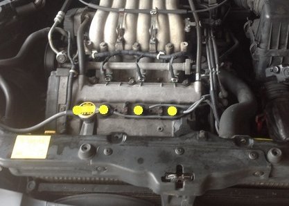

Where are the spark plugs located?
Saturday, April 28th, 2018 AT 10:05 AM
STEVE W.
MECHANIC
15,704 POSTS
They are hiding under the spark plug boots on the top of the engine. See the attached picture. Those covers are removed and the plugs are in the pocket under them. You need a plug socket and an extension to reach them.
