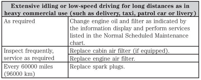

Hello.I have a 2015 focus st and it needs spark plugs.the manual calls for motorcraft SP-537 plugs.when i go to the ford parts website it calls for SP-527.can you tell me the difference between the two?The SP-537 plug gap is .051 which seems a little big for the application as would cause fouling over time.I also noticed that the 2014 focus st takes SP-527 but says that the 2015 takes SP-537 not SP-527.im confused.Did something change with the 2 model years?

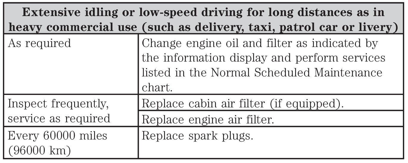

What makes you think it needs new plugs? Having a misfire or other issue? Those are Iridium plugs that generally are 90-100,000 mile plugs.
The difference in plug numbers
SP-537 - Turbocharged 2.0 .051 gap
SP-535 - Non-Turbo 2.0 .051 gap
Or just check on the tag under the hood.
The Ford service interval shows 60,000 miles for severe duty and then only with the turbo 2.0, Normal service shows 100,000 miles.
