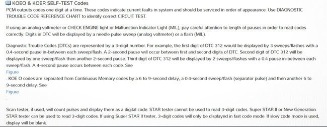

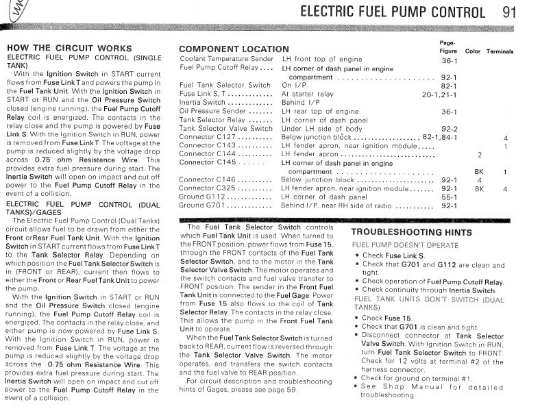

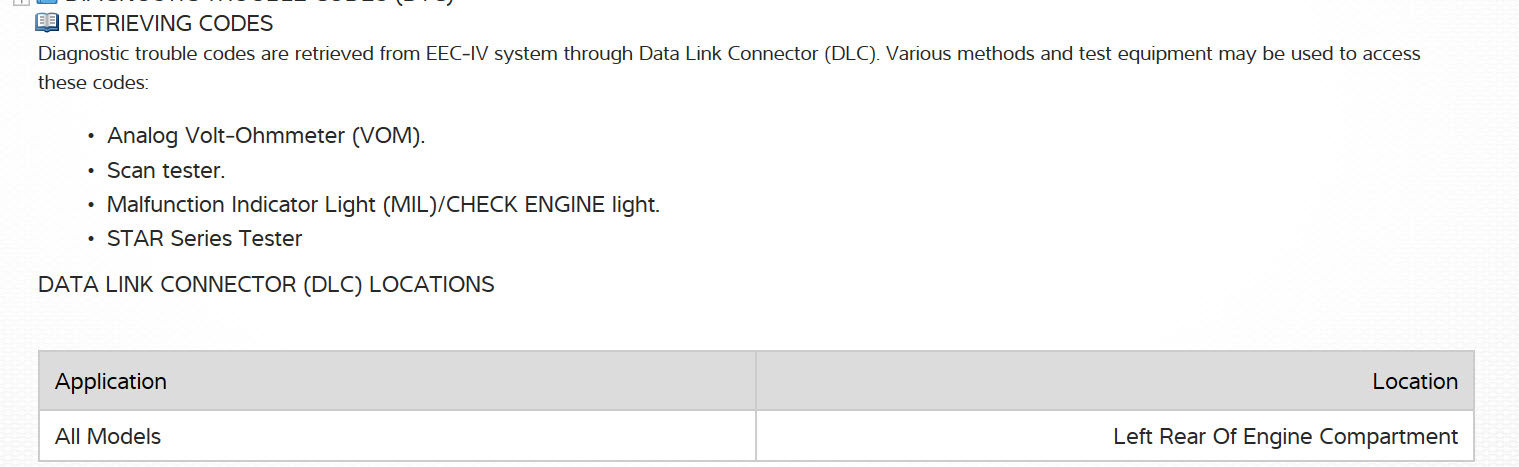

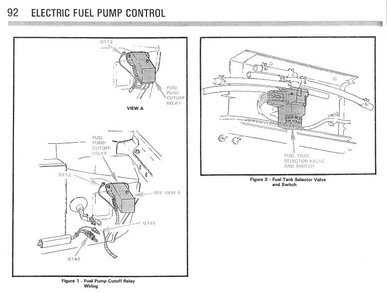

It will turn over and sometimes run for a few seconds but it misses really bad. It broke suddenly while I was driving it. I have checked the timing chain and it is fine, I have checked compression and 7 of the cylinders had a solid 130 psi and cylinder #7 had a max of 90. I believe it may be an ignition coil or a spark issue but I am not sure. Any ideas?
