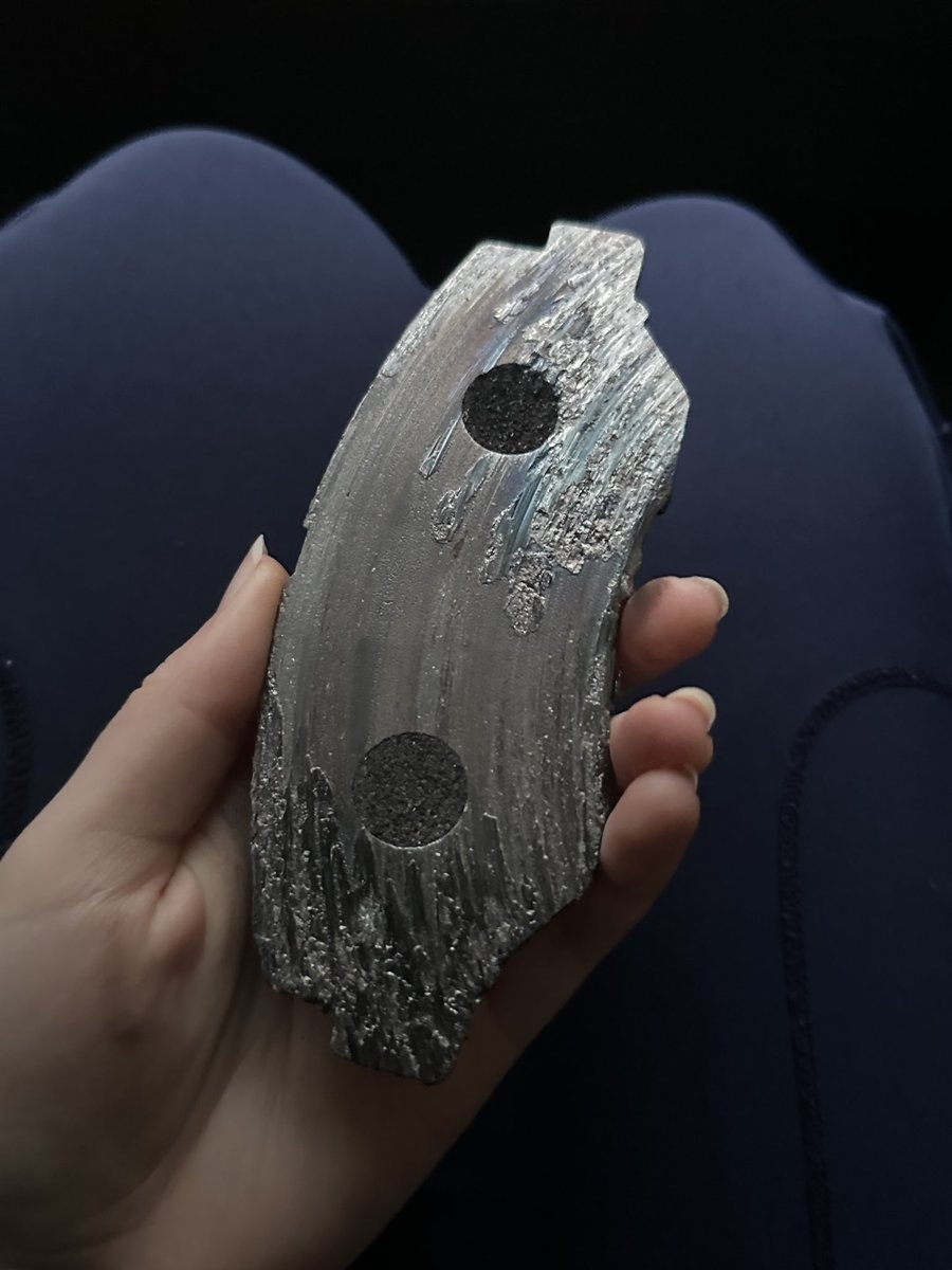

Hi. What is this that fell out of my car??

That's the important part of a disc brake pad. Is there a chance you simply hit it on the road and it came from a different car? These linings have been known to rust off their metal backing plates, but as soon as that happens, you would observe the brake pedal goes further to the floor the next two or three times you press it. With enough pedal strokes, that brake will self-adjust, then the brake pedal will feel normal again, however, the metal backing plate will be grinding on that brake rotor. You will hear that. The grinding is going to wear that rotor down very quickly. That can lead to total loss of front or rear brakes, and in some cases can cause that wheel to lock up.
If a mechanic looks at this right away, the cost is likely to be little more than that for a normal brake job. At the mileage you listed, it's getting close to time for a brake job anyway. Also, to keep weight down, brake rotors are made so thin that they often can't be machined, like we always did in the past, and remain above the published, legal limit. Today regular, or normal brake jobs usually have to include new rotors too.
In this case, the tabs on each end indicate this IS that metal backing plate. I've never seen that part fall off as those tabs keep them in place. If I found this on the road, my first thought would be it fell off someone's load of scrap metal on the way to the recycler. Do you hear any unusual noise when braking? Any warning lights on the dash? How do the brakes feel?

Oh yeah, i do hear that grinding sound every time i brake. The brakes didn't go to the floor but i did feel it going way further than usual. I remember i needed to press harder because i was getting too close to a car and i hear a bang followed by griding noise. I thought i might have driven into something, then i realized something came off

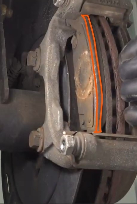

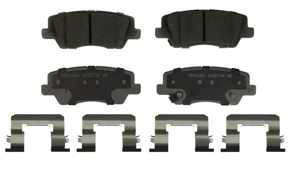

On a CTS-V that could be a rear brake pad backing plate that holds the material that stops the car. Normally they should look like the image below. I have seen brakes fail this way, the tabs that Doc referenced normally hold the pads in place, however on the calipers in that car it is possible that a bare plate like that can fall out if the other pad is also worn, it allows enough room that the backing plate could slip through the opening between the caliper and rotor.
The problem is then, if it's the outer pad that failed, the caliper will be scrubbing the rotor, If it's the inner pad the brake caliper pistons will now be scrubbing the rotor. If this just fell out I would have the car towed to the shop and have all the brakes checked. If the pistons haven't started hitting yet, a simple brake job with pads and rotors, probably on all four corners if that wear is any indication of the others. If they have started hitting then you will need at least that caliper.

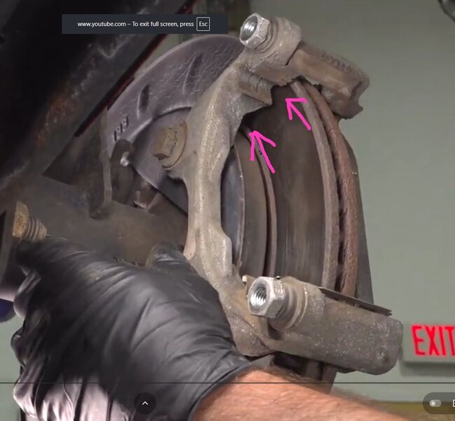

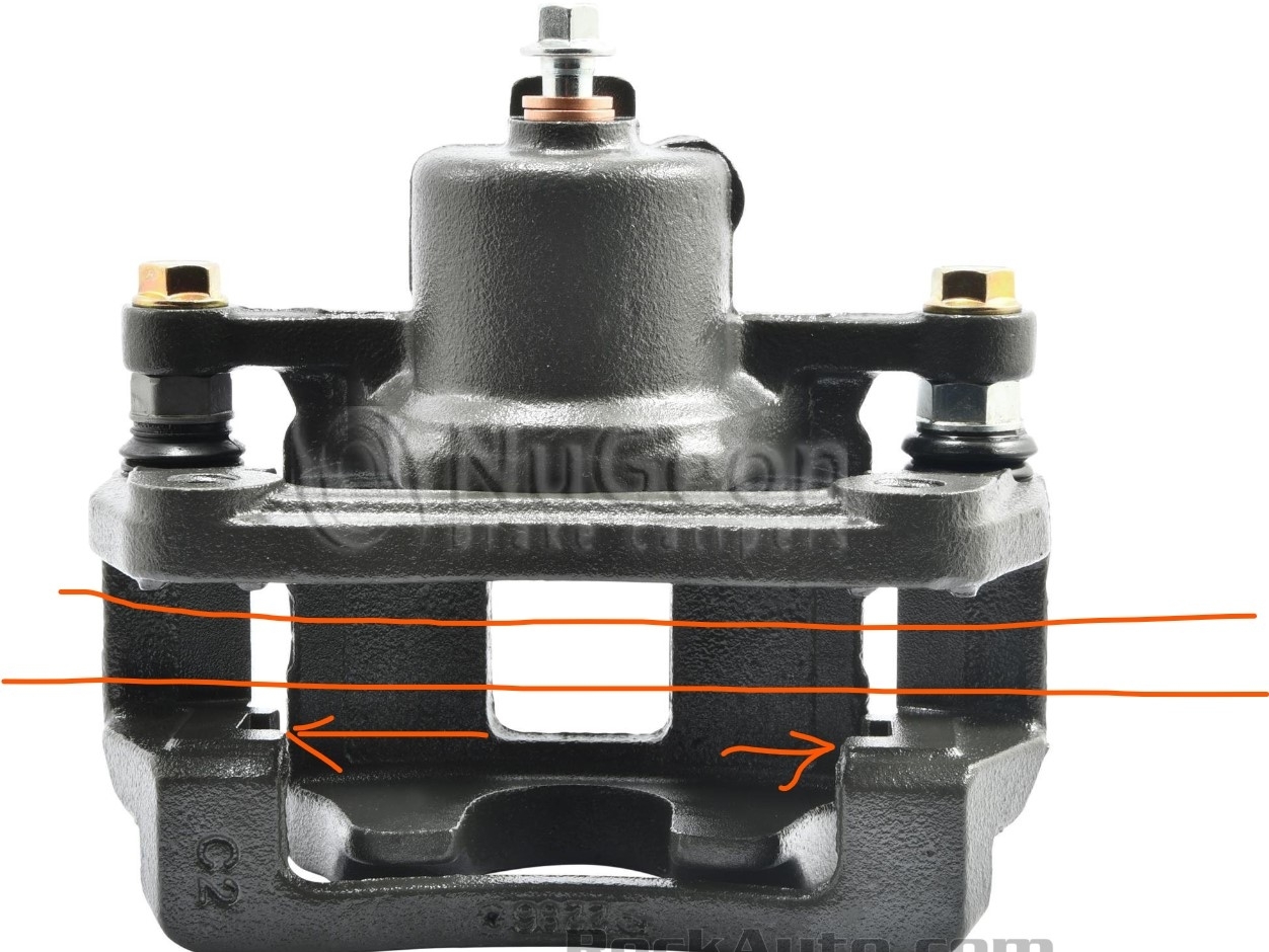

There are grooves, or notches, in the mounts the pads sit on that we slide those tabs into, then, once the caliper is installed, those pads are held captive, or in place. As the linings wear over many miles, those tabs gradually slide along the notches to stay in constant adjustment. The only way to get the pads to slide far enough to pop out of the notches is to remove the caliper, . . . or for the lining to rust off, giving the remaining metal backing plate extra room to slip out. Most designs don't offer enough room for a pad to fall out without removing the caliper, but on some models, it is possible.

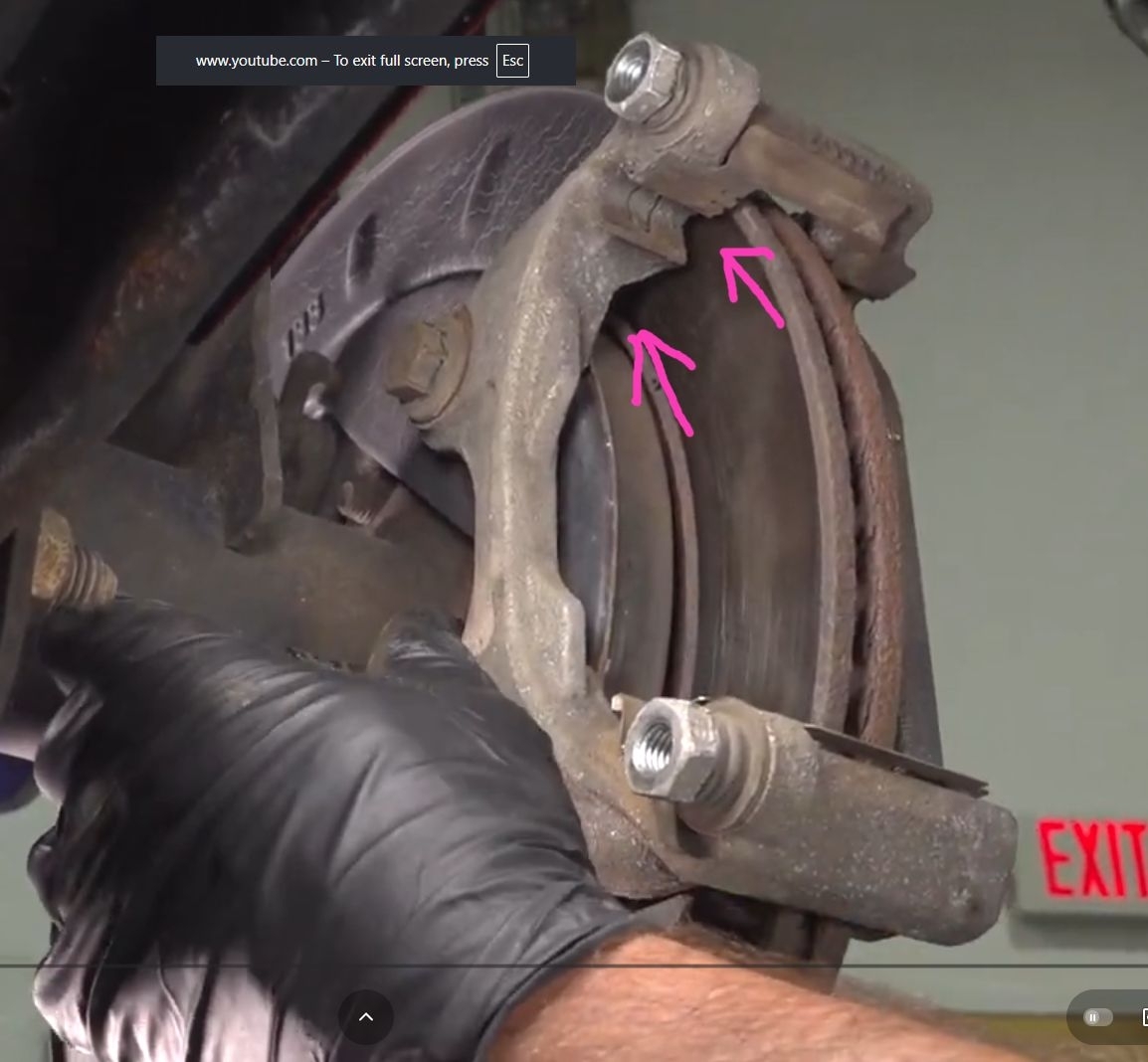

As Doc said, there are grooves that those set in, they are the ears you see on the earlier post. Those set in the notches where the arrows are (with another set on the upper side that you can't see). The rotor runs where the lines are drawn. The caliper itself can slide on the pins under the rubber boots at the top. Id does that to compensate for the wear on the brake pads. The calipers squeeze the rotor to stop your car. When the pads are in good shape the lining material is thick enough that between the rotor and that material the steel backer plates stay in the caliper and all is good. However in your case the pads wore out and now the thin backing plates can fit through the gap between the caliper and rotor. That was the bang you heard, the backer plate getting jammed through the opening. As to whether you get away with just pads and rotors will depend on which pad failed and if you drove it after the bang. The grinding you hear is the caliper grinding away metal on the rotor and the caliper. It is why the pedal went down and it doesn't stop like it should. Yes it does happen, especially more on rear brakes as they start out with a thinner rotor in the rear. The last two images show the rear brakes on a GM that are almost identical to yours. The first image with the orange outline is the piece you found. The arrows in the second image shows the gap that exists between the caliper mount and the rotor, that same gap is on both sides and is wide enough to let that backing plate slip through because once it gets to that point nothing is holding it in. I have seen them do a lot of damage when they come out that way, from breaking the caliper mount, damaging the caliper and one managed to wedge between the inside of the wheel and the axle and punched a hole through the wheel and bent the axle from the force applied. Hopefully yours didn't do that. Keep in mind though, if that part came out, there is now more room that the other backing plate could also come out. At that point there is enough room that the brake piston in the caliper can pop out and that creates an entirely new headache.
