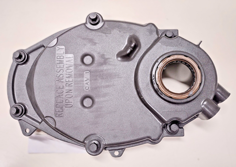

That does not look like the one I have. The one I have fits 1995 Blazer up to 2005. The timing chain cover is plastic.

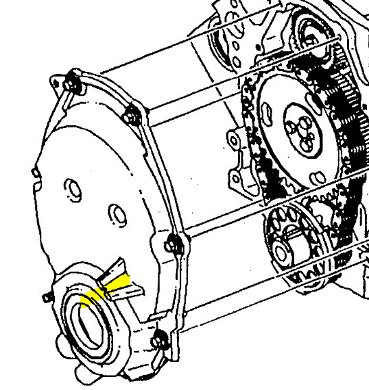

They likely used the pic I attached as an example. Take a look at the one I attached below. It is for the same engine. The picture is from the directions to replace the timing chain.
Let me know your thoughts.
See pic below.

Hi Joe,
Yes, that is a picture of the one I have and that's the TDC mark. But there is only one mark so why would the original dampener have two? Everything I have read says the one I have is the correct one, but I don't understand how it could be correct when the original one I replaced had two marks. I'm getting desperate here because I can't find the timing mark when it is running. I don't know what to do at this point. Thanks for your help.

I'm not sure why the OEM had two marks. That is odd. However, the new one's mark has to be the correct mark otherwise you would never be able to get it in time.
Have you tried taking a sharpie marker and highlighting the timing mark on the pulley? I always have to do that to see it.
