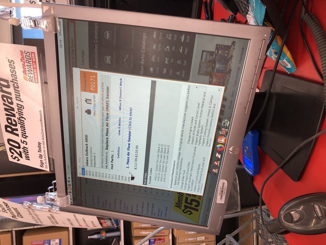

Hopefully the last time I ask on this thread, but I had my CEL ran and the only code that came up was a code for my Air flow sensor. I was told my air filter could need changing as-well. The rattling noise seems to have disappeared? But I haven’t driven on the highway so maybe it only appears after my car has been driven for longer or at faster speeds. Could that possibly mean anything for this problem or is this entirely separate?

Of course! Two codes actually, but both pointing to the mass air flow sensor, I checked my air filter this morning and it looks fairly clean still. I can try to get a look at my MAF sensor soon and get some cleaner just in case it’s dirty, I’ll check back soon
