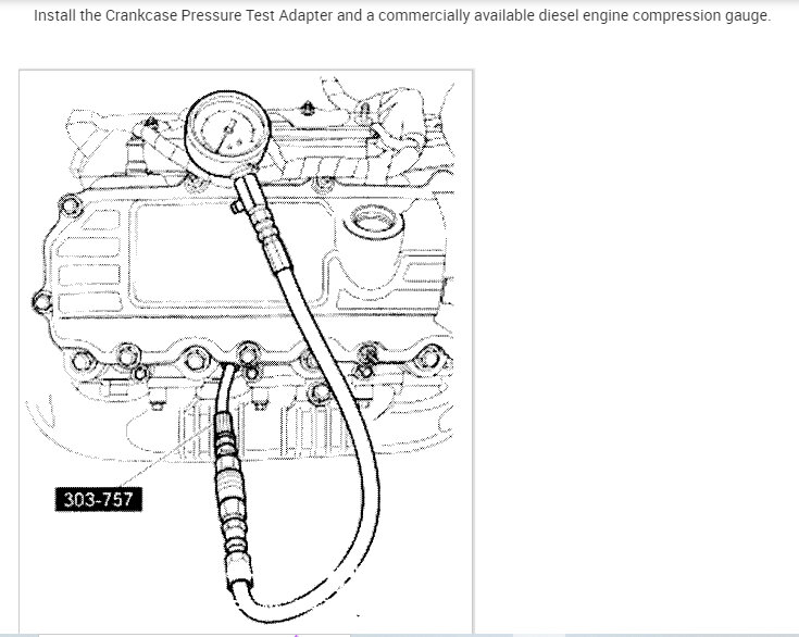

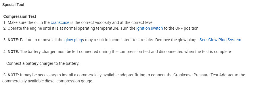

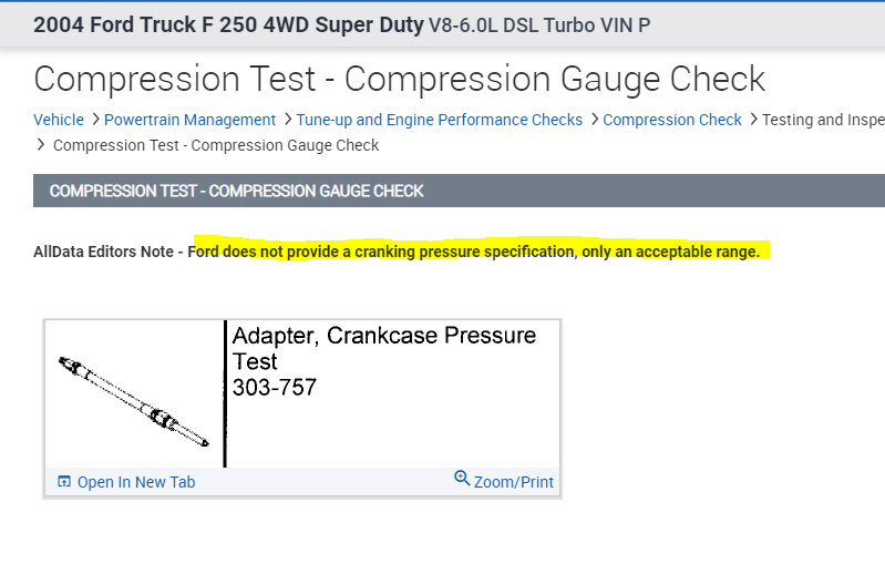

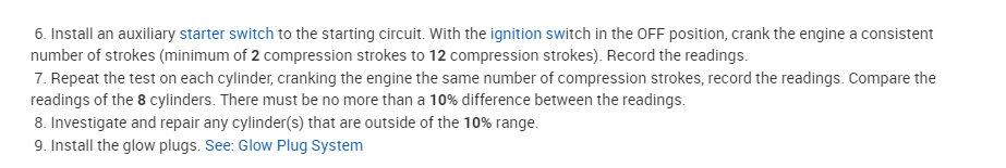

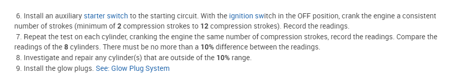

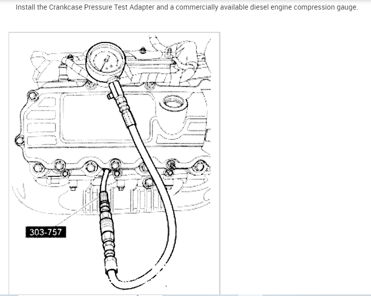

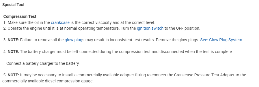

Are there any issues with the glow plugs? Also, the only other thing I can think of is if the engine compression is lower than it should be. Actually, these are things I would question:
Glow Plugs: Glow plugs are used to heat the combustion chamber and make it easier to start the engine. If one or more glow plugs are faulty, the engine may experience a delayed start.
Fuel system: If there is a problem with the fuel system, such as a clogged fuel filter or air in the fuel lines, the engine may have difficulty starting.
Battery: If the battery is weak or has a low charge, it may not provide enough power to start the engine.
Low compression: Low compression can be caused by a variety of issues, such as worn piston rings or damaged cylinder walls. This can make it difficult for the engine to start, especially when it's cold.
Cold weather: Diesel engines can be more difficult to start in cold weather, as the fuel is thicker and may not vaporize as easily.
Timing: If the timing is off, the engine may not start as quickly as it should.
Injector issues: If the injectors are dirty or not functioning properly, the engine may experience a delayed start.
I realize you have checked fuel pressure and it's good. Have you checked any of the other things I mentioned above? The next thing I would question is compression.
Here is a link that explains how it's done:
I attached the directions below specific to your truck.
Let me know your thoughts.

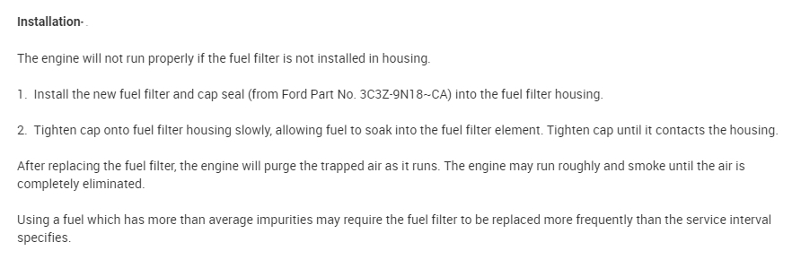

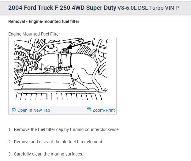

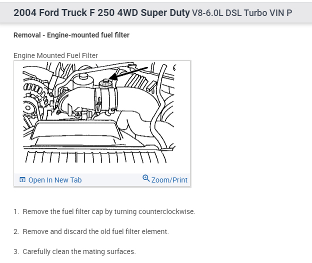

Also, do you have the diagram and info of disassembly of the fuel filter unit in the engine bay?
04 f250 6.0 power stroke
Greatly appreciate it!
Wednesday, March 1st, 2023 AT 4:18 AM
  • 110,194 POSTS
There are two filters. One is mounted on the frame rail and the other is under the hood/engine mounted.
If you look below, I attached what I have for replacement. Take a look through everything and let me know if it helps.
