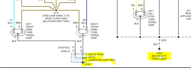

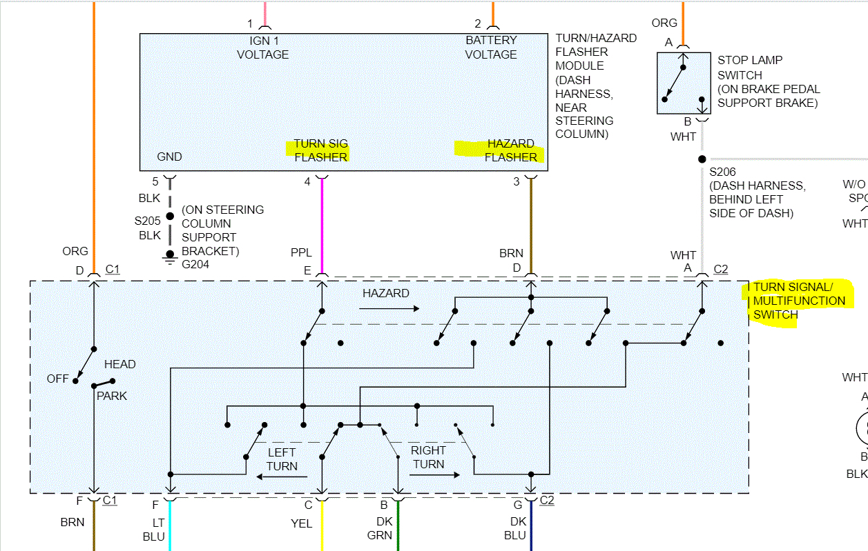

Sometimes without warning signal lights quit working. can turn flashers on and back off they start back working. park lights quit without warning turn flashers on and back off start working. now gas hand quit working and speedometer quit. park car went in store when got to car started up everything working again. what could be problem?

That is an interesting one. Since they start working after the hazards are turned on, it isn't a power supply issue (not a blown fuse).
I looked at the wiring schematics (and this doesn't pertain to the speedometer), and suspect the multi-function switch may be the problem. If you look at pic 1, power from both the signal flasher and hazard flasher go through the switch. I suspect something in the switch is failing.

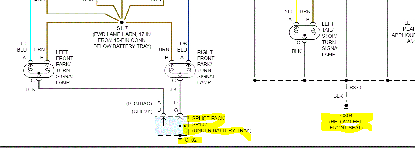

The only other thing would be if there is a faulty ground. There is a ground splice under the battery that can corrode and cause issues. I attached a pic below indicating locations of the grounds. Check them before replacing the switch, but I feel it's more likely a switch related issue.
