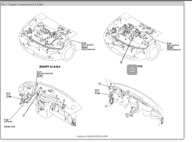

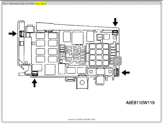

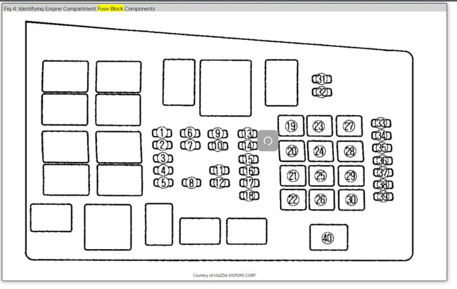

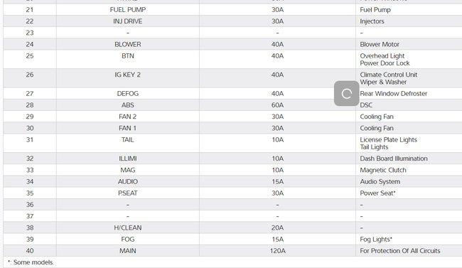

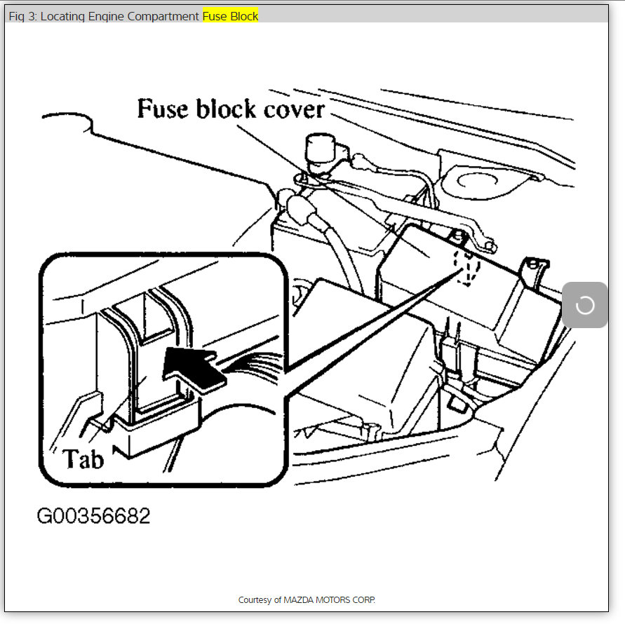

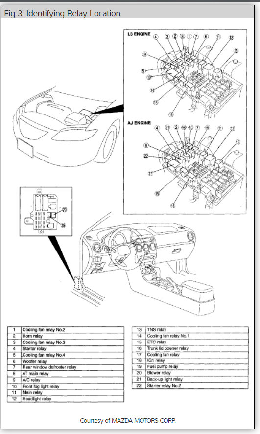

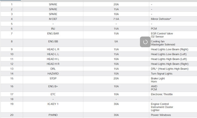

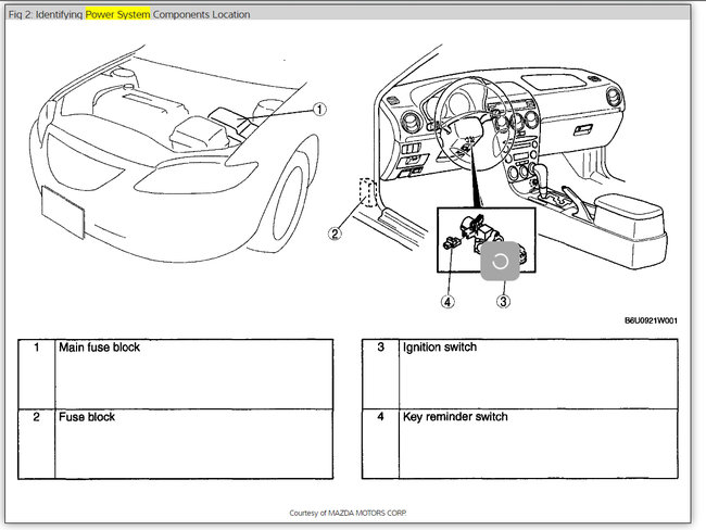

My turn signals and hazard lights will not come on. And it is not the bulb, but I do not know which fuse controls my turn signals.
+2
Thursday, June 18th, 2020 AT 1:31 PM (Merged)
KEN L
  • MASTER CERTIFIED MECHANIC
  • 55,512 POSTS
Lets get the problem fixed, the fuses are a great start. Here is a guide and some diagrams to help you check the fuses. Key on engine off.

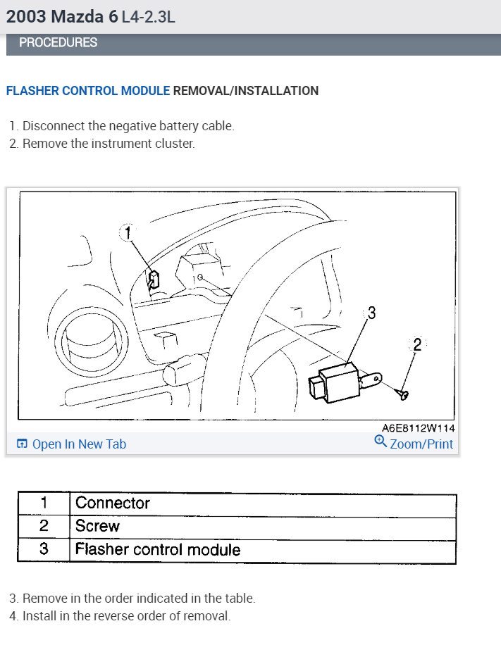

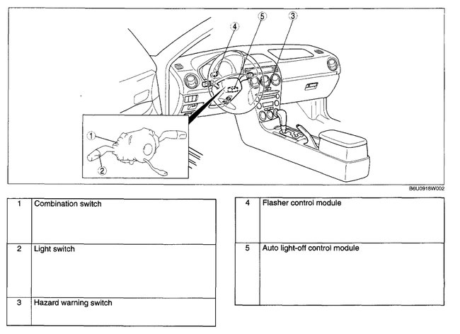

Hazard lights will turn on by themselves while driving or if the car is parked & not in operation.
I push the hazard light switch to try & stop it, sometimes it will stop, sometimes will not. A buzzing sound is heard while the hazard lights do it.
Have had the electrical system scanned, no problems showed.
Can anyone shed some light on this problem.
Other road uses are not impressed by this problem including the police.
I am an aged pensioner also disabled & cannot be without my vehicle.
Thursday, June 18th, 2020 AT 1:32 PM (Merged)
HMAC300
  • 48,601 POSTS
It sound like the flasher module has gone out which is behind the cluster here is a diagram to show you the location and how to change it out. Check out the diagrams (Below). Please let us know if you need anything else to get the problem fixed.
+5
TIMMCGRAW313
I had this problem it was the flasher got a new one for $34.00 all fixed
