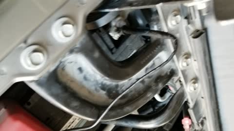

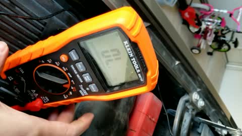

Sorry for the long video, I wanted to make sure I got everything in there, needing to get this fixed ASAP, so hoping you are able to help me with this with what I gave you.
Friday, November 15th, 2019 AT 8:55 AM
ADAM SACKLER
  • 45 POSTS
It would not let me attach the whole video in one, so I cut it into 4 videos, hoping this works for the upload so I dont have to make it choppy. This one is of the throttle body sensor.
Friday, November 15th, 2019 AT 9:39 AM
ADAM SACKLER
  • 45 POSTS

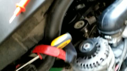

ECM test.
Friday, November 15th, 2019 AT 9:54 AM
ADAM SACKLER
  • 45 POSTS
Second test on throttle body sensor after plugging ECM back in.
Friday, November 15th, 2019 AT 10:12 AM
ADAM SACKLER
  • 45 POSTS

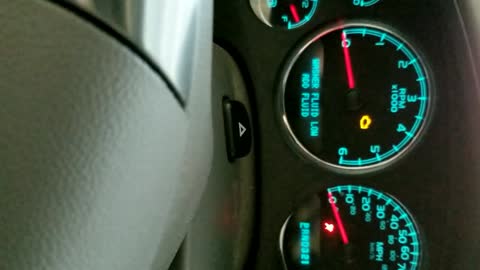

How car acts after I plug everything back in.
Friday, November 15th, 2019 AT 10:29 AM
ADAM SACKLER
  • 45 POSTS

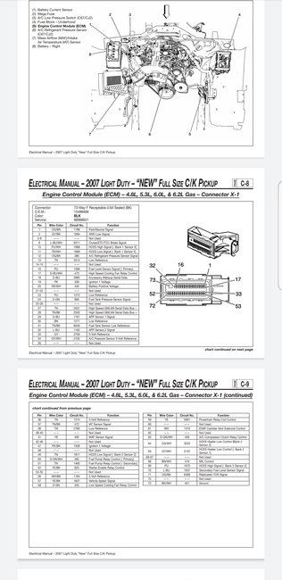

Okay, so after finally finding a gm diagram I see that the terminals I tested on the video for the ECM were incorrect, but testing the correct terminals yielded the same results as seen on the videos, all resistance readings were OL. Terminal 3 reference depending on how the paperclip was positioned and I was able to use 2 hands and hold it down, it would either jump up to 0.3-0.5 volts and go to 0 V or it would jump to around 0.1 V and hold at 0.02-0.03 V. Terminal 2 reference would jump to around 0.05-0.1 V and go to 0 V, would not hold at any voltage. Also on the one of me starting my car, I realized I had forgotten to re-plug the air intake sensor, so now it is starting fine and stabilitrak/traction control warnings are gone but check engine light is still on.
Friday, November 15th, 2019 AT 5:08 PM
ADAM SACKLER
  • 45 POSTS

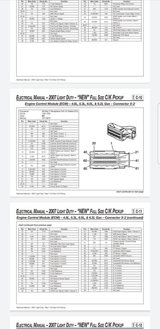

Sorry for the back to back, I should have looked at the diagrams more thoroughly before going out and testing again, it looks like you gave me the terminals for an 80-way ECM harness and I have a 73-way harness which I do not see even has a TP sensor signal terminal on it.I've attached the diagrams but I'm sure you know what I'm talking about, either way something is up and I'm hoping I gave you enough information. I am needing to get this fixed this weekend, so I'm hoping this works out.
Friday, November 15th, 2019 AT 5:24 PM
ADAM SACKLER
  • 45 POSTS
Sorry, one more message, after finding out the correct 5 V references I went out again to check, I was able to get the wire cover off this time, terminals 33 and 34 would not register with just the prong, but with the paper clip would jump less than 0.1 V and go back to 0 V wouldn't hold, terminals 36 and 56 would jump to around 0.06 V with just the prong and hold and 0.03-0.04 V and with a paper clip would jump to 0.1-0.2 V and would hold at 0.03-0.04 V.

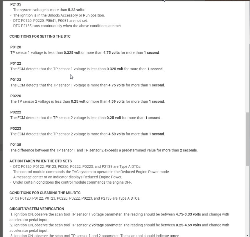

The voltage jumping up and going back to 0 like that is due to the probe moving and it creating its own voltage. Once it settles down and goes to 0 that is your reading. So all of those appear normal because the sensor was not plugged in.
At this point we need to go back to the P2135 and use a scan tool. Does your tool read data or is it just a code reader?
We need monitor what the sensors are telling the PCM when everything is hooked up and the only real way to do this is to monitor the PCM data.

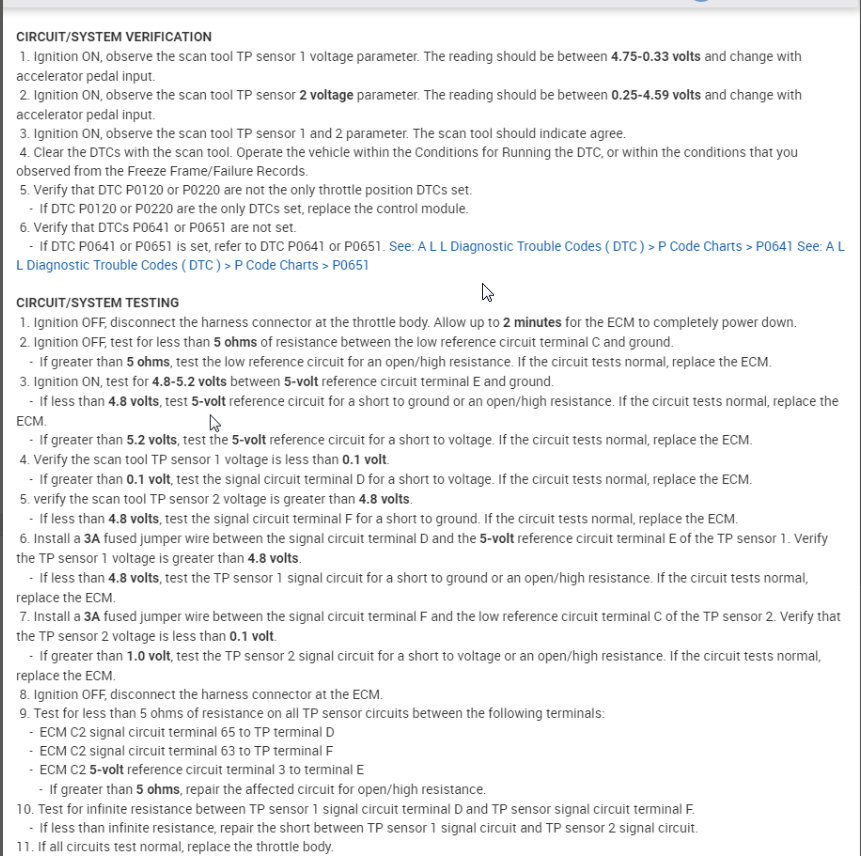

Here is the testing that we need to stick too.
FYI - when you ohm out a wire you want to be on the wire by itself and unhooked at both ends. You do not ohm out wiring that is connected to voltage because that won't show you anything. Basically you are testing the integrity of the wire only. You can "practice" this by taking a 12 inch piece of wire and touch your black lead to one end of the wire and the red lead of your meter to the other end and you should have less than.5 ohms. This is ohming out a wire.

Was that not the testing procedure I was following by having it grounded? As I said before also, I have a 73-way ECM connector, and from the gm diagram I sent you, there is no TP sensor wire in the ecm connector, that is in the 80-way connector, terminals 63 and 65 on mine are different.

Correct. Resistance readings are wire end to wire end. You were checking for shorts to ground. It is a good test but just not a resistance test. If you are checking for a short to ground that means your wire is touching ground when it should not. Basically only ground wires should be touching ground. If any others have resistance to ground then they are shorted.
As for testing the 5 volt reference you would do it just like you are however, that is not your issue. Your issue is that the throttle position sensors are not reading within spec. So that means we need to monitor it with a scan tool because they need to be plugged in.
I hate to tell people this but I think we need a shop to look at it because I don't have a way to tell you to properly test this from here. You have proven out the wiring so we need the scan tool to see what is out of whack.

Oh I see. The video I watched he tested the resistance with it grounded to the battery, so I thought that's what I was needing to do, but makes sense now since the only resistance reading I was getting was on the ground lol. But where would I even check the resistance on the throttle sensor since my ecm harness doesnt have tps sensor wires on it?

As for your wiring diagram that doesn't show a TPS in the PCM, that doesn't seem possible because the PCM would have no way of reading it which would prove the sensor pointless.

Oh ok, I was just looking at those GM diagrams that I attached on the previous comment and I didnt see any tps sensor ports in the 73-way harness like there is with the 80-way, so I was just confused by that.

Yeah. I can't explain why it is not listed. I can only imagine they call it something different on that list.
