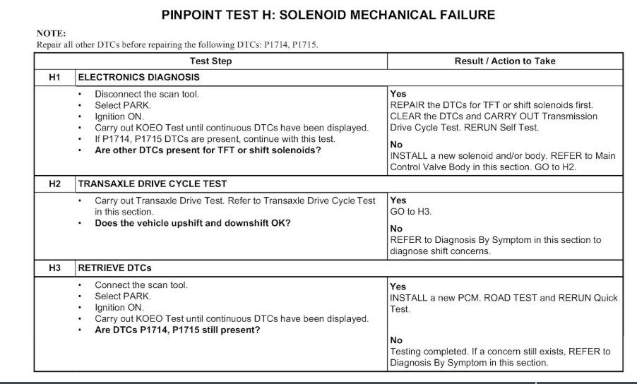

Yes, the torque converter, speed sensor solenoid, transmission control solenoid, and The position speed sensor has all been replaced. When I was able to drive it to the part store, I believe the code was 1715 however since all those parts have been changed out. I do not know what codes are popping up now.
Wednesday, March 20th, 2019 AT 4:38 PM
MECHANIC
52,796 POSTS
Okay, question.
Why did you not replace the clutches and steels inside the transmission when you had it out of the car?

Okay, you stated two times you replaced the torque converter. That is internal in the transmission.
I assume you mean the solenoid.
Did you change the oil/filter in the transmission?
