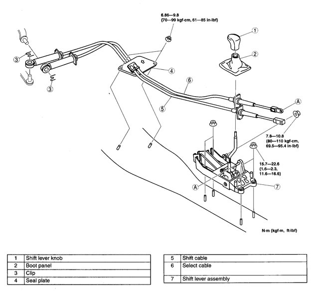

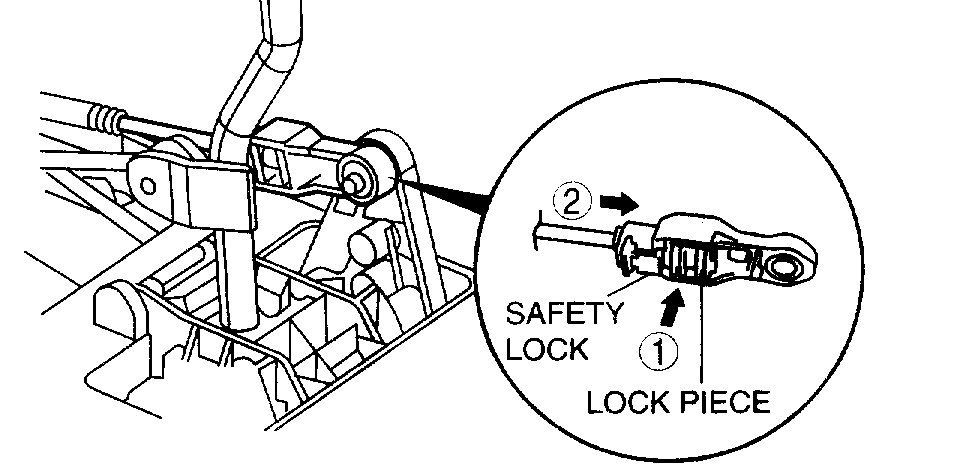

Hello, I have five speed manual transmission. I was driving from work on the freeway one day in stop and go traffic. I shifted into neutral and the shifter suddenly became loose and once I pulled over on the shoulder the shifter was stuck completely. It will only move up and down. I think it's stuck on third or fourth gear because I have to step on the clutch in order for it to move and to load it onto the tow truck. I have gotten advice to check the gear cables on the gearbox side and in the interior, but unsure of what I should be looking for. Transmission oil is full. Thanks in advance for help.

Hi and welcome to 2CaroPros.

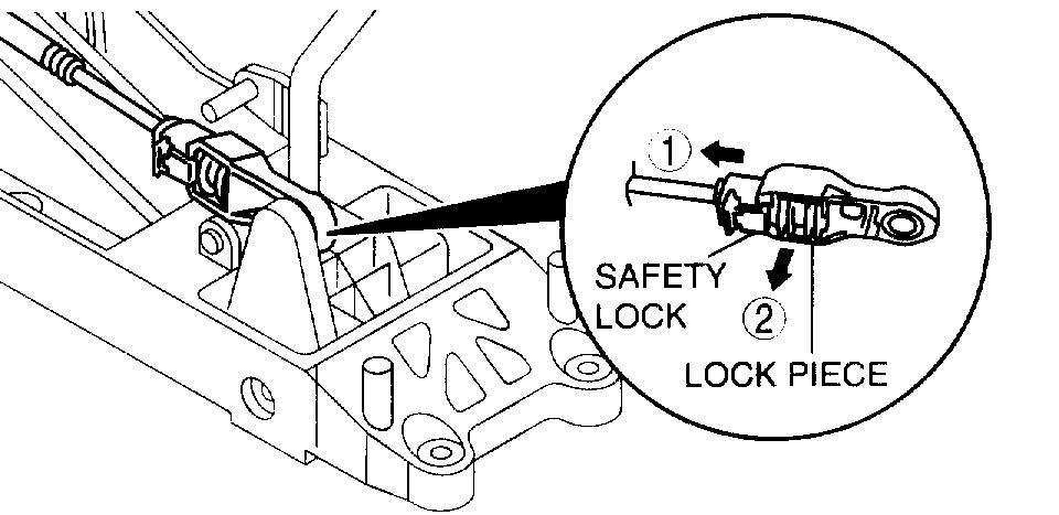

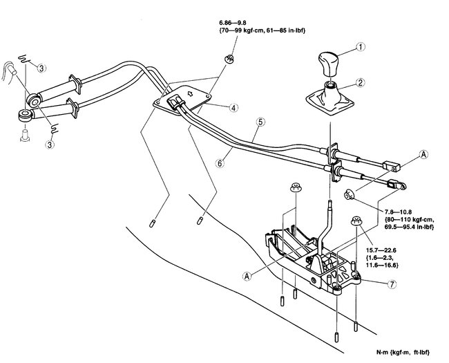

The shift linkage consist of two cables. Either one has broken or come off. I am going to provide all the pictures related to removal and installation. Follow the directions and check where the problem occurred. There are two possible manual transmissions and the linkage is very similar. I have attached both. The attached pictures correlate with these directions.
________________________________________________
SHIFT MECHANISM REMOVAL/INSTALLATION
Picture 1
1. Remove the battery and battery tray.
2. Remove the air cleaner component.
3. Remove the dashboard completely.
4. Remove the SAS control module.
5. Remove the climate control unit.
6. Remove the rear heat duct.
7. Remove in the order indicated in the table.
8. Install in the reverse order of removal.
9. After installation, verify that the shift [ever can be shifted smoothly into each position.
Picture 2
G35M-R manual transaxle models
Picture 3
A65M-R manual transaxle models

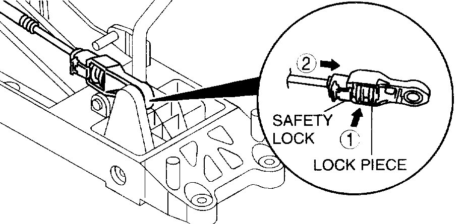

Select Cable Installation Note
1. Remove the center console.
2. Make sure that the shift lever (transaxle side) is in neutral.
3. Unlock the lock piece of the select cable (shift lever side) in the order shown in the figure.
Picture 4

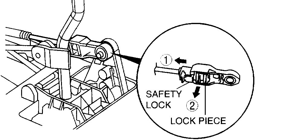

Picture 5
4. Shift the shift lever to neutral.
5. Lock the lock piece of the selector cable (shift cable side) in the order shown in the figure.
Picture 6
Picture 7
6. Install the center console.
7. Shift the shift lever from neutral to other position, and make sure that there are no other components in that area to interfere with the lever.

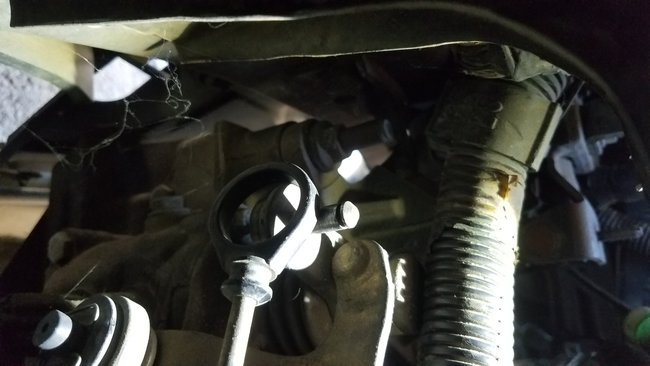

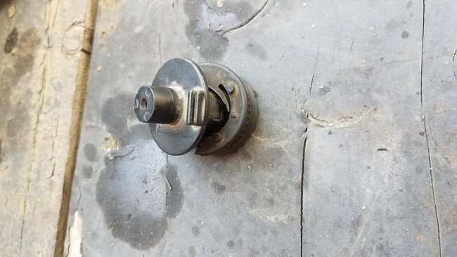

I found the culprit. The bushing was completely broken and the cable was out of place. Any idea what the part number is to the bushing?
Apr 7, 2019 at 2:37 PM
  • CAR REPAIR CONTRIBUTOR
  • 110,193 POSTS
Welcome back.
I'm glad you found the problem. As far as the part number, what I suggest is to take it to a parts store. There is usually a help section in the stores that has all kinds of bushings related to linkages for shifters, wipers and so on. You may end up having to by a kit specific to your vehicle.
I attached a picture. Is that where the bushing came from, the end of the cable? If you can't find a bushing and that is where it came from, you may end up needing to replace the entire cable.
Apr 7, 2019 at 4:35 PM
JDMARTIN15
  • 42 POSTS
Thank you,
I have the spring break layoff to work on the car; and yes that's an accurate picture, it's the bushing at the top from the end of the cable. As you can see the bottom end is connected precisely.
Apr 7, 2019 at 4:42 PM
  • 110,193 POSTS
That's it. Try to see if you can get a bushing from the local parts store that will work. If not, have them pull up a picture of the cable to see if the bushing is included. That may end up your only option.

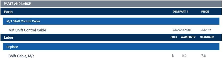

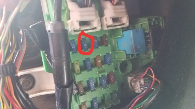

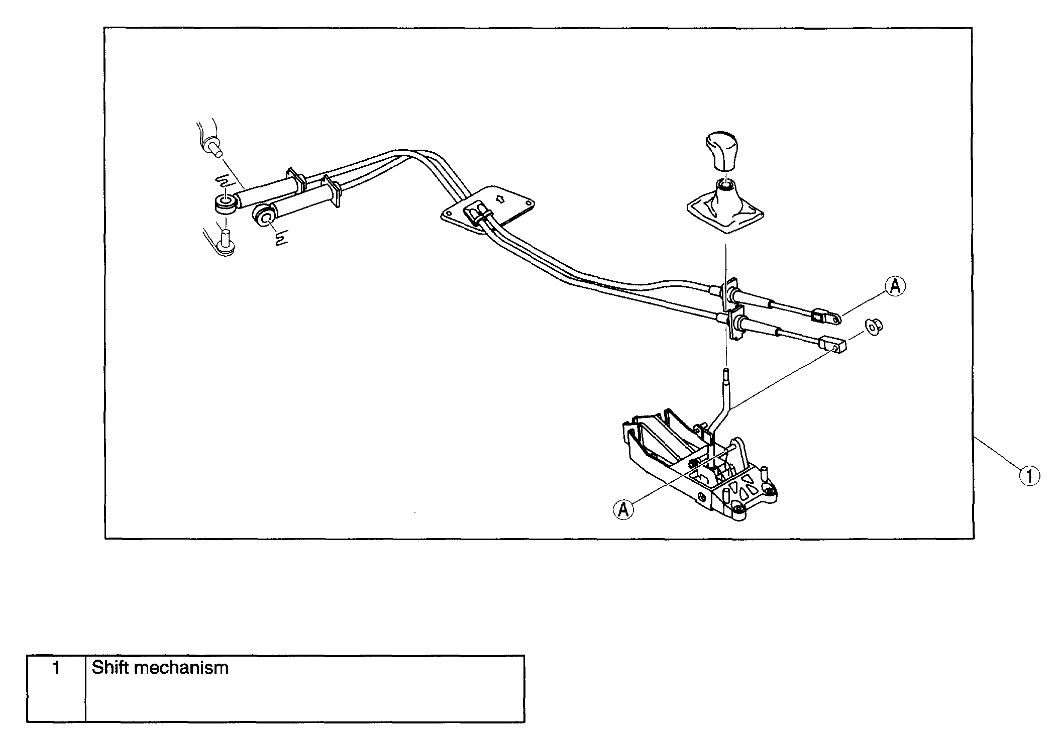

I did look up the shift cable parts and labor information. Wow! It calls for a lot of time to replace. However, the part number is listed. See Picture 1. You are not going to want to see the price. I did a google search looking for Mazda part number GK2C46500L and found the entire assembly, but also found what I attached in picture 2. Does that look like it would work for you?
Apr 7, 2019 at 5:06 PM
JDMARTIN15
  • 42 POSTS
I know, I have looked up a new set of shifter cables just for preparation in case the issue was the cables and is beyond my budget especially for a bushing. The second picture looks very promising, and I have looked up and found a video on YouTube a company that manufactures bushings for shift cables. It's www.bushingfix.com. I have gone to a car parts and looked some bushings. None look similar in fit.

Update on the fix: so I got incredibly lucky. I checked at multiple auto parts stores regarding the bushing for the shift cables. I was discouraged, but felt the need to check inventory on nearby junkyards. Luckily, in a city just fifteen miles away I found a junkyard with a 2004 Mazda 6 3.0L manual that was available the day before, so I got up the next day early went to the junkyard and managed to find a bushing in perfect condition. One of them was broken. I fit the bushing in and the car is alive again. I do have another issue involving the reverse lamps. I switched the reverse light switch and bulbs. I'm wondering if maybe the fact that the previous owner's switched out the touchscreen double din system it had before and inserting the factory stereo had anything to with it because they basically just inserted everything back in without wiring anything back.

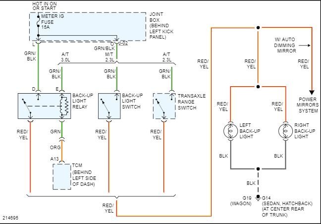

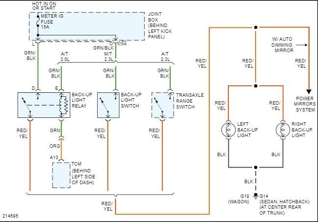

Welcome back and I'm glad you got the linkage taken care of. Now, the reverse lights system is really simple on this vehicle when it has a manual trans. Power is supplied all the time via fuse 15 joint panel behind the left kick panel. From there, power goes to the switch and then to the lights. I have attached a schematic of the back up lamps system. Don't get confused. The schematic also includes the wiring for an automatic. It dies indicate AT and MT so you can follow it.
Listen, I am attaching it as one picture. If it is too small to read, let me know and I'll break it into two. Also, I would suggest checking to see if there is power to the lights themselves. There is a common ground for both lights that could be an issue. If there is power, then the ground would be my first suspect.
Take care and let me know if you get it fixed or need help with anything.

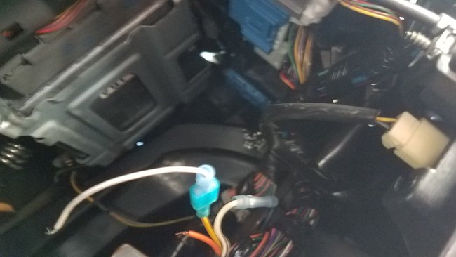

I've just had some extra time recently after excruciating mid terms and got started on this fix. Electrical problems are the absolute worst for me. I decided to jump on all issues electrical related on my car. I've had it for about 8 or so months now. The reverse lamps never worked and the audio display hasn't either, although the previous owner really just unwired everything while removing the double din touchscreen it had on before. A new issue appeared and now the signal and hazards lights don't work. It has always worked up until now. The car has been sitting on "non op" for about 4-5 months and I have switched the headlights for some HID lights my brother bought me. Don't know if that has anything to do with it. I know the hazards and signal lights are powered by the BCM, but I will attach some pictures of the harness for the left reverse lamp at the trunk and miscellaneous pics of loose wires at the left kick panel and under the steering wheel cover. My issues are: the reverse lights, signal lights and the audio display are not operating. The radio wasn't working when I bought the car out of an auction, but it was just unwired. I connected the grounds and got at least the radio working, except you can't see the stations because the display is out. The car is a salvaged title and it does need the brake and light inspection, which is why these fixes are important, but on the bright side, the car mechanically is running great and no codes. Regarding the reverse lights, I checked the fuses and were fine, checked for power via test light on the red/yellow wire while car on and on reverse and no power. I tested the taillights first just to make sure the test light was fine. When I got the car, I replaced the reverse light sensor. I don't know what else to test for and as for the signal lights. I checked the bulbs and fuses all fine. I haven't the slightest clue on why they're not working. Appreciate any help and excuse my inexperience lol. I'm an electrical noob.
