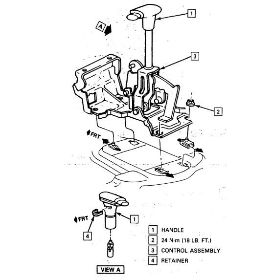

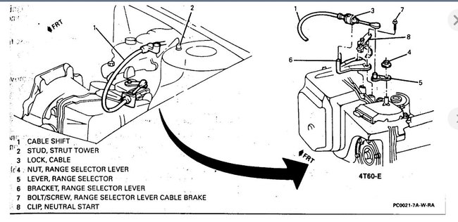

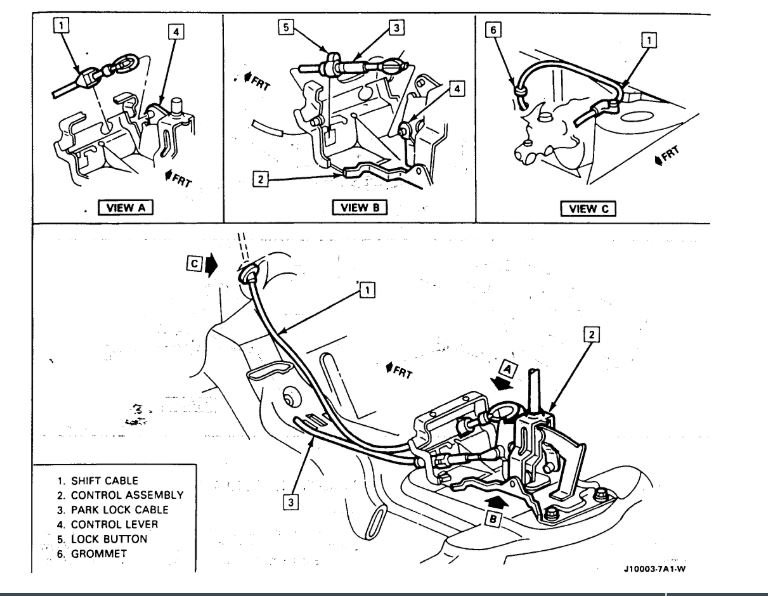

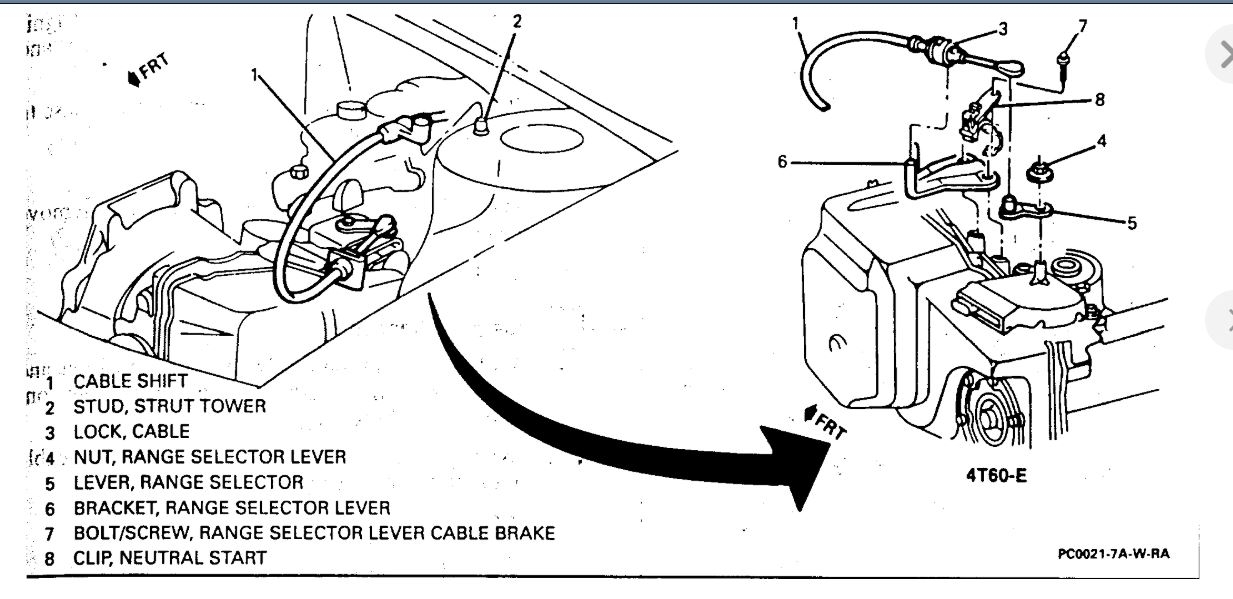

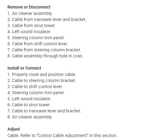

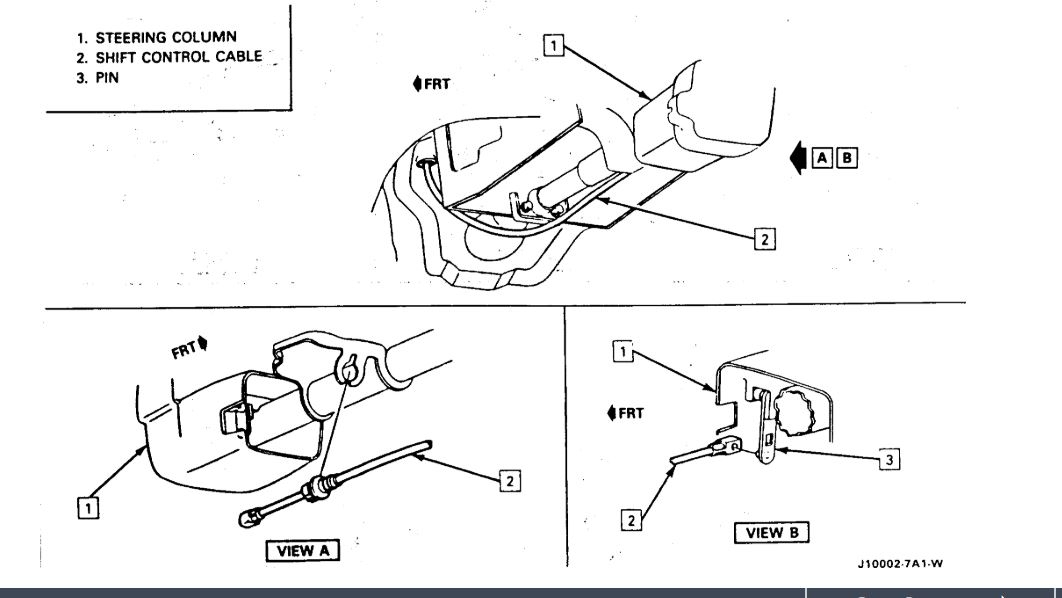

Good afternoon,
Why did you replace the cable? Did you have this issue prior to replacing the cable?
