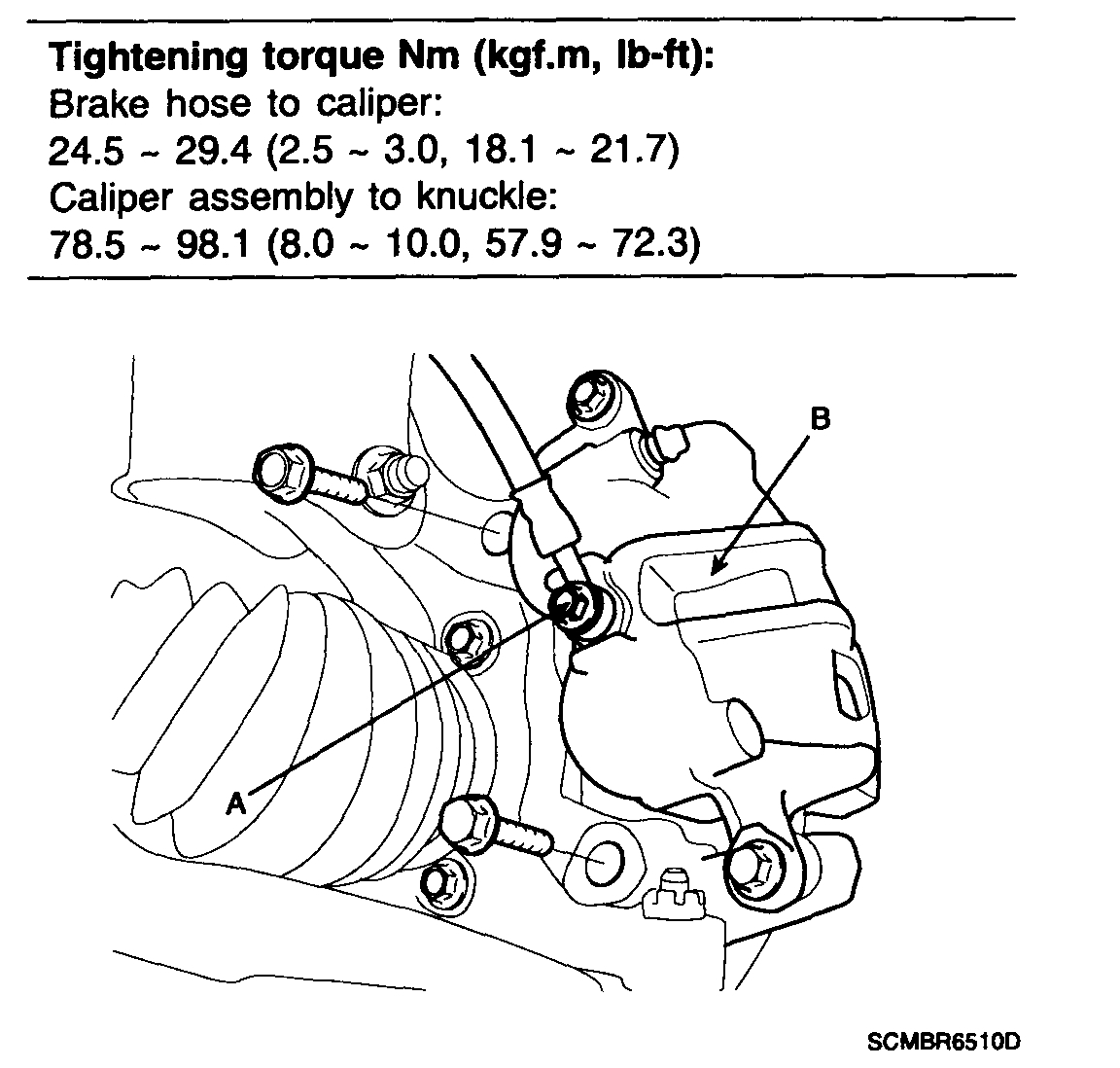

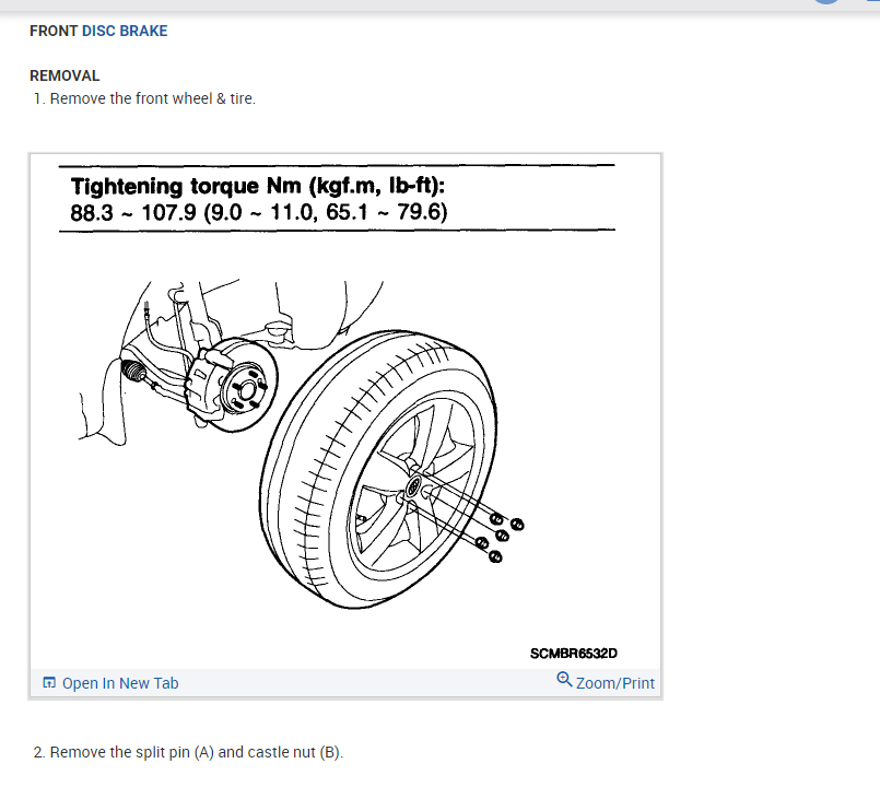

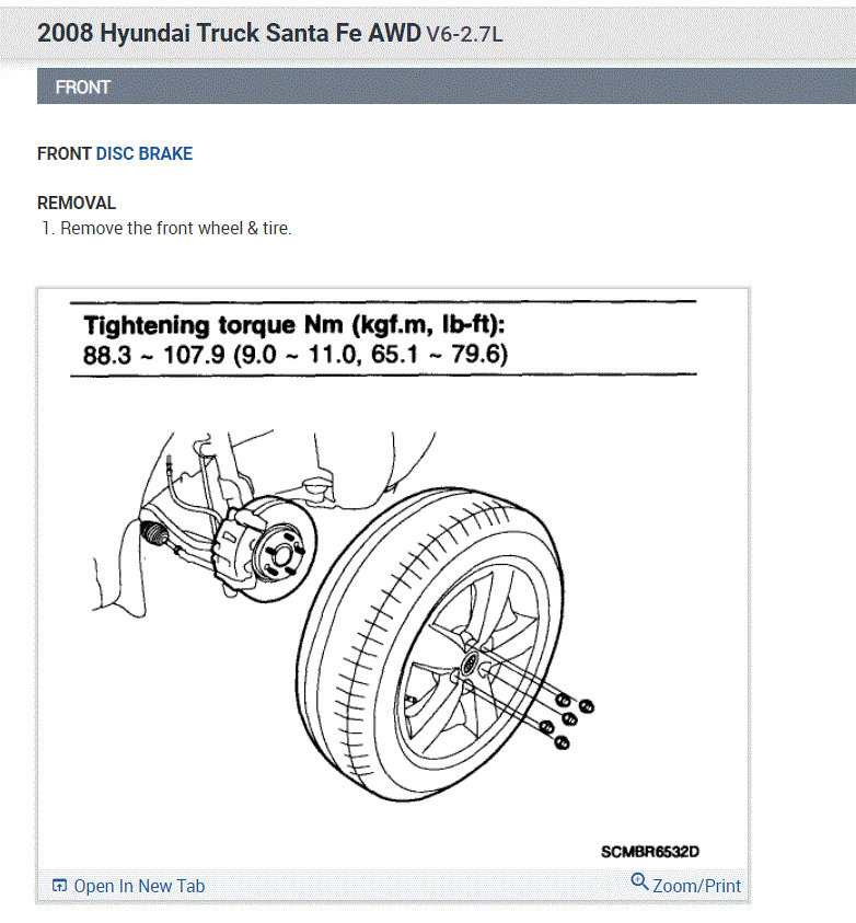

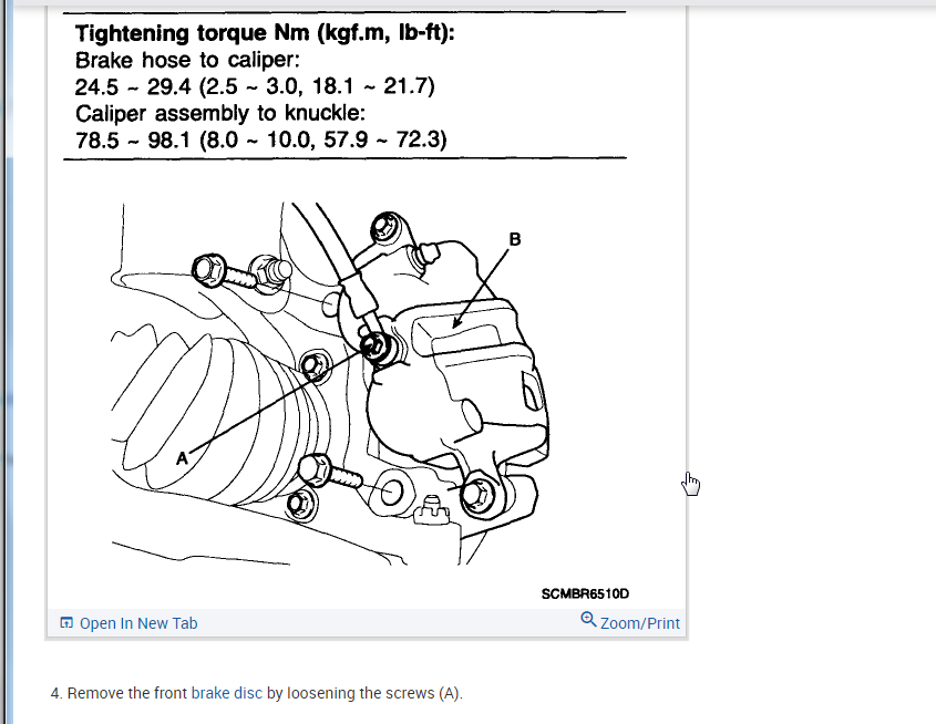

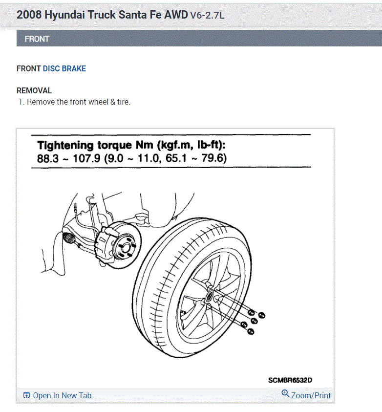

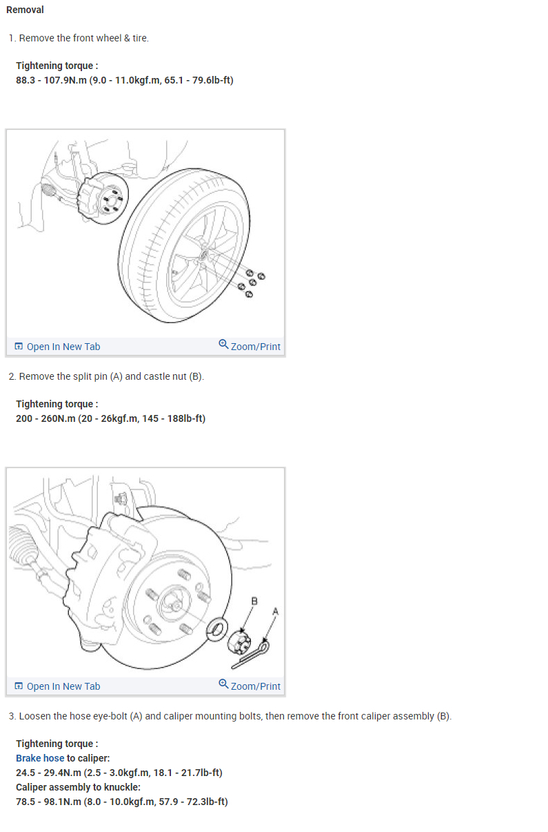

FRONT DISC BRAKE

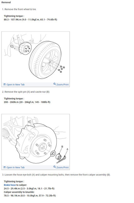

REMOVAL

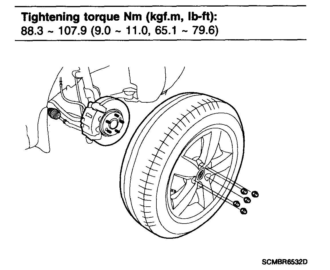

1. Remove the front wheel & tire.

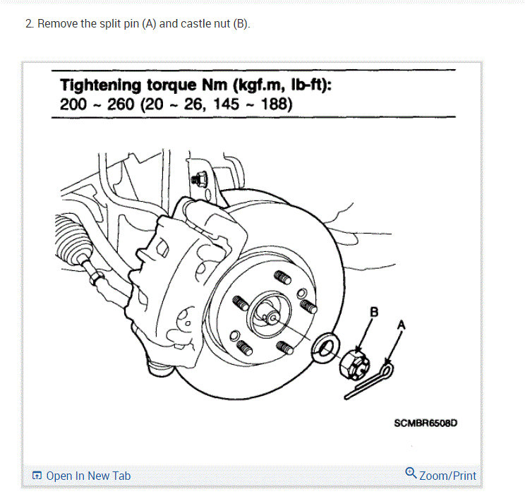

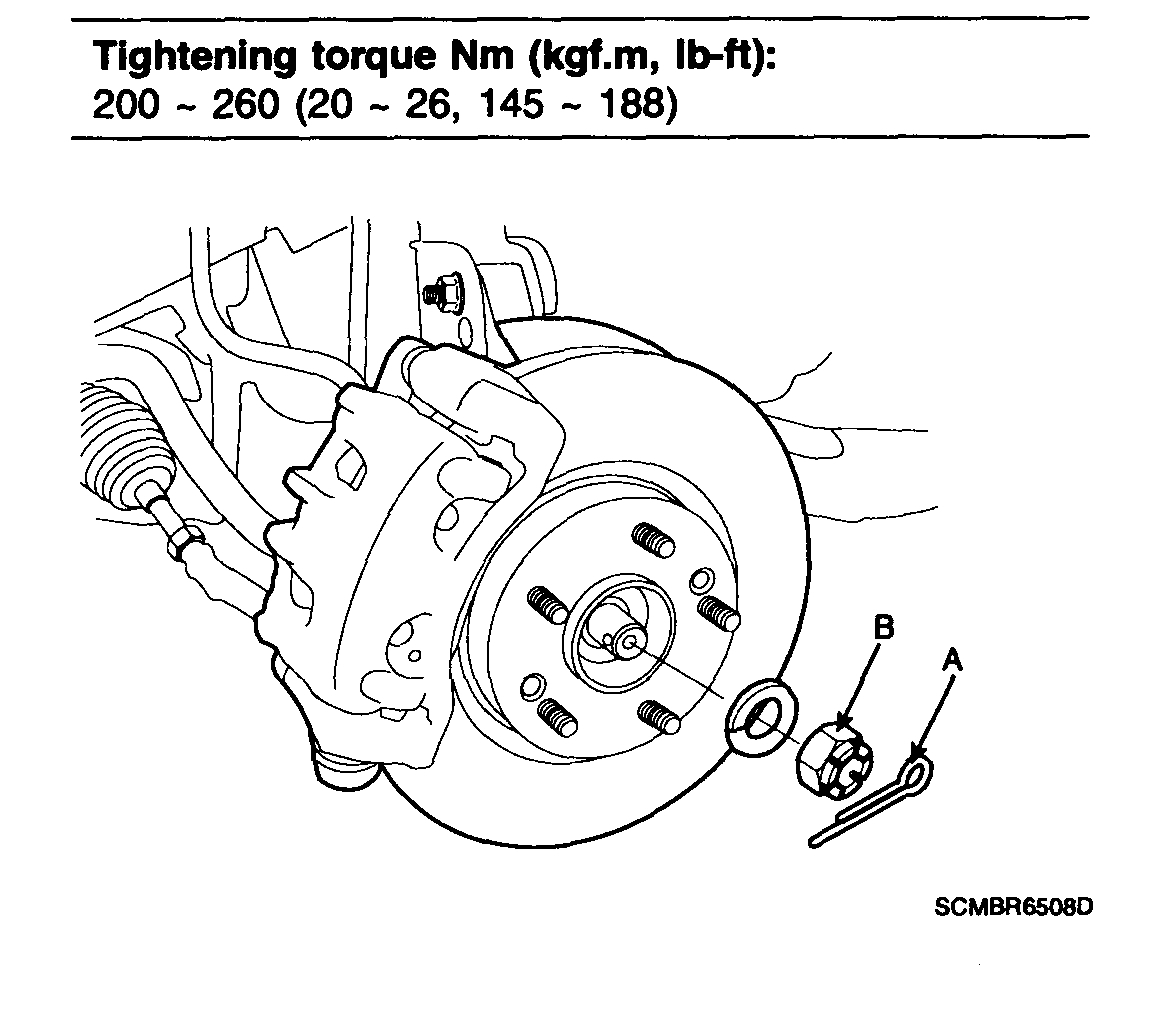

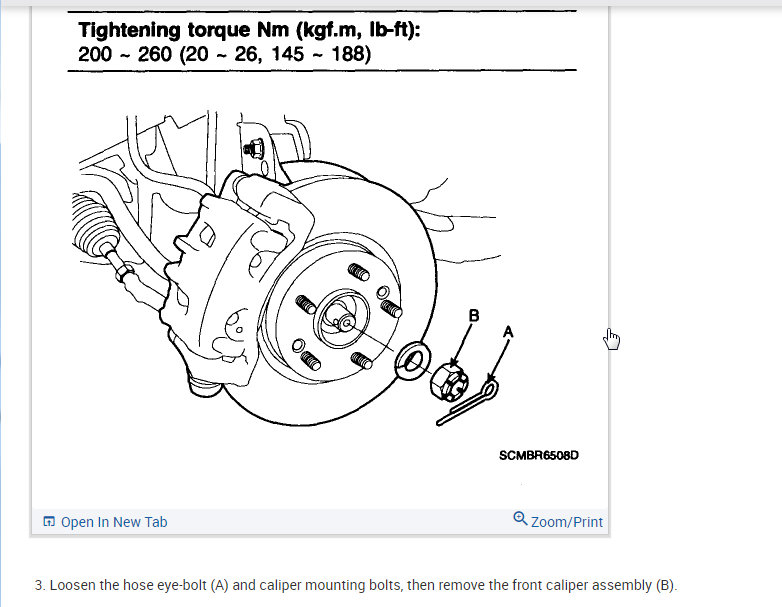

2. Remove the split pin (A) and castle nut (B).

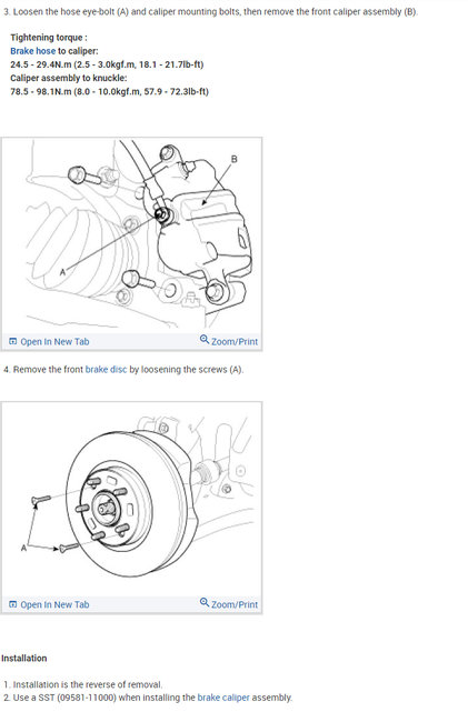

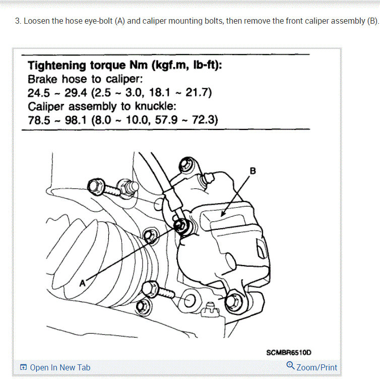

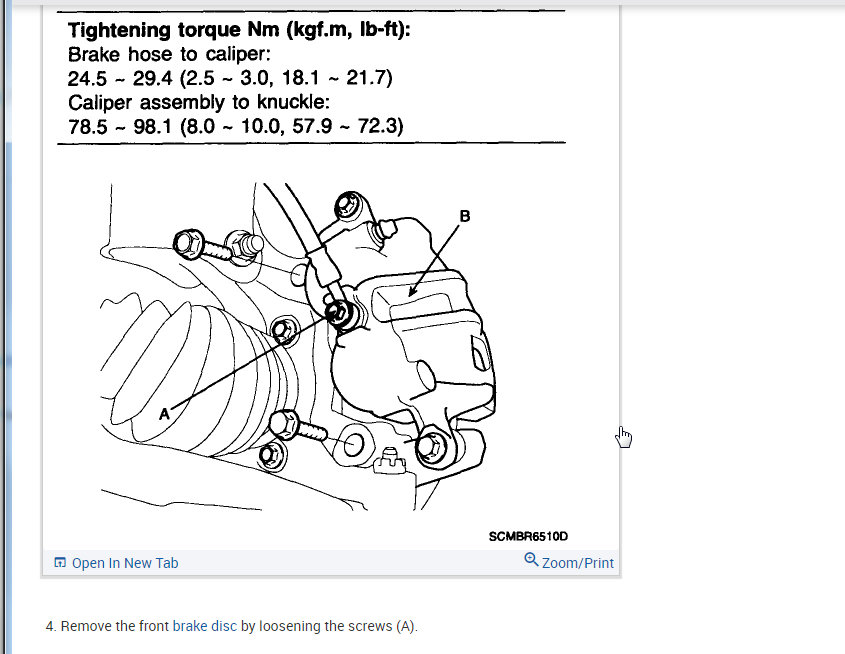

3. Loosen the hose eye-bolt (A) and caliper mounting bolts, then remove the front caliper assembly (B).

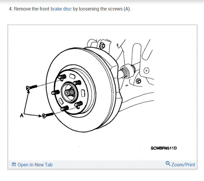

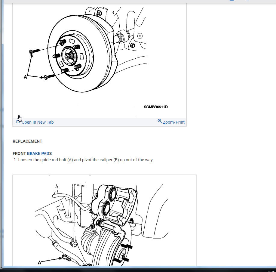

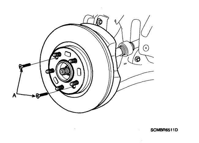

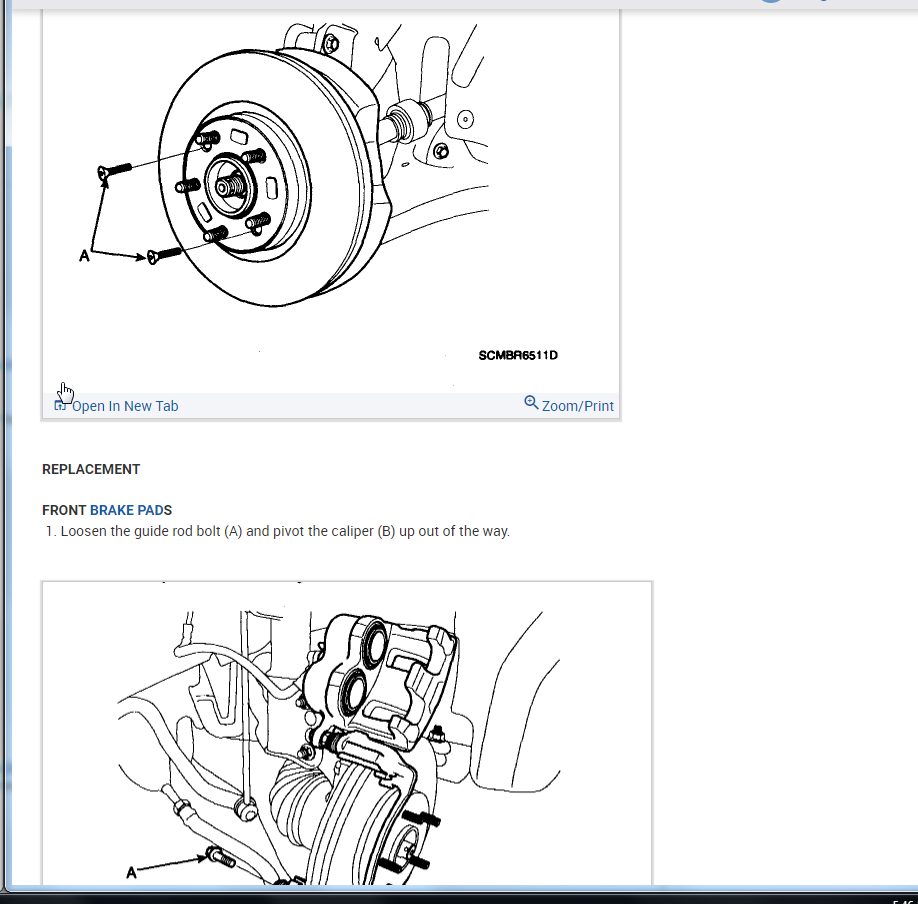

4. Remove the front brake disc by loosening the screws (A).
REPLACEMENT

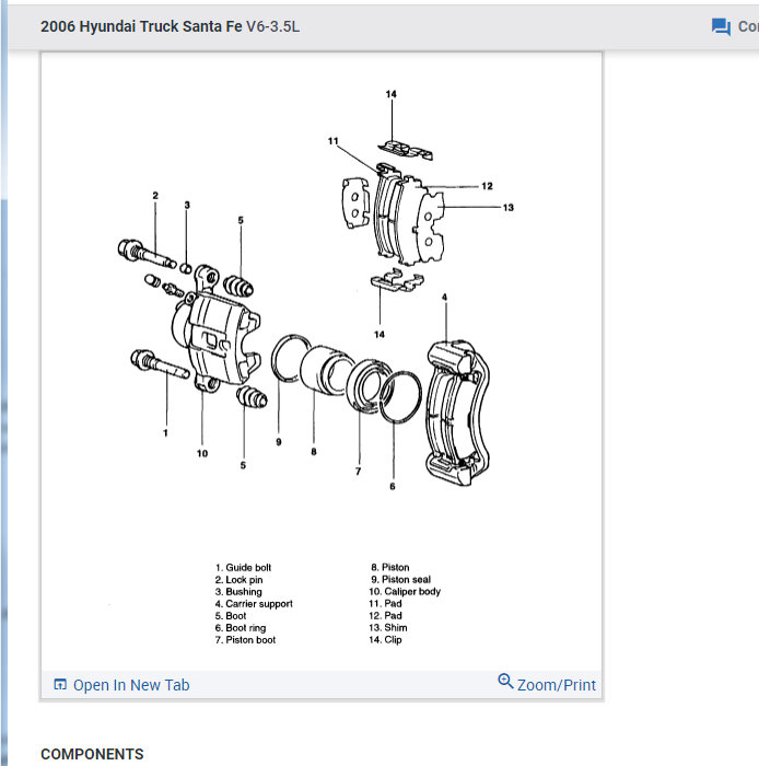

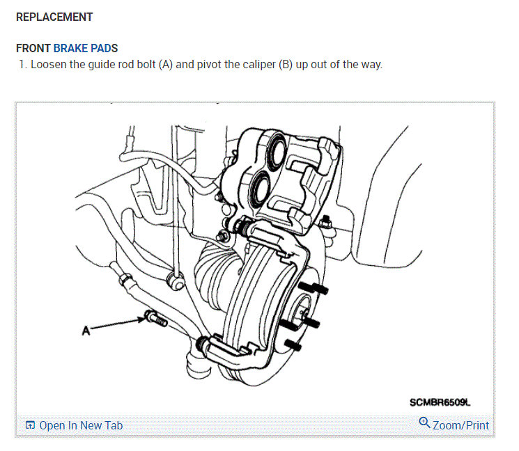

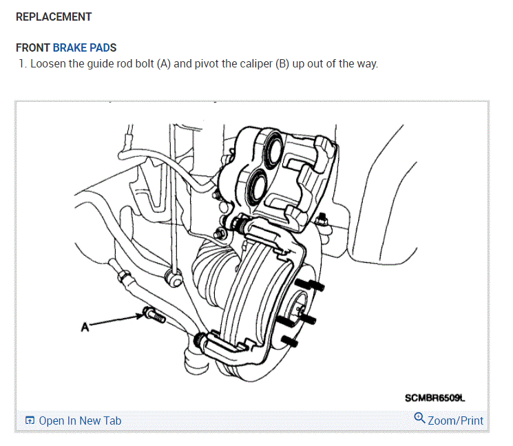

FRONT BRAKE PADS

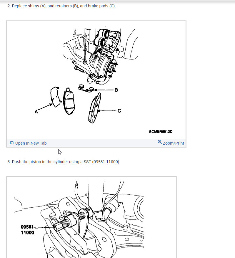

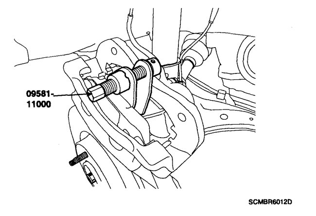

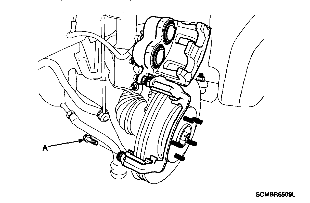

1. Loosen the guide rod bolt (A) and pivot the caliper (B) up out of the way.

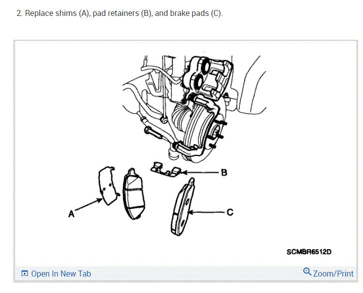

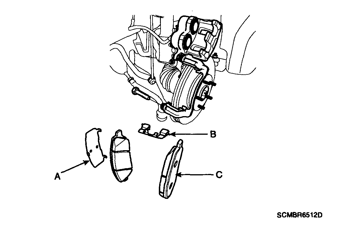

2. Replace shims (A), pad retainers (B), and brake pads (C).

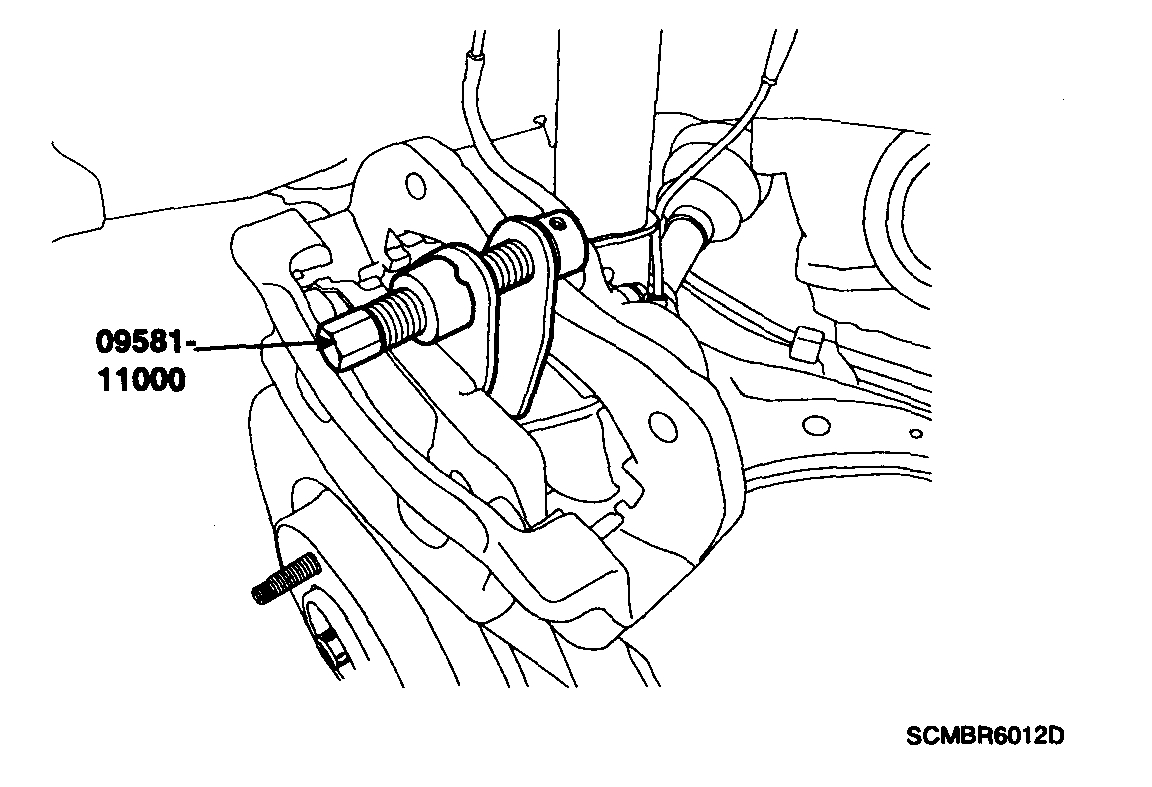

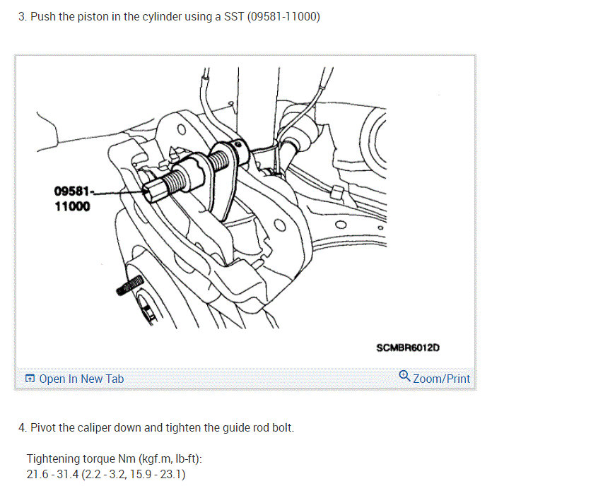

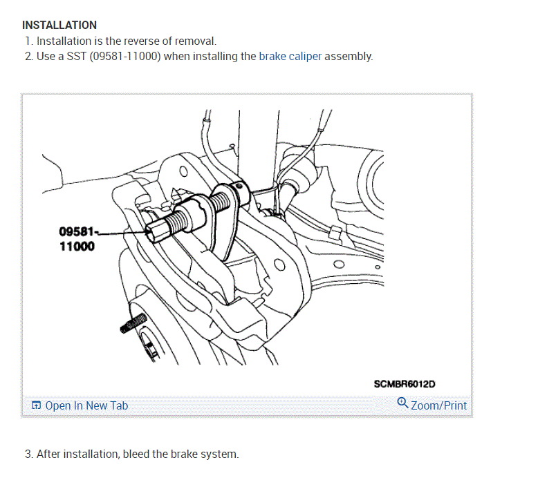

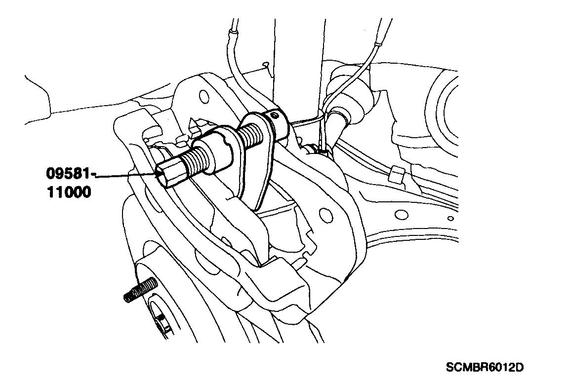

3. Push the piston in the cylinder using a SST (09581-11000)
4. Pivot the caliper down and tighten the guide rod bolt.
Tightening torque Nm (kgf.m, lb-ft):
21.6 - 31.4 (2.2 - 3.2, 15.9 - 23.1)

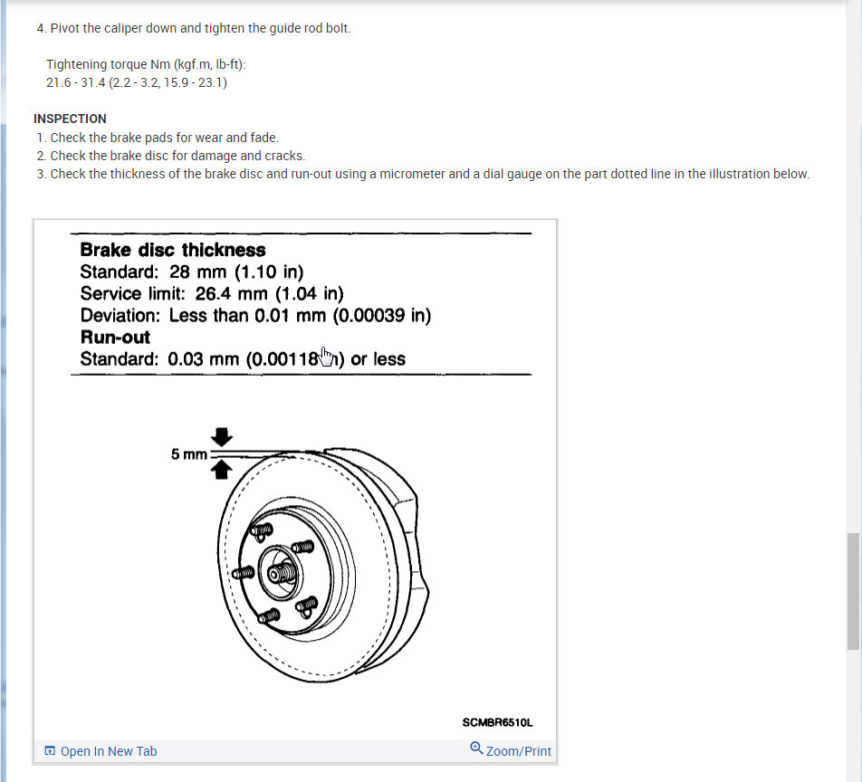

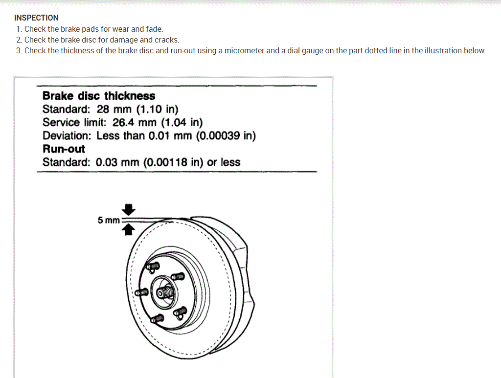

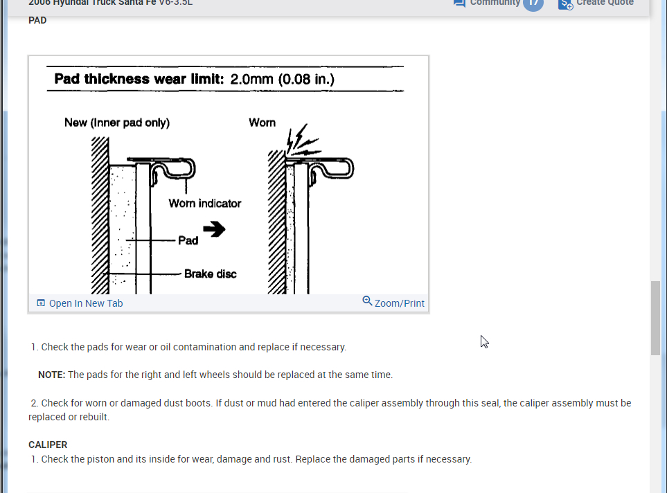

INSPECTION

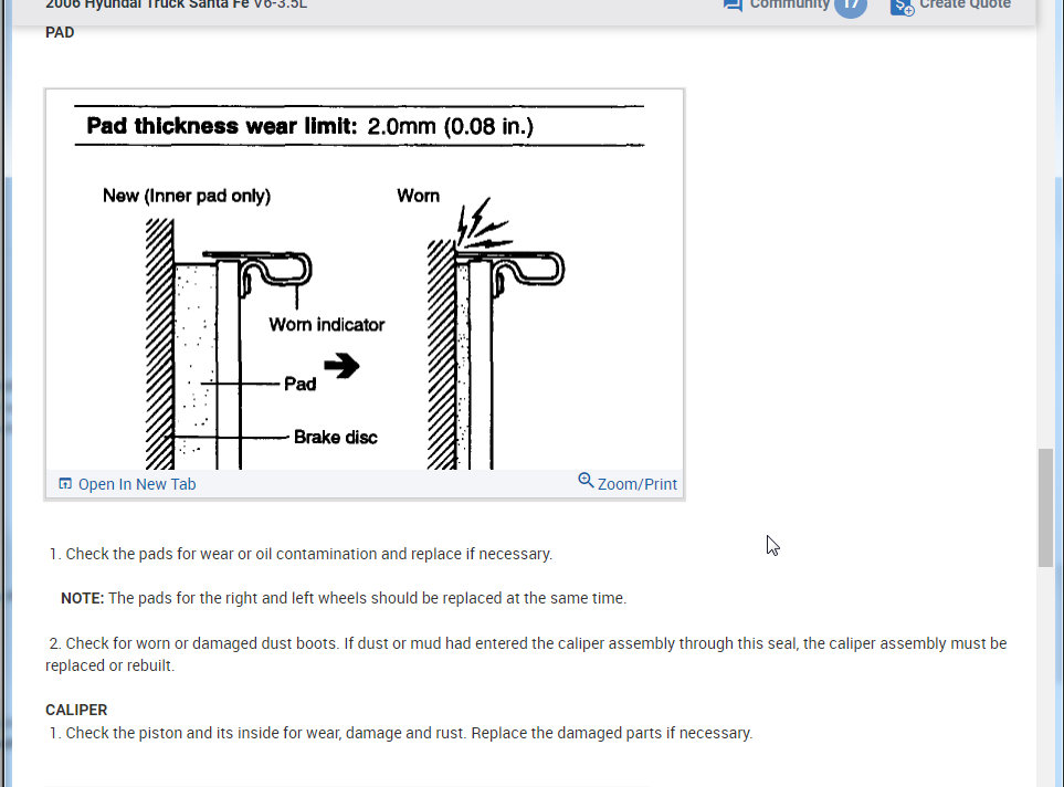

1. Check the brake pads for wear and fade.
2. Check the brake disc for damage and cracks.

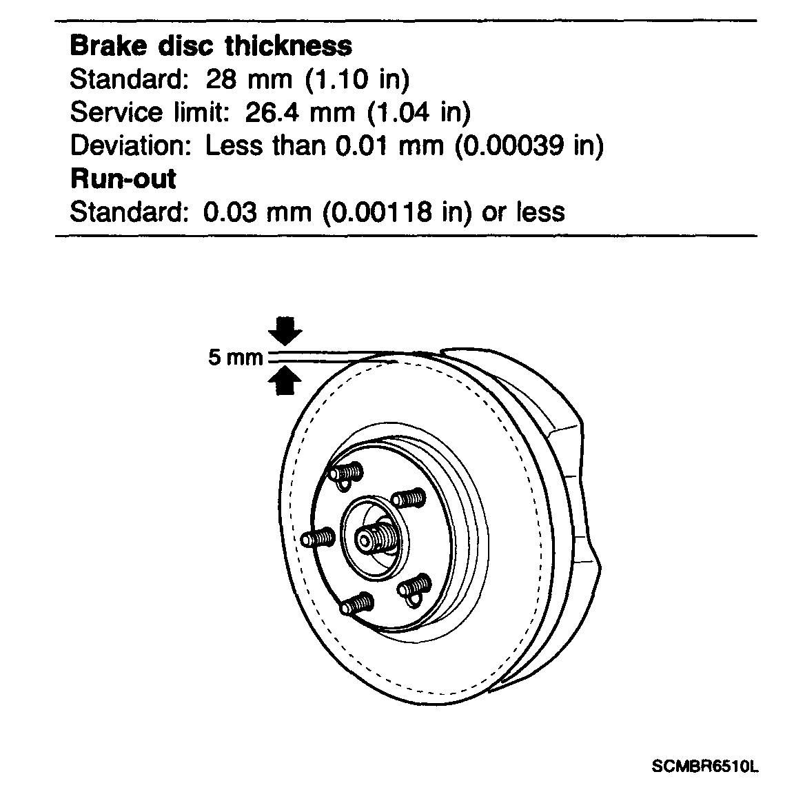

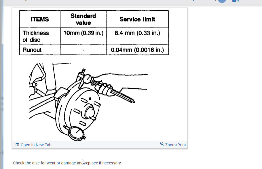

3. Check the thickness of the brake disc and run-out using a micrometer and a dial gauge on the part dotted line in the illustration below.

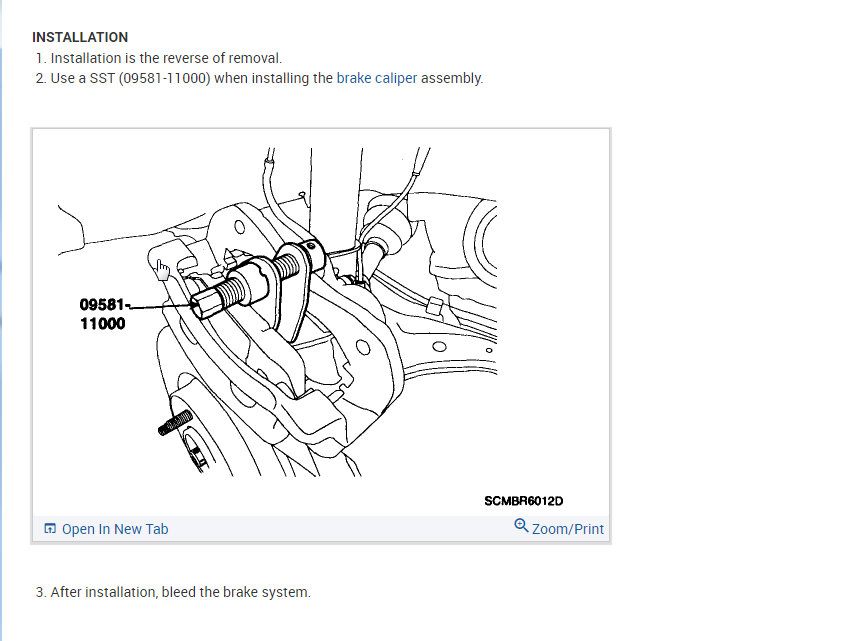

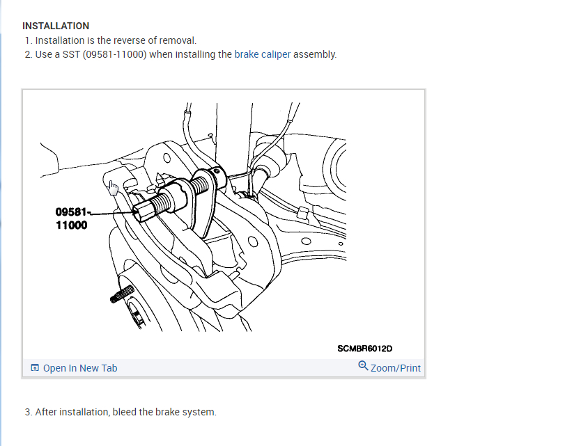

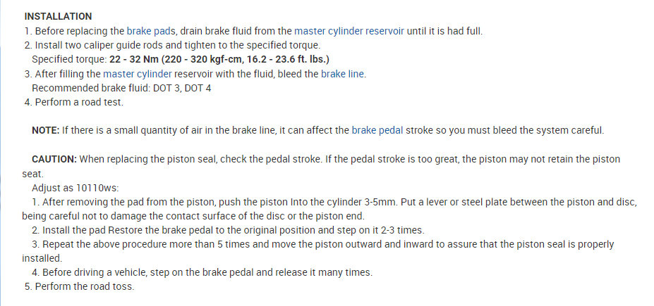

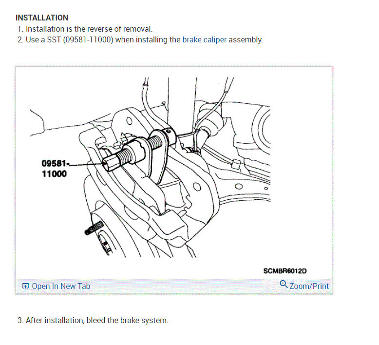

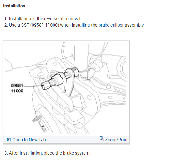

INSTALLATION

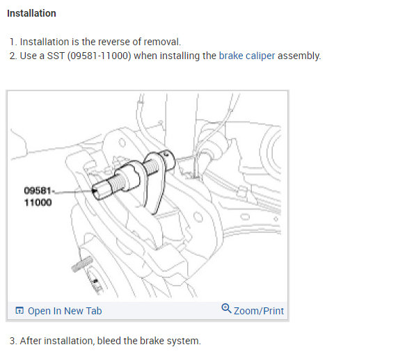

1. Installation is the reverse of removal.
2. Use a SST (09581-11000) when installing the brake caliper assembly.
3. After installation, bleed the brake system.
Check out the diagrams (Below). Let us know what happens and please upload pictures or videos of the problem.

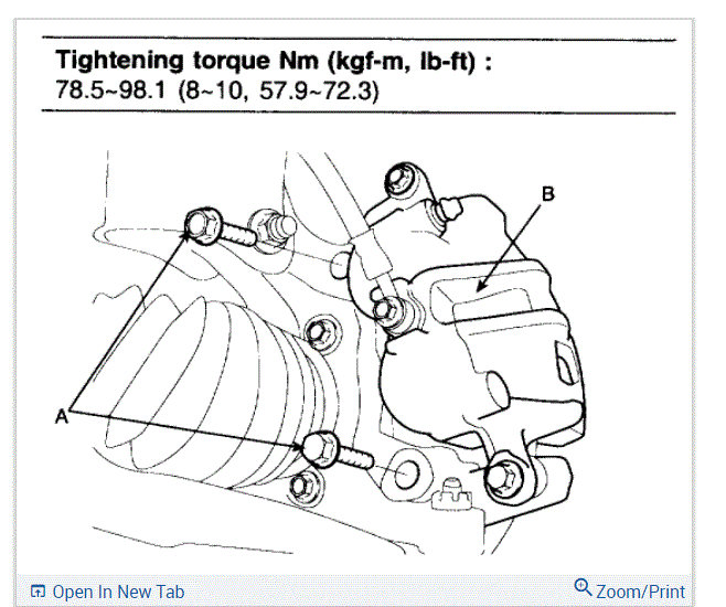

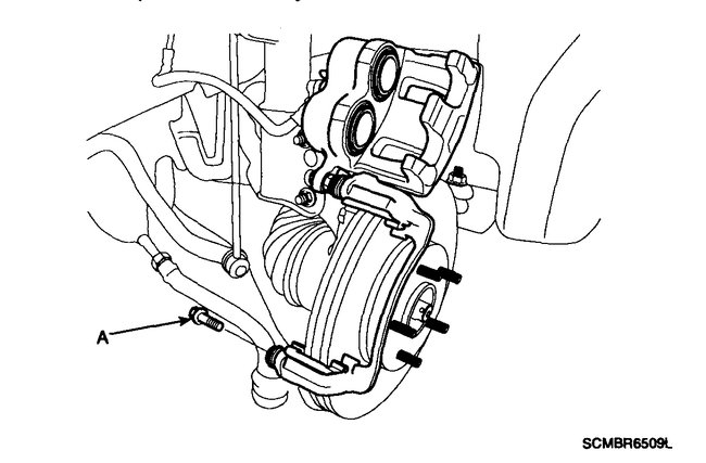

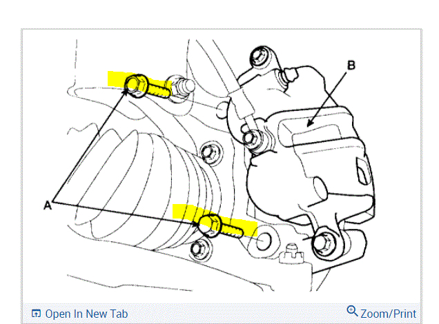

To remove the brake rotors, you will need to remove the caliper mounting bracket while the caliper is off. See the last two pics for the bolts to be removed and torque specs.

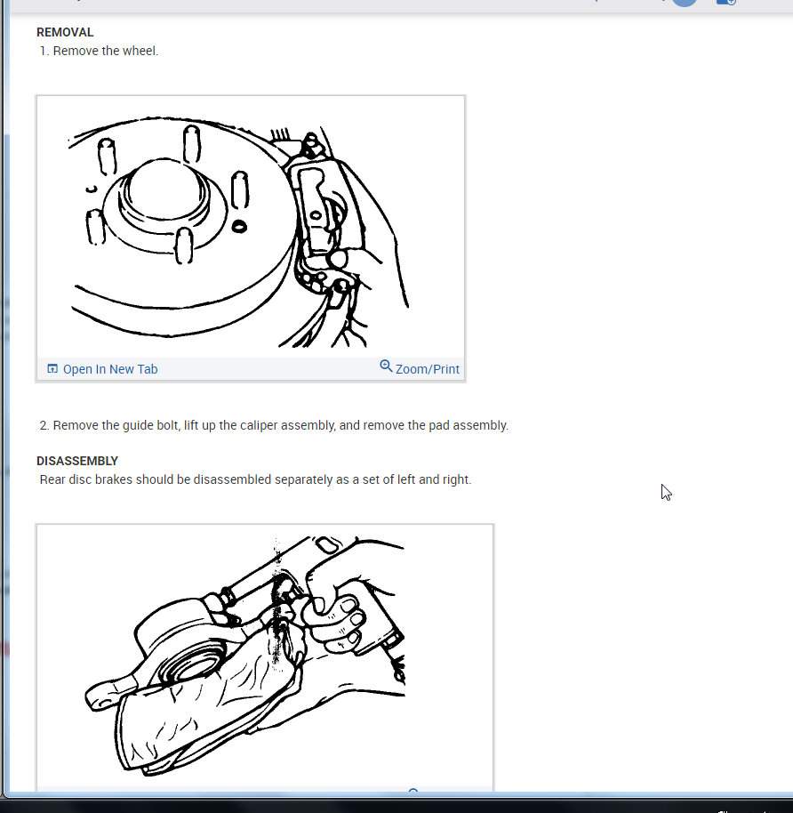

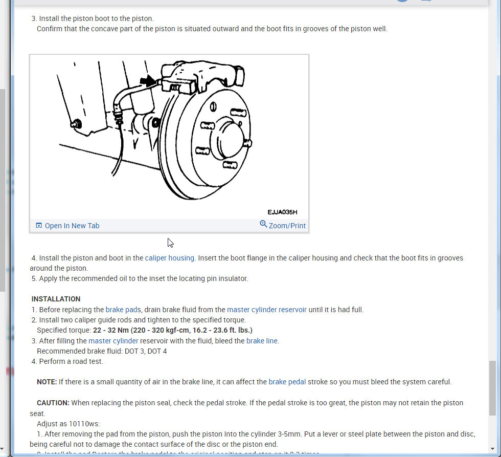

Here is a guide that will help with this:
Plus below is the process from the manual that will help with replacing the pads and rotors.

If you are just replacing the brakes and rotors, there is no need to bleed the system. As far as the rotors, if you feel the shaking in the steering wheel, chances are only the front rotors are warped.
