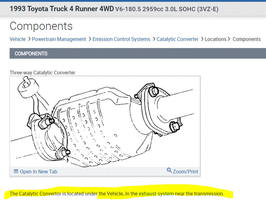

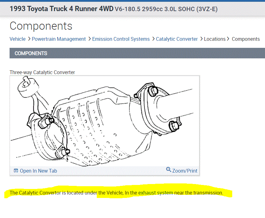

Do me a favor. After this happens and before you turn the engine off, inspect the catalytic converter (see pic 1 for location). If it is plugged and raw fuel is getting into it, there is a chance it will be red hot. So, check to see if that is the case.
See pic below.

The catalytic converter never got over 700°. It does not rattle when shaken or struck very hard.

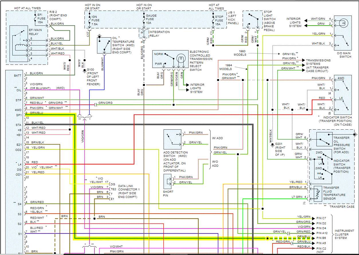

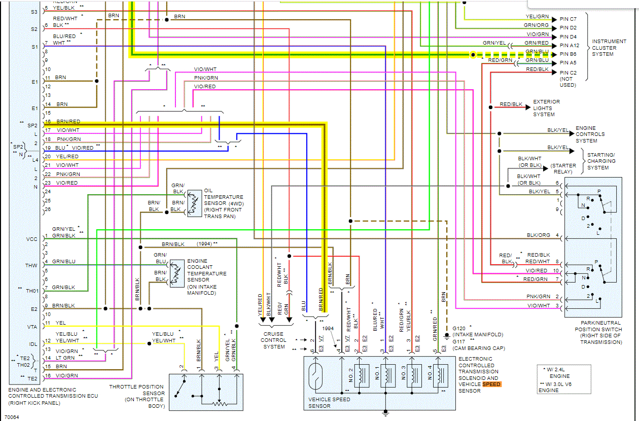

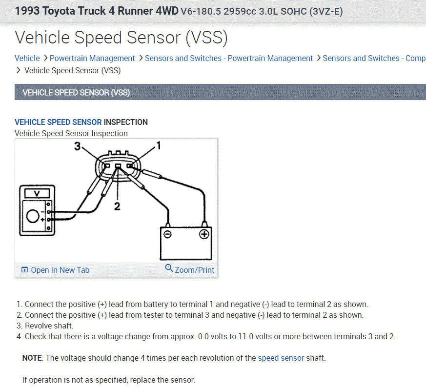

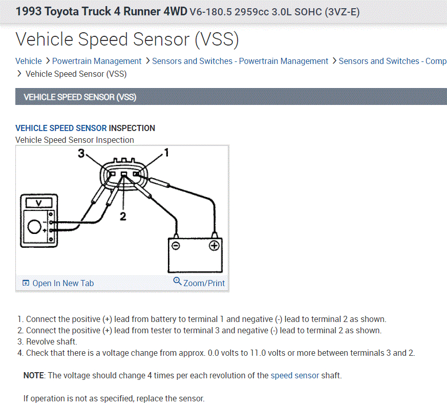

The idea that the speed sensor starts working is odd. I would have thought the opposite would have happened. Have you checked the vehicle speed sensor (VSS)? The vehicle speed sensor is used to monitor actual vehicle speed. Vehicle speed information is used by the ECU for fuel injection, cruise control, and electronic control of the automatic transmission. We may have a lead.
IF you haven't already, we need to check the VSS. I attached the directions below. Let me know if you are comfortable performing them.

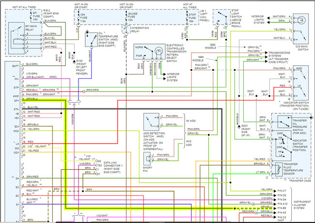

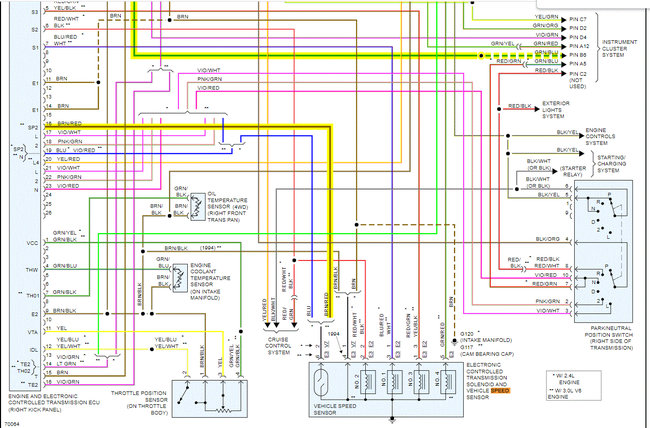

Next, there is a brown wire with a red tracer that runs from the VSS (part of the trans control module) to the ECU and then changes to green with a blue tracer to the instrument cluster. We need to check those connections. Make sure they are tight, clean, not damaged, have no corrosion in the connectors, and none of the pins are pushed damaged. The ECU is located behind the right kick panel (where a passenger would rest his right foot). You know where the instrument panel is located (LOL).
Since the speedo is activating when it happens, I think it's either causing the transmission to shift into the wrong gear. For example, driving a manual in 5th gear at 10 mph. That would cause a bucking.
Pay attention when it happens if the engine RPMs are extremely low.
Let me know what you find.
See pics below Note: Pics 2 and 3 are from one page. I had to cut them in half to make them readable. I overlapped them so you can follow from one to the next.

I was wondering if that speedometer activity might be a clue. I am comfortable doing those tests, but may not get to it until Thursday. I will absolutely write back with the result. And, by the way: your description of trying to drive in fifth gear sounds really close to what I am observing, only I’ve only seen that on a standard transmission. Indeed, the tests you suggested will be my next move. Thanks. “Talk” to you soon.

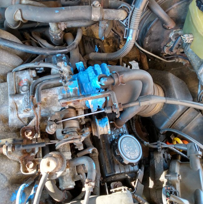

I changed out the ignition coil, put in a new battery and changed the spark plugs. This is all after spending all the time trying to trace the computer wiring. Here’s the kicker: when trying to install plugs on the right bank, I found all the intake ductwork was in my way. So, I pulled it all out; simple enough. But what I found was a major break in the tube that was attached to the throttle body intake manifold. It was impossible to see before actually disassembling it. I had to cut away all of the broken and cracked part of the duct, which left it too short. For a temporary fix, I basically glued the tube onto the fuel injection air port. The improvement was astonishing. The only problem I apparently have now is a low idle speed when the engine goes into a closed loop. I’m going to need to change that one tube, but for now my shitty looking repair has done wonders for its performance. So, in the end, the throttle body was sucking the air it needed through the broken tube. So, when the Mass Air Flow Sensor kicked on, it had no air passing through it. This sent a message to the co outer which tried to adjust to the condition. But all it could do was overcompensate by fluctuating on every rotation of the crankshaft, it would add fuel, then shut it off. Hence the bucking situation. I’ve driven around town for a while with no more problems than that of the low idle at temp. What do you think about that? I’m going to start looking for the broken part after this letter.

Here is a picture of the ugly yet temporary fix. Yucky but functional.
Wednesday, November 10th, 2021 AT 4:16 PM
  • 110,194 POSTS
The fix may not be pretty, but it's functional. The idea that that was broken created a huge vacuum leak so certainly, that was the problem.
