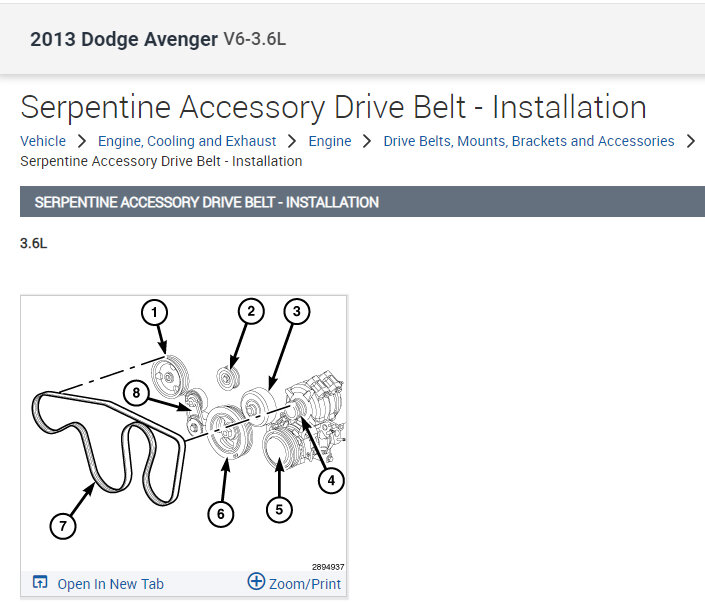

How do you put a serpentine belt back on the vehicle listed above SXT model?
Aug 18, 2024 at 6:00 AM
  • CAR REPAIR CONTRIBUTOR
  • 110,193 POSTS

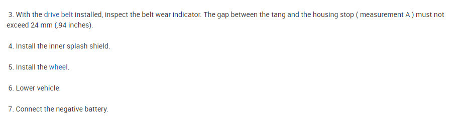

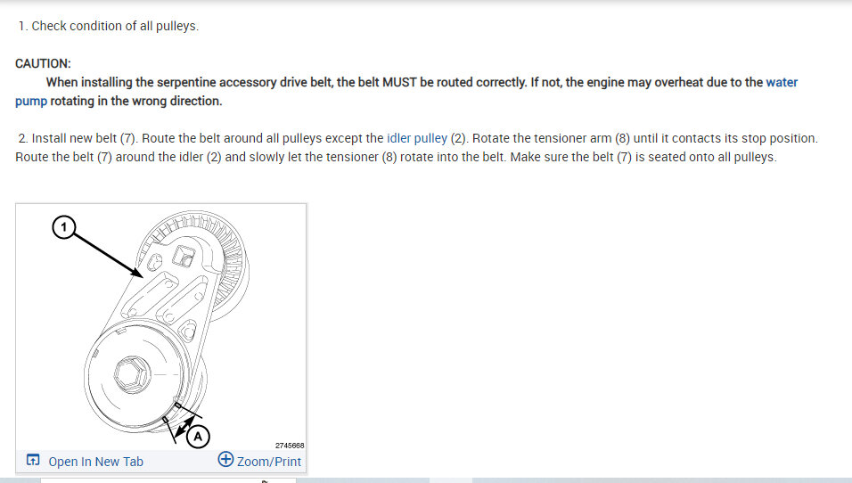

It is a bit tight to do, but you'll get it. To get you started, here is a link that explains in a more detailed way how in general one is replaced:
If you look below, I included the manufacturer's directions for installing it.
