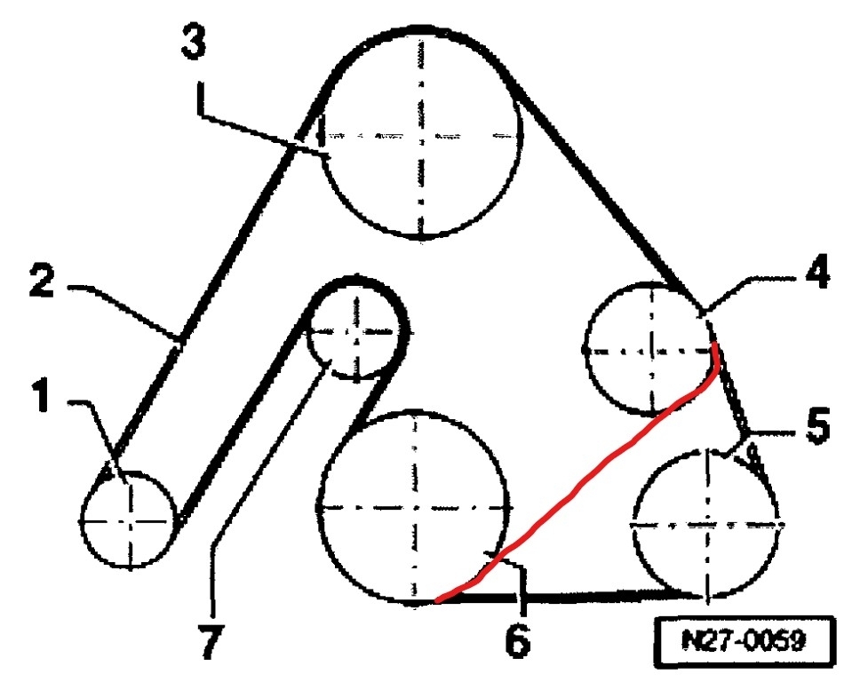

Serpentine belt bypass?
2002 VOLKSWAGEN PASSAT
18,776 MILES • 2.8L • V6 • AUTOMATIC
LEXISMAMA85!
I need to bypass my ac compressor pulley what size belt do I need
Dec 27, 2025 at 8:55 AM
STEVE W.
  • 15,171 POSTS
That car was offered with and without AC. With the belt routing it uses you should be able to just install the non-AC belt to bypass the compressor. The AC version runs the black line, the red line would be the non-AC belt. However there is also an enhancement kit sold for that engine and it uses different belts.
