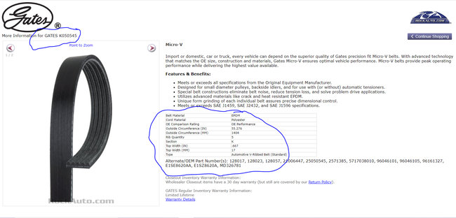

What size serpentine belt do need I tried a 13/16 x 79 1/2 20mm x 2018mm.
Tuesday, June 1st, 2021 AT 8:09 PM
MECHANIC
52,796 POSTS
Good morning,
I attached the specification for you of the belt required for your car.
I would use a Gates belt as they are the best and most reliable.
