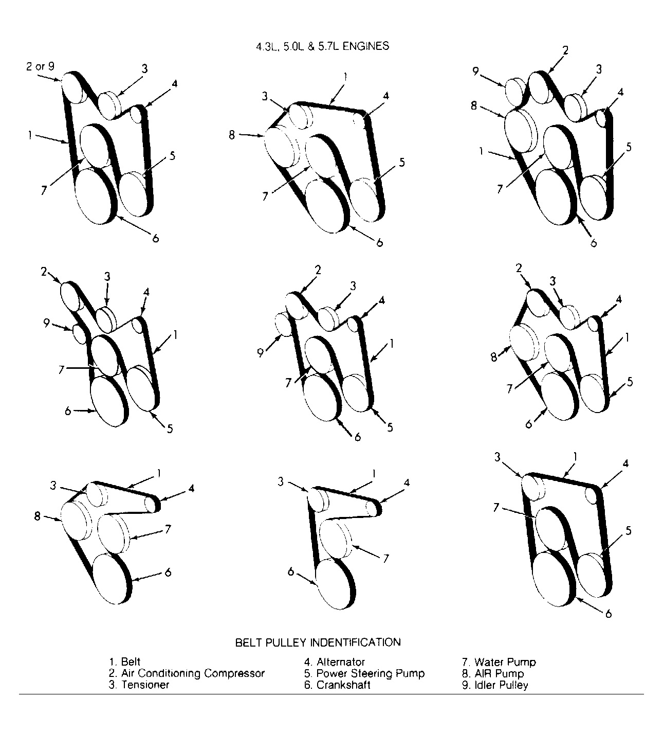

I need routing for a serpentine belt with and without A/C for the truck listed above.

Here is a guide to help you step by step with instructions in the diagrams below to show you how on your car.
Image (Click to make bigger)
