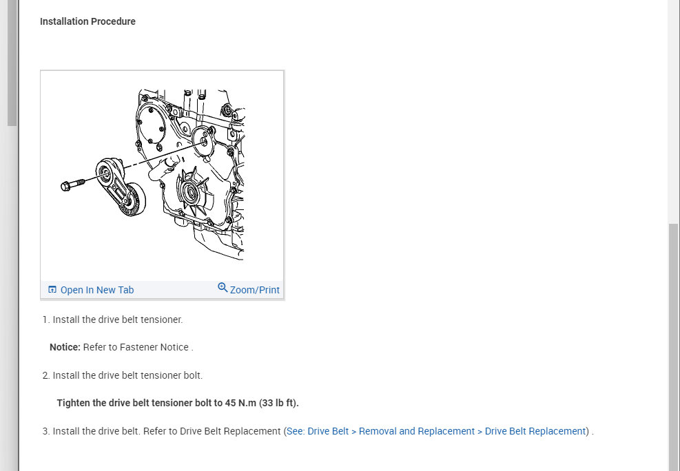

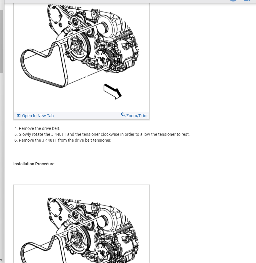

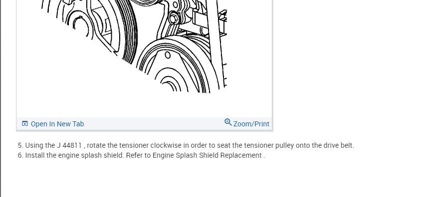

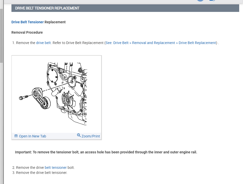

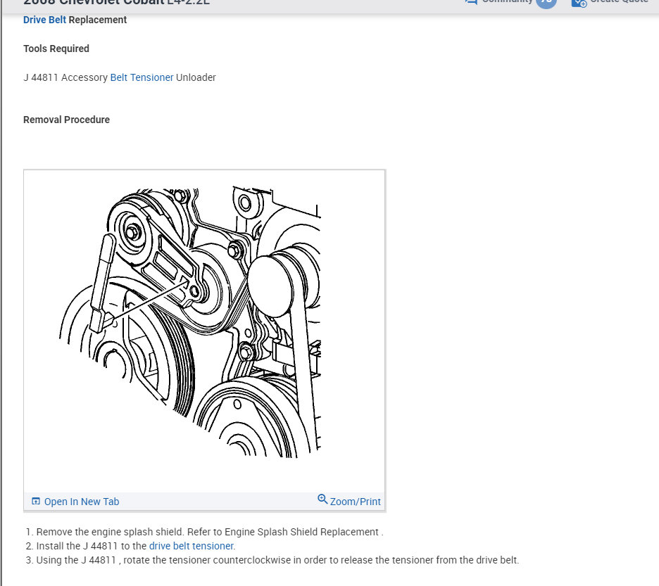

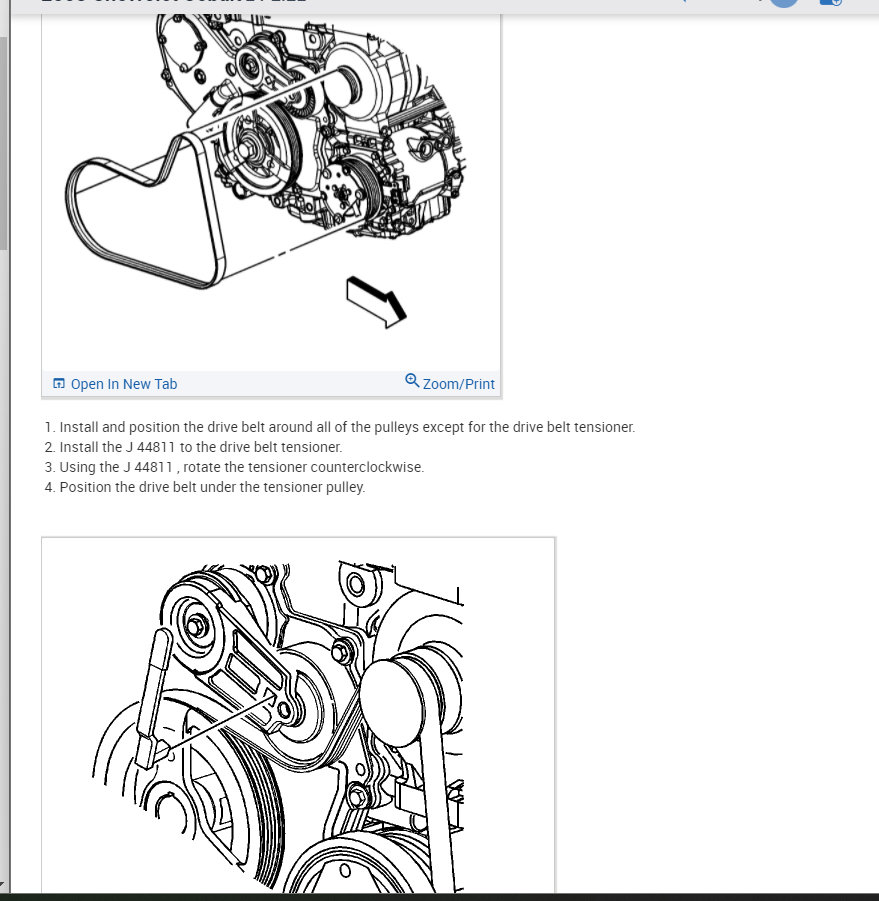

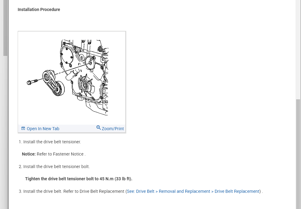

Replacing belt and tensioner and pulley noticed pulley wiggling.
Tuesday, March 8th, 2022 AT 9:56 PM
MECHANIC
18,907 POSTS
Just to be clear you were changing the belt and the tensioner pulley was loose or a different pulley was loose.
If it was the tensioner, here is a guide that will help with this:
https://www.2carpros.com/articles/serpentine-belt-tensioner-replacement
Please find the info below from the manual that will help replace both the tensioner and belt as well.
Let us know if you need more info. Thanks
