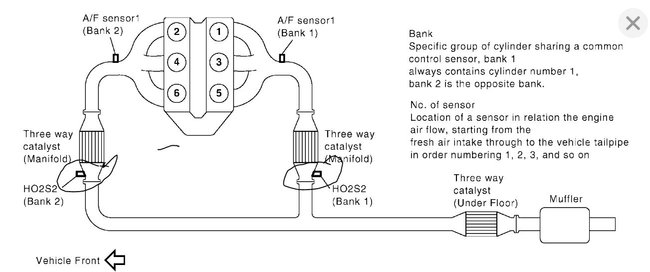

Is there a sensor on the catalytic converter on my car and where would it be on top of the catalytic converter in the front?
Monday, August 5th, 2019 AT 7:33 AM
MECHANIC
52,796 POSTS
Good afternoon,
You have two catalytic converters. One for each bank.
Yes, there is a sensor for each one. They are behind the converter and in plain sight.
What is the issue?
