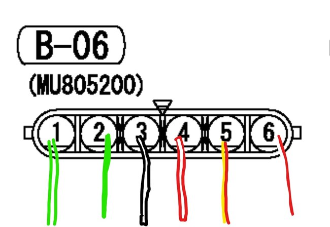

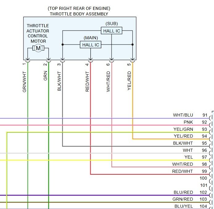

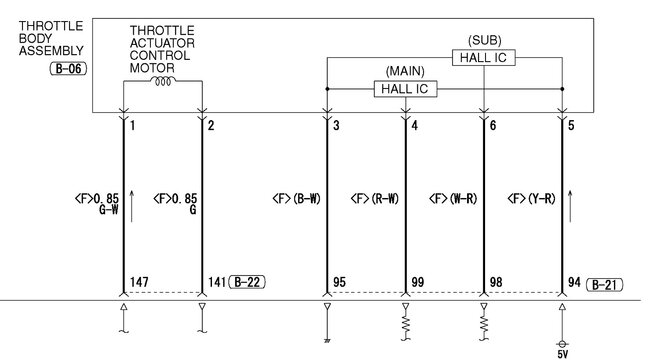

Schematics wiring diagram for the 6pin harness connector for the throttle actuator
2008 MITSUBISHI ECLIPSE
161,000 MILES • 2.4L • 4 CYL • 2WD • AUTOMATIC
MILLER007
I'm getting different takes on which wires go where

These are the color and OEM wiring diagrams for the throttle body. The connector image shows the colors as well. There is a different diagram for the manual transmission and the V6 version which is different than both. Pin 1 Green with white stripe, Pin 2 Green, Pin 3 Black with white stripe, Pin 4 Red with white stripe Pin 5 Yellow with red stripe, Pin 6 is White with red stripe.
