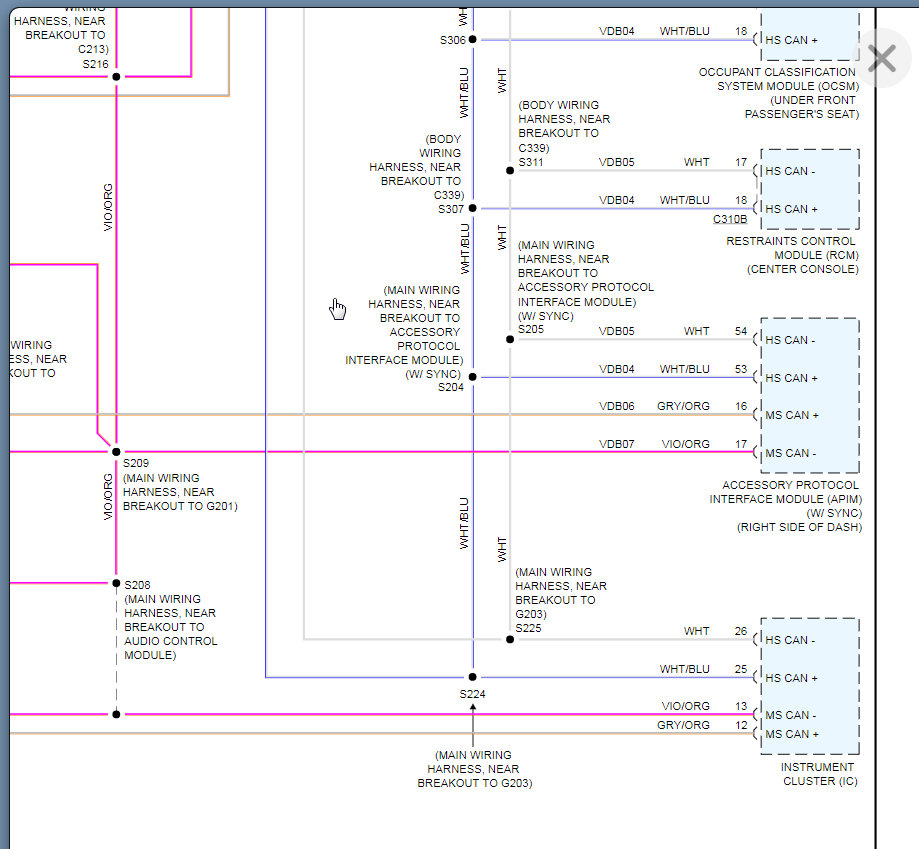

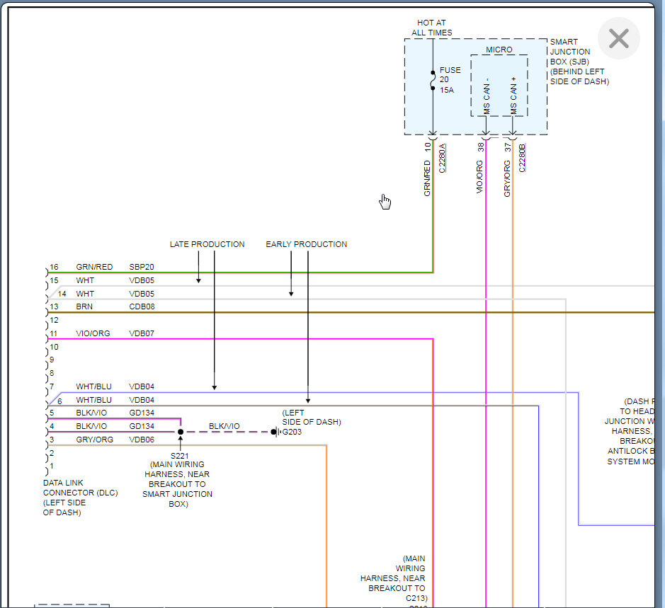

Do you have codes in the other modules? If you can communicate with the other modules then you should be able to pull other codes. If you cannot then we may have a bus network issue.
Here is guide that talks about this CAN network:
I would expect that we have loss of communication codes in the other modules that say they cannot communicate with the ECM. However, if the vehicle starts and runs and you have none of these codes then I suspect we have a scan tool or wiring issue.
So if this vehicle starts and runs, let's stop by a parts store and ask them to scan it. If we have two scanners that cannot communicate with the ECM then we can chase down a wiring issue.

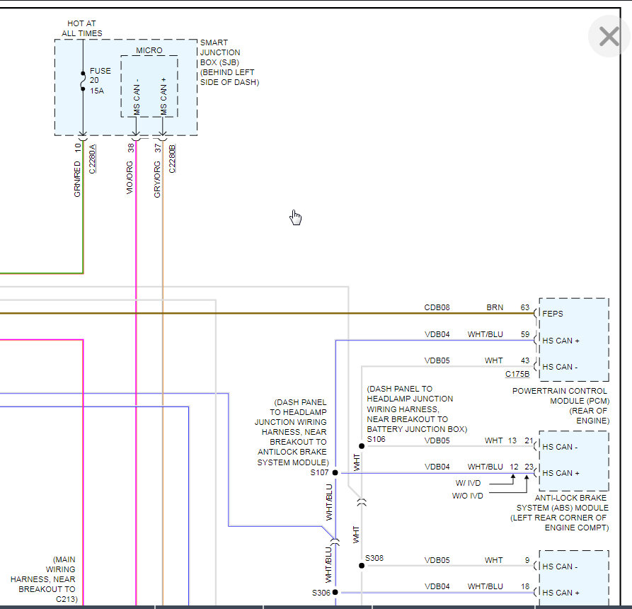

At that point, I need you to get the voltage on pin 6 of the DLC and then get the voltage on pin 14 as well.

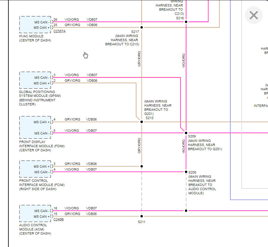

Let's start with this and go from there. Below is the wiring diagram for this. Thanks

Hi, is it possible to see an image of this smart junction smart box? I know under the dash on the left side you got a fuse box, is that what you referring to?

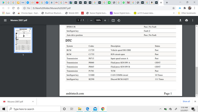

These are the other codes related to other modules.
Tuesday, February 2nd, 2021 AT 5:52 AM
Okay. I think we may have some confusion. What is telling you that you cannot scan the ECM? Are you thinking that because the check engine light is on that you have an issue with the engine control module?
If that is the case then that is not accurate. These other codes will cause the check engine light to come on as well. The check engine light is a generic term these days for a greater powertrain related issue.
The reason I am thinking this is the issue is because the CAN network is working perfectly based on what you did with these voltage checks and if the ECM was offline or not communicating with the scan tool then it would also not communicate with the other modules which would set all sorts of codes against it but you have none of these.

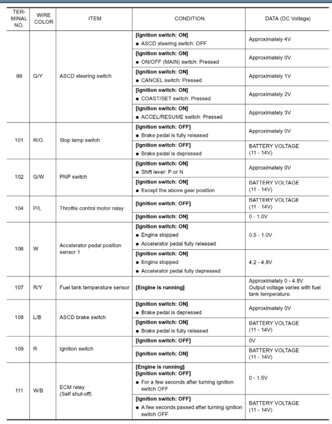

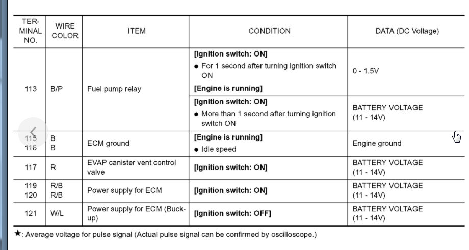

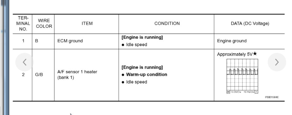

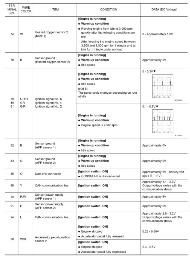

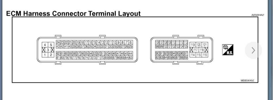

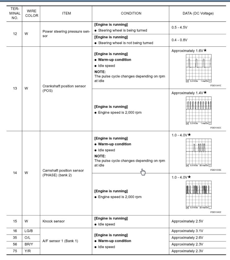

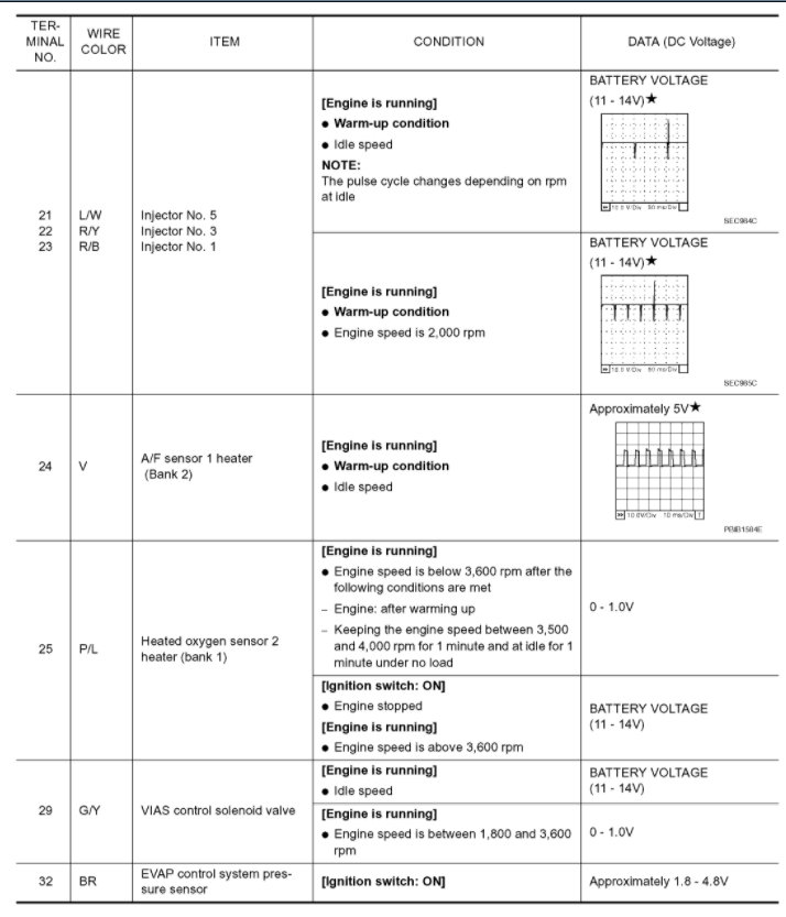

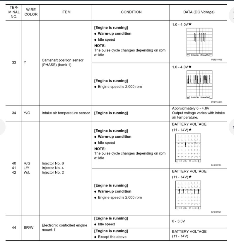

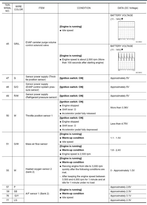

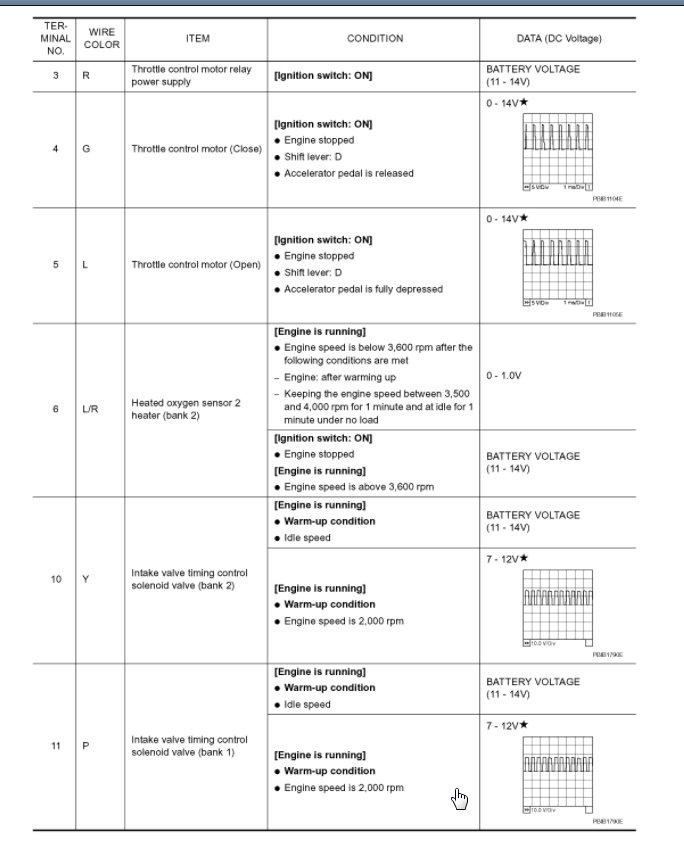

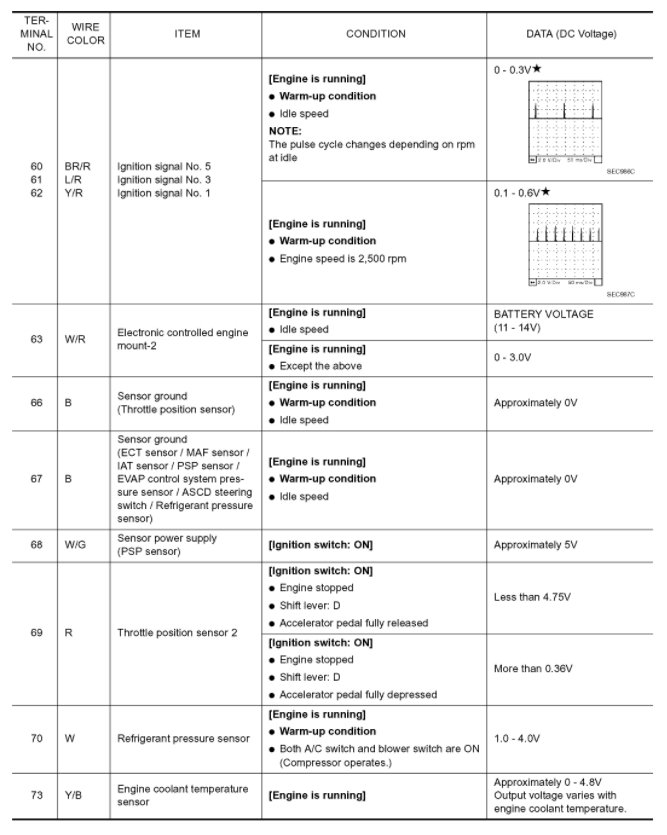

Lastly to mention, notice the part number for the ECU, it's for a 2004 Muruna, do they have same ECU Pin Out signals?
Wednesday, February 3rd, 2021 AT 11:13 PM
Okay. First, you are correct that they should equal 5 volts but they can vary slightly so the fact that this is at 4.86 volts total, that is not going to cause an issue as the bus can still operate like this.
Also, just because the ABS does not have any DTCs in it, is not an issue. It is not going to show up on that report unless it has a DTC in it. So if the ABS is not on the list, that just means it doesn't have a code in it.
Lastly I attached the ECM pinout below.
