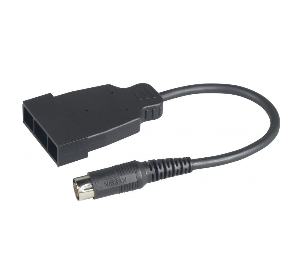

What cables do I need for my Genisys EVO 4, 0 scan tool in order to scan this vehicle? The scan tool tells me that I need the proper Nissan cables.

Welcome to 2CarPros. You need the OBD II cable with the correct key or the smart cable. You can also use the OTC 3305-141 cable if you have the correct connector. That cable is used with the adapter. However it should have the common connector. This guide can help as well
