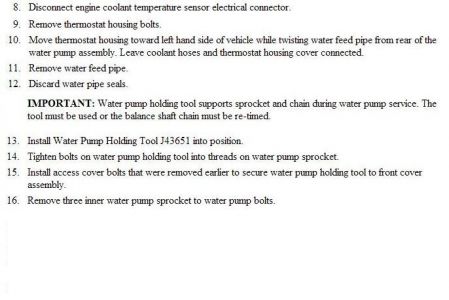

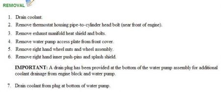

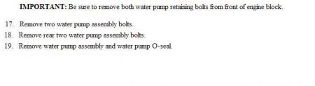

I cant seem to get the water pump off because of a tube that is running from the pump to a module box on the block
Sunday, February 21st, 2010 AT 2:51 PM
BLUELIGHTNIN6
MECHANIC
16,542 POSTS
Sunday, February 21st, 2010 AT 9:34 PM
