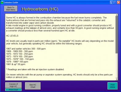

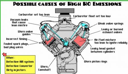

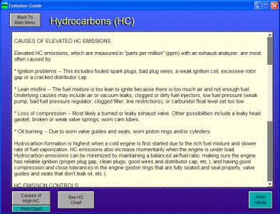

Here's the scoop on HC's
https://images.2carpros.com/forum/automotive_pictures/62217_HC_1.jpg
https://images.2carpros.com/forum/automotive_pictures/62217_HCa_1.jpg
https://images.2carpros.com/forum/automotive_pictures/62217_HCb_1.jpg

[quote:863d5c227e="merlin2021"]Here's the scoop on HC's
[images][/quote:863d5c227e]The general information about excess HC is interesting, but it doesn't answer my question, which was about what quick practical step I might take to nudge the HC down by 1 PPM to pass the test. In particular, is a Techron (or other) gas treatment likely to be helpful, or is there a recommended octane or variety of gas that will improve combustion slightly? (I acknowledged your general advice on your smog page to do some hard driving and bring in the car for the test after at least half an hour on the road.)

OK let me ask yopu, what does your owners manual say about octane? Some 4 cylinder engines are high compression and require premium fuel. On newr cars it actuallt has a sticker in the fuel door stating what octane. Use a quality gas no matter what the rating is. I dont mean higher, I mean MOBIL, SHELL, EXXON, vs. unbranded fuel.....burn several tanks of quality fuel then take the test. As stated injector may be partially clogge, especially trua if unbranede gas is constantly used. Vacuum leaks and any LEAN burn conditions are the concern! If the motor is tight (no oil burnibg) then the two important sensors here are the MAF(controls injector pulse width) and ECT(acts as a choke) for SEFI engines, Either can be slightly out of range, and not set a trouble code(DTC) or turn on the MIL. Of course this all is with a good running engine, good fuel pressure, no oil burning!
