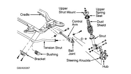

I was involved in a swip accident. My right tire is pulled out and pushed in. When I turn my wheel to the left to do a u turn it wobbles. Any suggestion?
My check engine light turned on after I had the waterpump installed. At first it would turn on and off idk what it was. It stayyed on and now its off for a sec when my car turns on. Then its back you. Any ideas?
My car is vibrating a substantial amount reduced it with a Oil change but still there!

Hi there,
As you can see in the pic there is a number of components that can be damaged, I would be thinking that the strut may be bent, and possibly the tower mounting where the strut mount sand the lower control arm, these are the most common things that give way. As for the check light you will need to get a scan done to check for any unresolved fault codes, start here.
