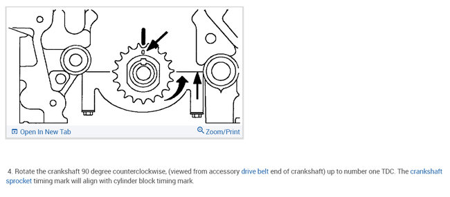

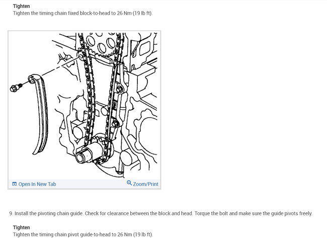

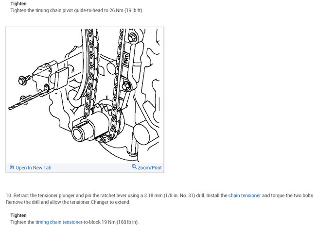

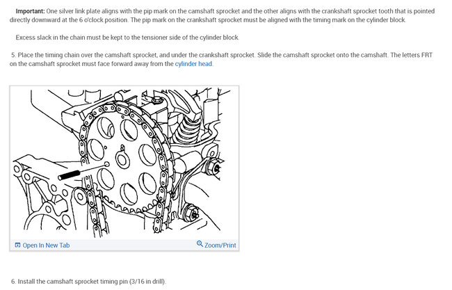

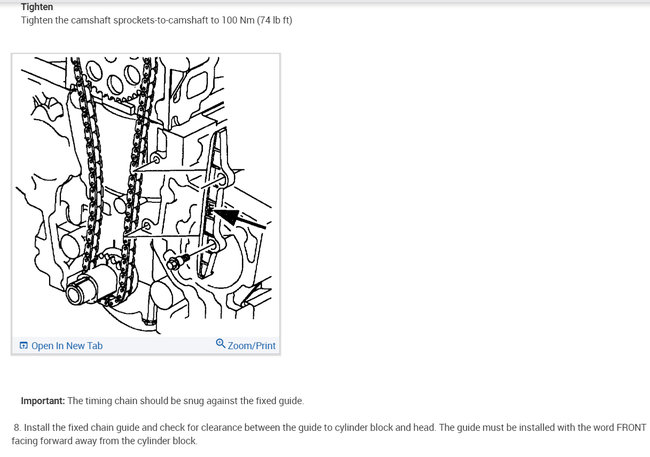

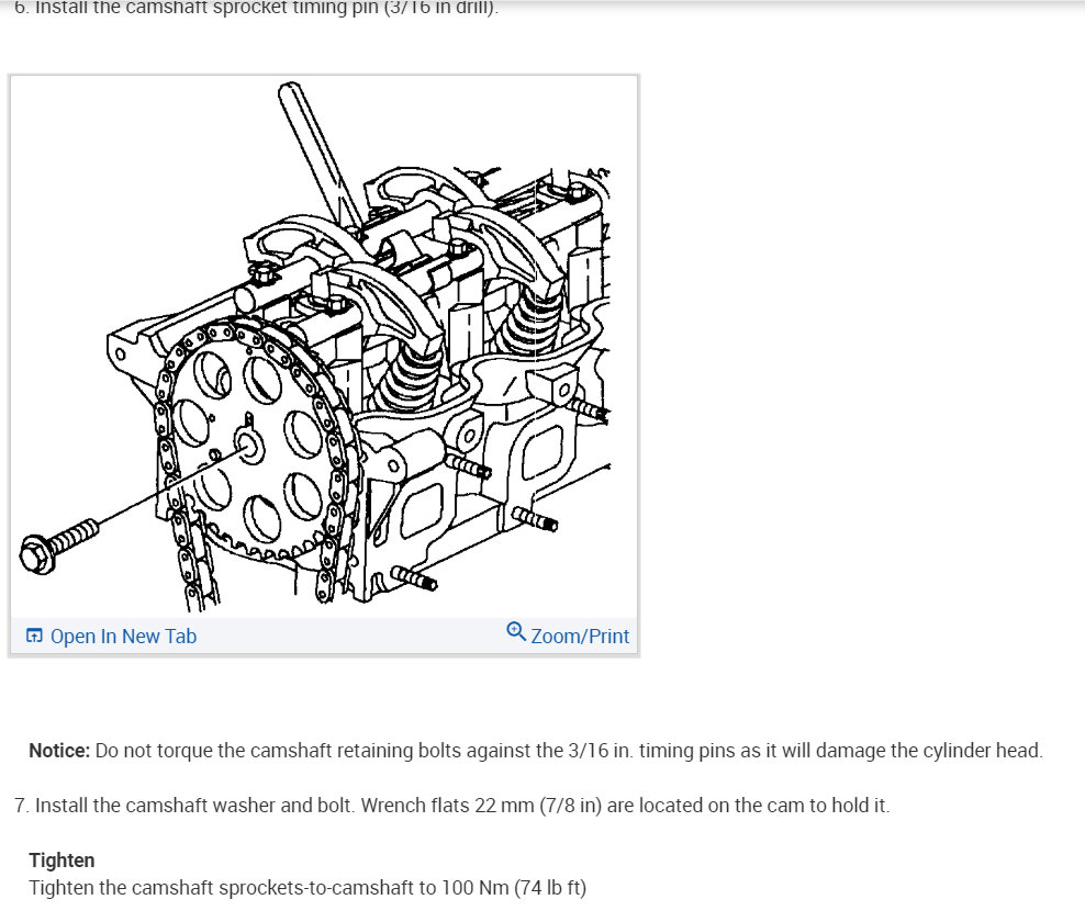

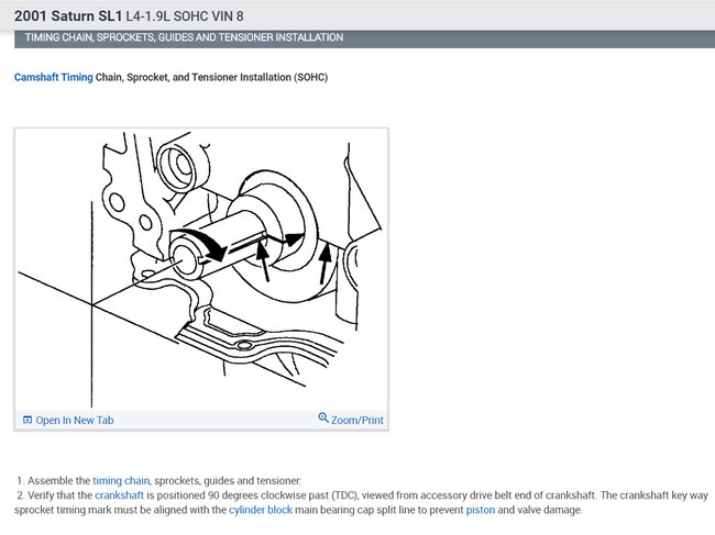

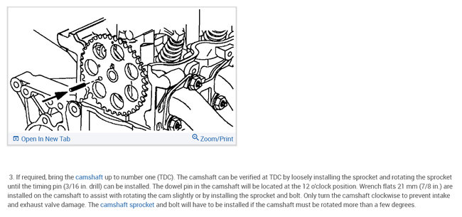

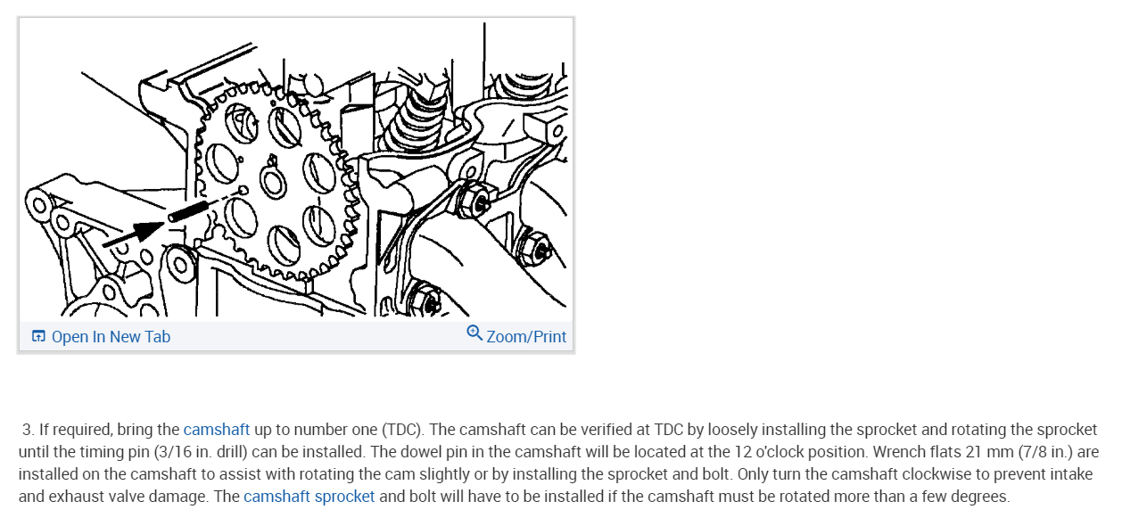

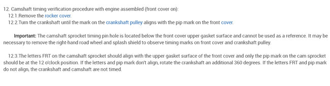

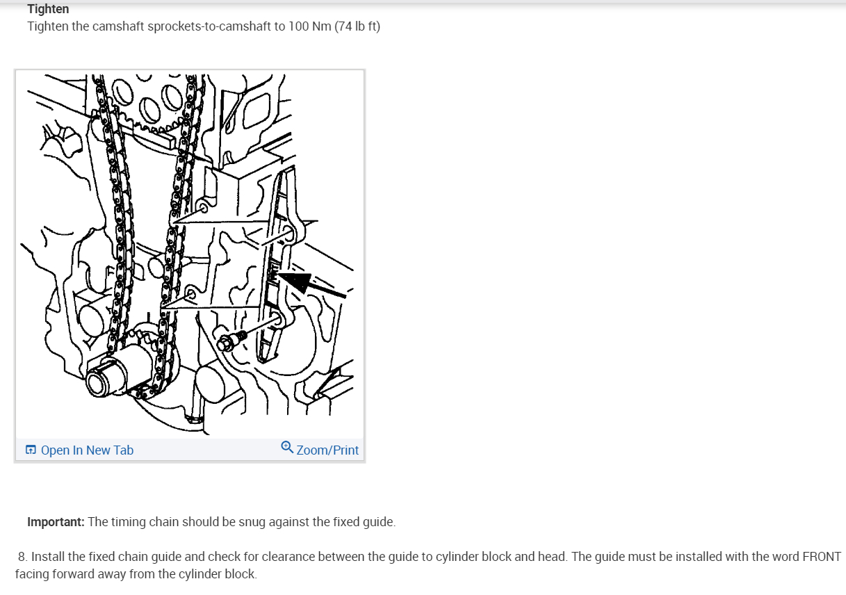

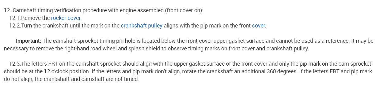

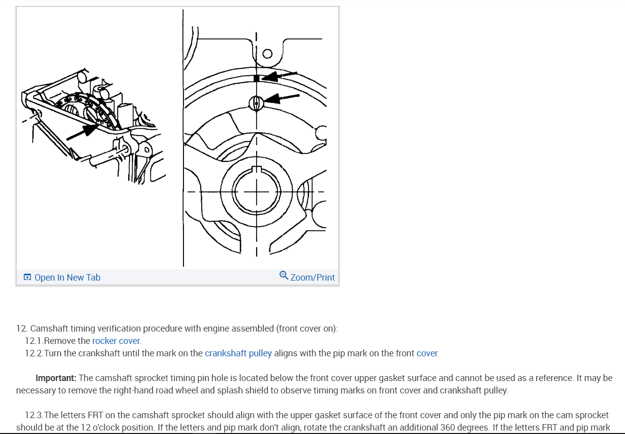

how do i replace the timing chain
Mar 18, 2009 at 12:41 PM
BMRFIXIT
  • 19,053 POSTS
Here is the instructions on how to replace the timing chain in the diagrams below. Check out the diagrams (Below). Please let us know if you need anything else to get the problem fixed.

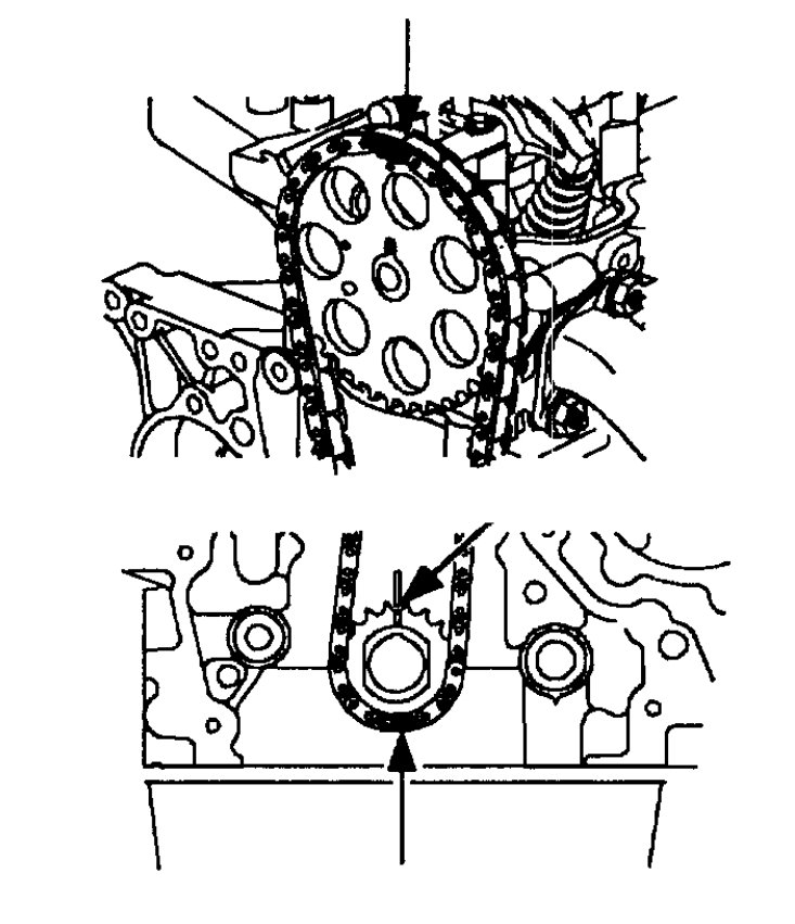

I would like to know the proper timing procedure for timing chain installation. It is a dohc engine.
Apr 30, 2020 at 10:47 AM (Merged)
SATURNTECH9
  • 30,869 POSTS
if u havent taken the chain off yet all u do is turn the engine over clockwise with the front cover off and the spark plugs out till the crank mark on the crank sprocket lines up at the 12 o clock postion on the block.then look at the intake and exhaust cam sprokets there marks shoulod be up.another way to verify that the cam sprockets are lined up is there are dowl holes in the head and the cam sprockets.when there lined up correctly ur dead on.i belive the size of there holes are 5/32" drill bit.also when u take off the front cover make sure u put a rag in the opening below the crank so nothing falls into the oil pan.also number 1 and 4 cycl will be top dead when ur marks are lined up.let me know how it goes.

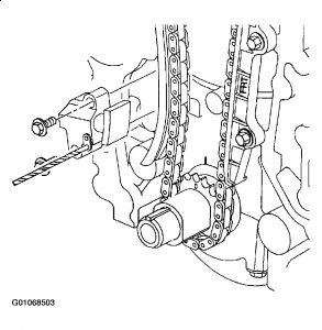

Car makes rattling noise when starting for 2-4 seconds and fades out. One mechanic at a local car shop thinks it is the timing chain tensioner worn out and needs replacement soon. I have been very good at keeping oil changes and maintaining oil levels.
If this true, what would the estimate be?
DOCFIXIT
  • 18,828 POSTS
Hi Very possible tensioner and guides would be worn at that milage. see diagram
https://images.2carpros.com/forum/automotive_pictures/198357_Grafic_3_74.jpg
Cost @$700 -$850 Hope this helps Thanks for donate

For the crank line up the line at the 12 o clock mark on the block.For the cam you Line up the dowl hole on the cam sprocket in the head with mark on the sprocket at the 12 o clock.Then line up the color links with the marks on the sprockets.
