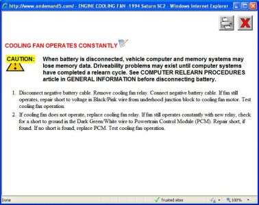

I just replaced the radiator in my 94 SC2, now the radiator fan runs continually. How do I fix this problem?

Either 1, the fan motor is bad (not likely if its still running as they usually die when they go bad) or 2, problem with the fan relay.

Try this and let me know what you find.A bad fan motor can't make it's own power if it's bad it won't work and can blow the fuse.
