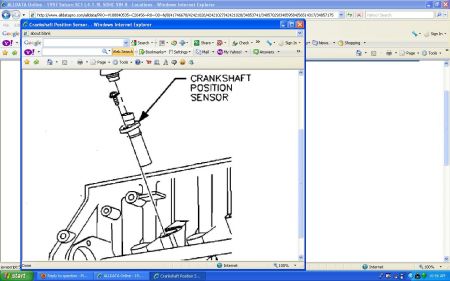

Is the crankshaft sensor hard to replace
Friday, October 22nd, 2010 AT 11:31 PM
SATURNTECH9
  • 30,869 POSTS
No it's not hard to replace and there as cheap as 20. But you have to change them from the bottom so you have to jack the car up and put it on jack stand's. We have to figure out if it's a bad crank shaft sensor before we change it though. Try what I suggested in my last post and we will go from there.

yes I do have multimeter
Wednesday, November 3rd, 2010 AT 12:11 PM
SATURNTECH9
  • 30,869 POSTS
To test the crank shaft sensor you would put the ohm's meter on 2k ohm's scale when it doesn't start and unplug and remove crank shaft sensor then test across the two terminal's of it.They usually read as a open circuit when they test bad.Or you can rent a scanner for your car that read's live engine and when it die's and won't start you can look at your live engine data and see if you have a rpm reading while you crank it.The sensor is on the back of the engine block below the end of the starter.
