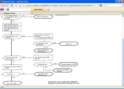

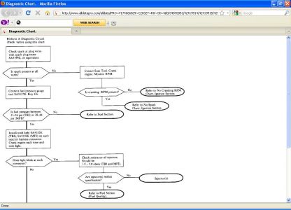

Nop no light at all and yes it has spark I was told to check the ohms on my injectors and they are go n from about 4 and they trinkle down to.01 I thought they were supposed to stay up around 4 ohms
Tuesday, August 3rd, 2010 AT 6:53 PM
SATURNTECH9
  • 30,869 POSTS
https://www.2carpros.com/forum/automotive_pictures/416332_1991_SC_injector_wiring_part2_1.jpg
https://www.2carpros.com/forum/automotive_pictures/416332_1991_SC_crank_no_start_part1_1.jpg
https://www.2carpros.com/forum/automotive_pictures/416332_1991_SC_crank_no_start_part2_1.jpg
https://www.2carpros.com/forum/automotive_pictures/416332_1991_SC_crank_no_start_part3_1.jpg
https://www.2carpros.com/forum/automotive_pictures/416332_1991_SC_crank_no_start_part4_1.jpg
Follow the trouble i posted the pcm is on the driver side right as you enter the car under the dash can't miss it.
