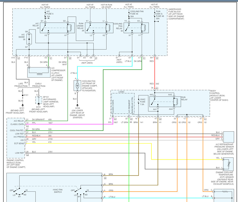

Think fuse is blown, saw sparks while testing?
Saturday, February 27th, 2010 AT 3:44 AM
MHPAUTOS
MECHANIC
31,937 POSTS

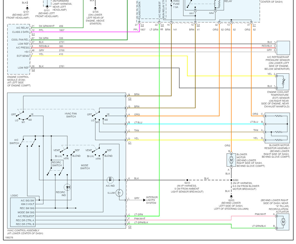

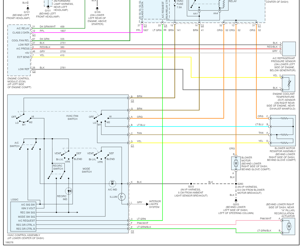

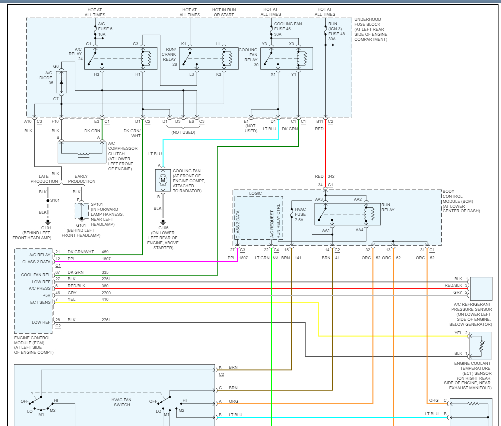

Here is the wiring diagrams for the AC system so you can see how the system works and which fuses to check. I also included a guide to help you check the fuses.
Check out the images (Below). Please let us know what happens.
