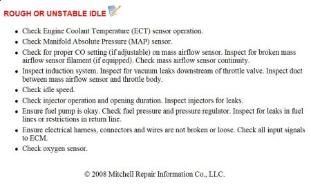

I have here the list of probable causes and if you require info how to go about testing which item, let me know and I will assist you.
https://www.2carpros.com/forum/automotive_pictures/192750_PoorIdling99Saab93_1.jpg

Thanks for the quick response I have checked all the items listed and checked fuel lines no leaks changed the spark plugs cleaned IAC idle air control still not luck I have a suspicion that could it be perge valve could be cause of this. Please assist with diagrams.
