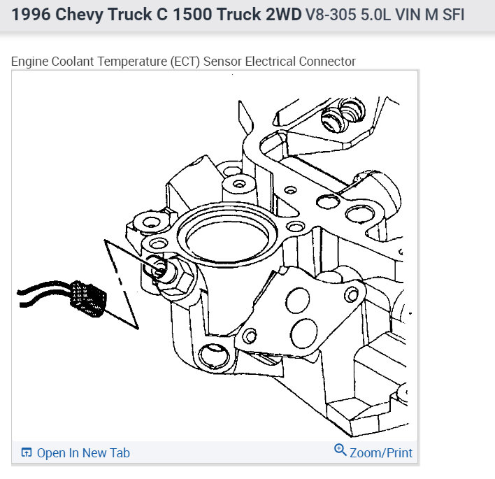

Truck will start and run for 15 minutes or so then it will shut down and won't start again until it cools down.

It sounds like the fuel pump is going out, when it won't start will it run on starting fluid? Also, can you hear the fuel pump in the tank run? Also, it could be the engine coolant sensor that shorts out when hot. Please go over this guide and let me know:
https://www.2carpros.com/articles/why-does-my-car-engine-stall-when-hot-and-how-can-i
Also go over this guide as well:
https://www.2carpros.com/articles/car-not-running-advanced
Here is the location of the sensor and a generic guide to help you step by step with instructions in the diagrams below to show you how on your car:
https://www.2carpros.com/articles/coolant-temperature-sensor-cts-replacement
Check out the images (below). Please let us know how it goes
