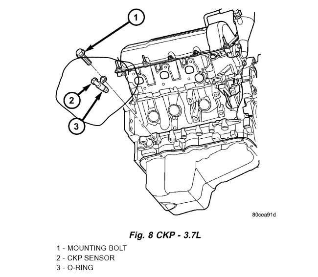

Motor runs and shuts off after 2-3 minutes.

Does it start right back up or do you have to wait a while for it to start?

It starts right back up.

Okay, good possibility it is the crank sensor. It is common for failing like this and restarting right away.
I attached a picture of the location for you.
The Crankshaft Position (CKP) sensor is mounted into the right rear side of the cylinder block. It is positioned and bolted into a machined hole.
1. Raise vehicle.
2. Disconnect sensor electrical connector.
3. Remove sensor mounting bolt.
4. Carefully remove sensor from cylinder block in a rocking and twisting action.
5. Check condition of sensor O-ring.
INSTALLATION
1. Clean out machined hole in engine block.
2. Apply a small amount of engine oil to sensor O-ring.
3. Install sensor into engine block with a slight rocking and twisting action.
CAUTION: Before tightening sensor mounting bolt, be sure sensor is completely flush to cylinder block. If sensor is not flush, damage to sensor mounting tang may result.
4. Install mounting bolt and tighten to 28 Nm (21 ft. Lbs.) Torque.
5. Connect electrical connector to sensor.

That fixed the problem. Thank you
