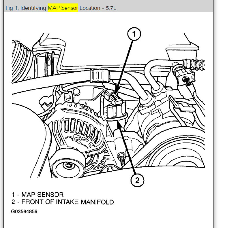

Lets check for vacuum leaks. also please remove the MAP sensor to see if it holds vacuum. And did you run the codes?
Check out the diagrams (below). Please let us know what you find.

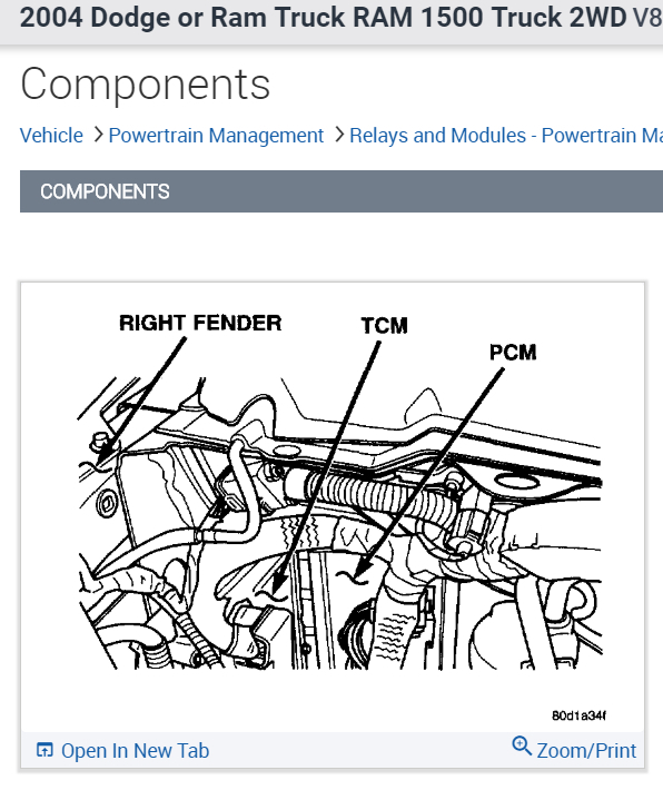

KEN L
  • MASTER CERTIFIED MECHANIC
  • 55,297 POSTS
Does the MAP sensor hold vacuum? I would try replacing the sensor I have seen them cause high idle. If that does not work I would replace the PCM with a rebuilt or used unit. Here is the location. If you get a rebuilt one give your VIN so it can be programmed. Check out the diagrams (Below). Please let us know what happens.
