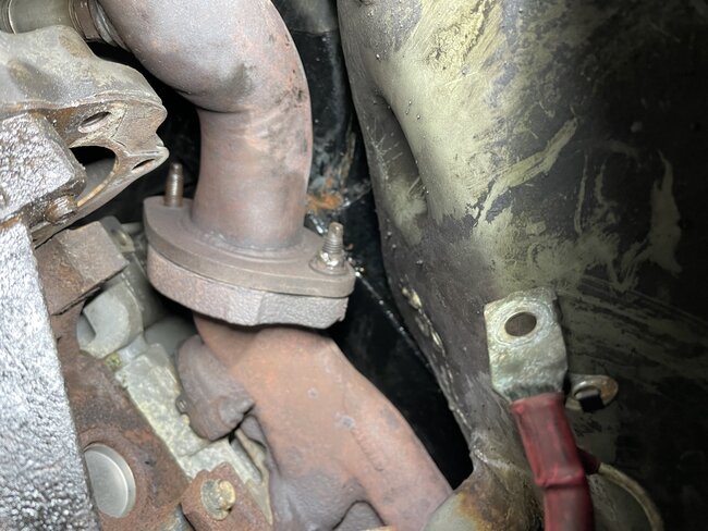

I’m struggling to remove the nuts on exhaust flange. I’m dealing with rounded off nuts from previous owners/work that was done. I managed to remove the top one. Second one I couldn’t even get the 15mm socket to work. I removed the starter hoping to get more access. It’s all but impossible to get good leverage. I tried using my bolt/nut extractor but again I don’t have much room to pound it on. I’ve broke two of my universal adapters and I’m kind of at a loss. I’m adding a picture of what I’m dealing with. Any ideas?
Jul 18, 2025 at 4:04 PM
  • 54,502 POSTS
I would use an air chisel and try to catch the corner of the nut to spin it off.

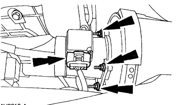

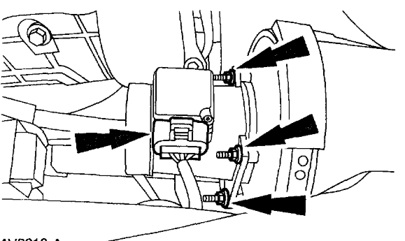

Nice work taking care of the p2195 code, I would use a smoke machine to help located the vacuum leak. Next, once the MAF sensor goes bad cleaning it will not help, I would get a new one, and finally I would do a compression test. Please go over these two guides,
https://www.2carpros.com/articles/repairing-engine-rough-idle-issues
and
Here is the MAF sensor location so we can be on the same page. Check out the images (below). Let us know how it goes.

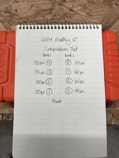

I replaced my MAF sensor. I had the battery unhooked over night. Car seemed to run better so went for a drive. Ended up being 30min. I did have the ac on so extra load on engine but still seemed ok. Got to my destination turned off ac and noticed rough again. Once we left to head home check engine light came on with p0171. My live data showed under acceleration my short term bank 1 full trims were all but matching bank2. Did the smoke test and found a small vacuum line leaking. Fixed that and still no change in idle or fuel trim. I did a compression test. See picture for results. Something else I found is I have an aftermarket intake manifold on it. No markings of a manufacturer but it not an original. Also, the car has an aftermarket cold air intake. I wish I had an original air intake to make sure that’s not causing a problem.
Aug 17, 2025 at 8:54 AM
  • 54,502 POSTS
It sounds like you have a weak fuel pump that shows up once it gets hot which is typical, we should test it. Here are two more guides to go over:

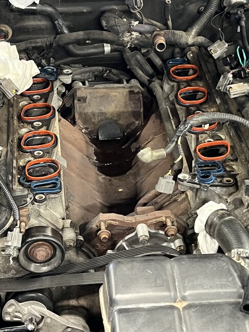

So my car does not have a Schrader valve on the fuel rail. My scanner only allowed me to read fuel pressure (relative to manifold vacuum) kPa. After converting the numbers, I ranged 38-40 psi per my scanner. Also, I found my problem….please see photo. After removing the extra seals, lol, my lean condition is done!
Sep 1, 2025 at 2:50 PM
  • 54,502 POSTS
So it was a vacuum leak, good find, the extra seals are no charge!! lol :/ Thanks for letting us know, we are here to help, please use 2CarPros anytime.
