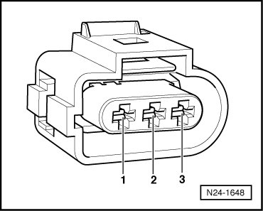

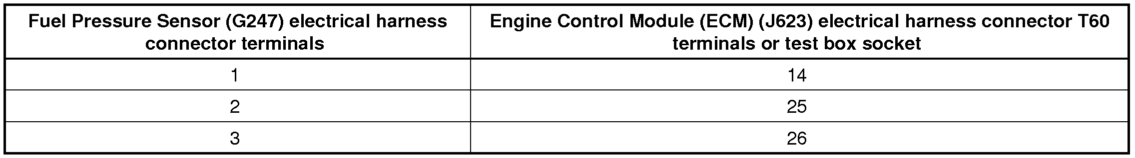

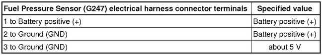

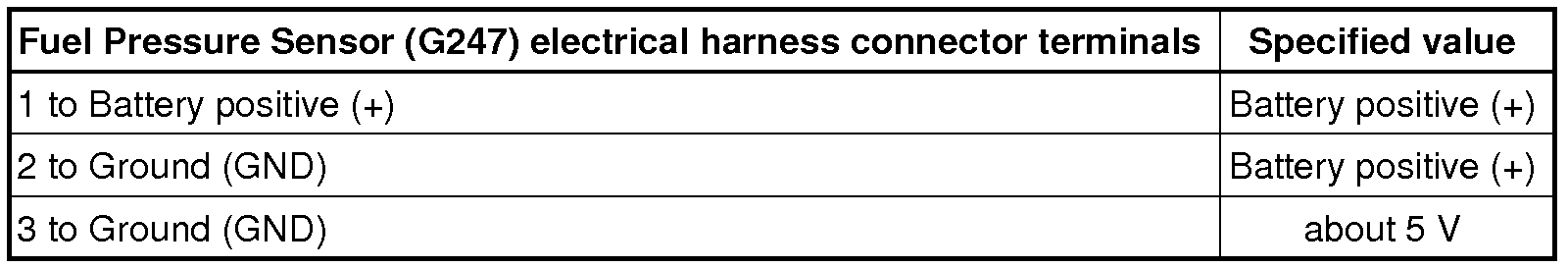

Can you please tell me how much voltage I should be getting from the number 2 fuel sensor which is in the HPFP?
Tuesday, October 29th, 2019 AT 5:26 PM
MECHANIC
110,189 POSTS
Welcome back:
I believe I got what you are looking for. I attached 4 pictures below. Let me know if that is what was needed.
