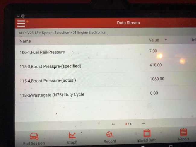

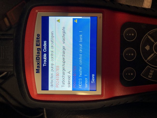

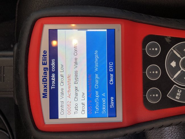

Am a wholesaler, bought this car listed above 2wd, 2.0t . It has a rough idle when first started then smooths out and drives great. Codes were 8852 fuel pressure regulator 2 control circuit, 0051 turbo charger bypass valve control circuit.1092 evap purge valve cir open, misfire on random cylinders. another turbo code and an O2 codes all in the pictures below. if you rev the engine while sitting in park to 1,100 rpm's everything smooths out. checked on the cam follower looks good. spark plugs okay, maybe a bit rich. when you drive the car all good, but when in the morning and sitting very rough idle. i will send a video for the back part of the motor which i believe is the brake vacuum pump? It is making a lot of noise and i know that is a common issue. especially that once, the brakes went all hard and the EPC light came on, now while in front of my house the brake is all hard.clear the codes and all come back together. where is the turbo solenoid on this car i need to check the connections?

Here are few readings after i cleared the codes, smooth after she is warm. With regard to the vacuum pump in back of motor, the hose that goes to it which connects to the little nipple has some free play, if i pull it out and in while car is running there is play and the motor quiets down because when cold she goes in and out few millimeters on its own making like a pinging sound, and this maybe why the brake pedal was once or twice hard as she connects to the booster i believe, the hose going to the booster also has a small crack so taped it for now to see.

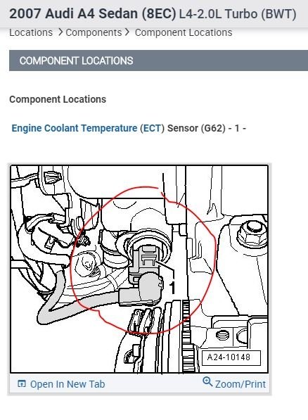

Since this only happens cold, have you checked the engine coolant temp sensor? If it is telling the computer the wrong temperature when cold, it could cause the air fuel mixture to be too lean or rich.
If you have a live data scanner, check it cold and see if the temperature is close to the ambient temp.

checked it this morning which was around 57F on the scanner, pretty much inline with outside temperature since it was cold this morning.

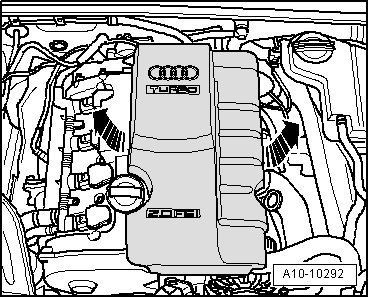

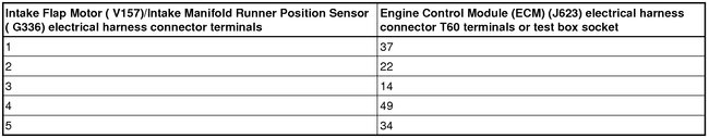

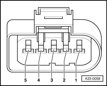

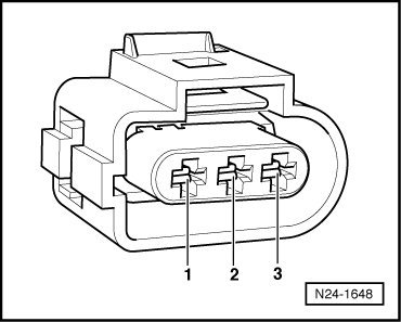

I'm starting to question if it is an issue with the intake runner intake position sensor. Not being there is making these test take long. I'm sorry for that. However, I need you to check the runner position sensor. Here are the directions. The attached pics correlate with the directions.

- Perform a preliminary check to verify the customers complaint. Refer to => [ General Diagnosis ] See: Computers and Control Systems > Initial Inspection and Diagnostic Overview > General Diagnosis.
Start diagnosis
- Remove engine cover - arrows -.
pic 1
- Disconnect the Intake Flap Motor (V157)/Intake Manifold Runner Position Sensor (G336) electrical harness connector - arrow -.
pic 2
- Switch the ignition on.
- Using a multimeter, check the Intake Flap Motor (V157)/Intake Manifold Runner Position Sensor (G336) electrical harness connector terminals 1 to 3 for voltage.
pic 3
Specified value: about 5 V
- Switch ignition off.
If the specified value was obtained:
- Replace the Intake Flap Motor ( V157)/Intake Manifold Runner Position Sensor ( G336).
If the specified value was not obtained:
Checking wiring
If the manufacturers test box is being used. Perform the following step.
- Install the test box. Refer to Fuel Injection and Ignition Repair Information
If the manufacturers test box is not being used. Perform the following step.
- Remove the Engine Control Module (ECM) (J623). Refer to => [ Engine Control Module, Replacing ] See: Engine Control Module > Removal and Replacement > Engine Control Module, Replacing.
- Using a Multimeter, check the Intake Flap Motor ( V157)/Intake Manifold Runner Position Sensor ( G336) electrical harness connector terminals to the Engine Control Module (ECM) (J623) electrical harness connector T60 terminals for resistance.
pic 4
Specified value: 1.5 ohms Max.
If the specification was not obtained:
- Check the wiring for an open circuit, a short circuit to each other, Battery (+), and Ground (GND).
- Check the electrical harness connector for damage, corrosion, loose or broken terminals.
- If necessary, repair the faulty wiring connection.
If no malfunction is detected in the wiring:
- Erase the DTC memory. Refer to => [ Diagnostic Mode 04 - Erase DTC Memory ] See: Computers and Control Systems > Scan Tool Testing and Procedures > Diagnostic Mode 04 - Erase DTC Memory.
- Perform a road test to verify repair.
If the DTC does not return:
Repair complete, Generate readiness code. Refer to => [ Readiness Code ] See: Computers and Control Systems > Monitors, Trips, Drive Cycles and Readiness Codes > Readiness Code.
- End diagnosis.
If the DTC does return and no malfunction is detected in the wiring and the voltage supply was not OK:
- Replace the Engine Control Module (ECM) (J623 ). Refer to => [ Engine Control Module, Replacing ] See: Engine Control Module > Removal and Replacement > Engine Control Module, Replacing.
- Assembly is performed in the reverse of the removal.
Final procedures
After repair work, the following work steps must be performed in the mentioned sequence:
1. Check the DTC memory. => [ Diagnostic Mode 03 - Read DTC Memory ] See: Computers and Control Systems > Scan Tool Testing and Procedures > Diagnostic Mode 03 - Read DTC Memory.
2. If necessary, erase the DTC memory. => [ Diagnostic Mode 04 - Erase DTC Memory ] See: Computers and Control Systems > Scan Tool Testing and Procedures > Diagnostic Mode 04 - Erase DTC Memory.
3. If the DTC memory was erased, generate readiness code. => [ Readiness Code ] See: Computers and Control Systems > Monitors, Trips, Drive Cycles and Readiness Codes > Readiness Code.
End of diagnosis
_______________________________
Oct 14, 2019 at 5:40 PM
NASER NASER
  • 836 POSTS
Checked the intake flap motor harness and it shows 4.95 volts, so is it possible the motor it self is bad? I moved the arm of the motor by hand and it moves, plus i don't see any codes for the intake flap runner, are you pretty certain this points to the motor?
Oct 16, 2019 at 10:11 AM
  • 110,190 POSTS
Welcome back:
Certain, no. Questioning, yes. The symptoms are common to specific things, but everything is checking good. Also, the voltage is actually good.

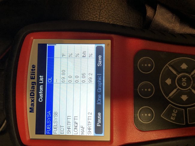

i can send you the fuel trims tomorrow? because that is something i do not understand. car just had another high pressure fuel pump installed from another car.. also found one of the PCV hoses split so i taped it for one not to allow any vacuum. not sure if this is how it was or broke while replacing the pump.
Oct 16, 2019 at 6:25 PM
  • 110,190 POSTS

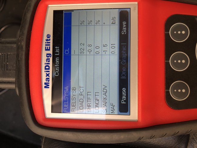

The broken hose can be your issue. As far as fuel trims, they need to be as close to 0 as possible. If the trim is in the positive range, the fuel mixture is lean and the comp is adding fuel to compensate. If the trims are in the negative range, the mixture is rich and the comp is trying to remove fuel from the engine. As you already know, a lean or rich fuel mixture can be only caused by so many different things. So, based on the readings, those are the things needing checked.
That is just a general idea of how it works. It can become much more involved, but I'm just trying to help you understand. Hope it helps.
Let me know what they are when the problem is happening. It has to be then because the engine is running in a closed loop before it reaches a specific temperature. It may be very helpful.

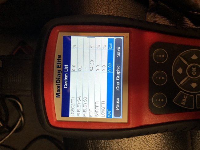

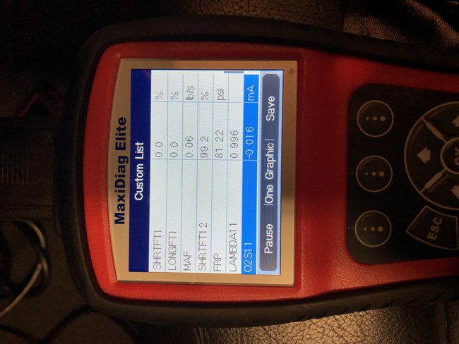

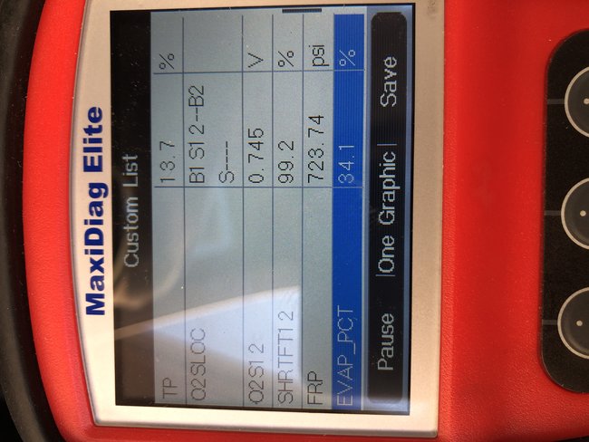

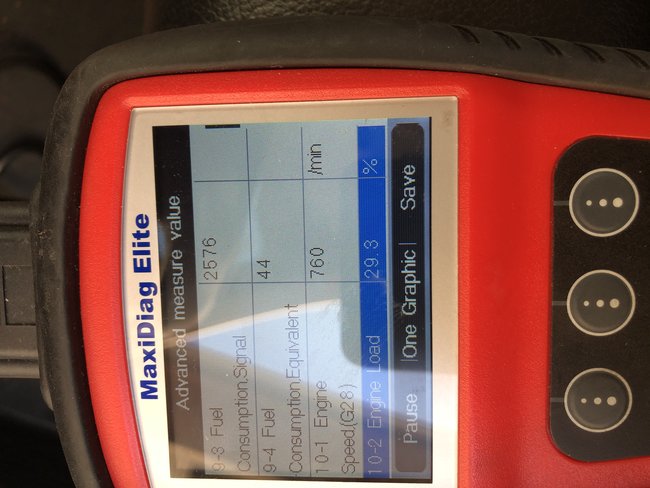

Take a while to start. but here is what i have first when i first started and foot on the gas so she wont stall.
Oct 17, 2019 at 6:24 AM
NASER NASER
  • 836 POSTS

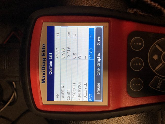

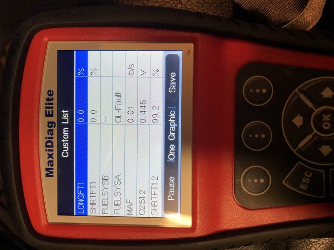

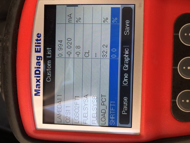

This is after a minute or so after the rom stabilized and engine can run without me stepping on the gas.
Oct 17, 2019 at 6:25 AM
  • 110,190 POSTS
Welcome back:
The STFT are not present on the scanner. Does it change when it warms up?

I cannot seem to find any of the fuel trims on the scanner, it is no where to be found.

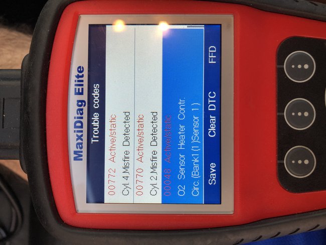

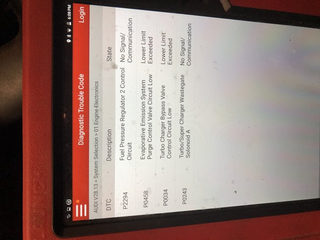

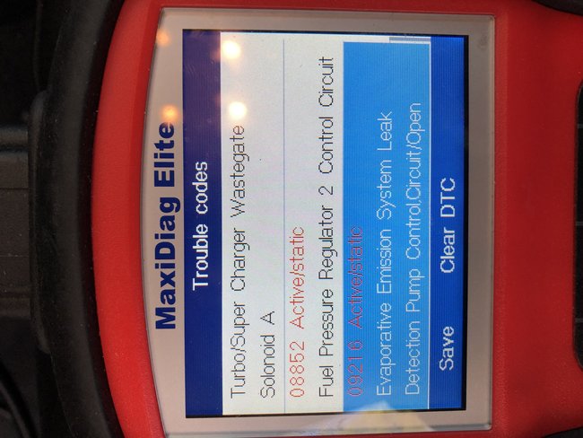

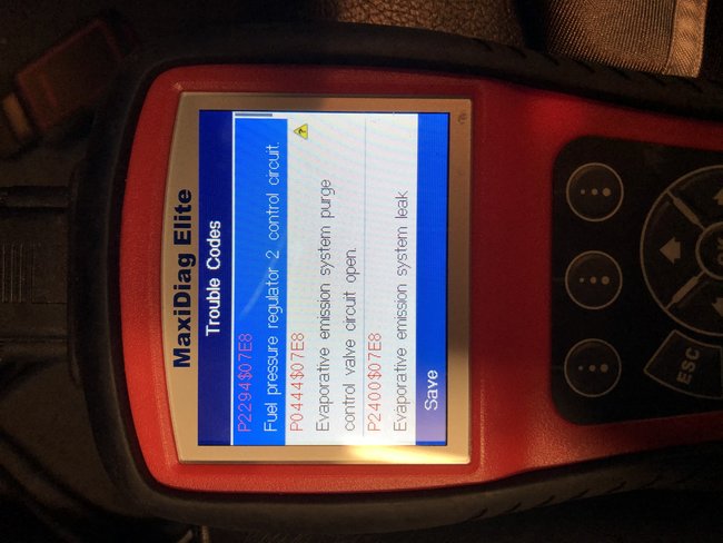

Replaced that broken PCV hose, delete all the codes but 4 stay and never go away and the EPC light never goes off, hard to start about 3 times of turning over before it fires up. but did start today with no stalling. codes are in the picture. removed the sensor in the turno yesterday and it looks good and clean and clicks when i press the little nipple. There was oil though in the hose that is on the bottom of the turbo from bottom, about half quart or so not sure if normal. And starting to lean towards the turbo or carbon build up. what do you think?
Oct 19, 2019 at 4:12 PM
  • 110,190 POSTS
Looking at the codes, there are several things that can be causing the issue. The hard start really leads me to believe there is a fuel pressure issue and one of the codes indicates an issue with the regulator. Additionally, the EVAP code can be causing a rough idle.

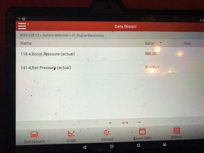

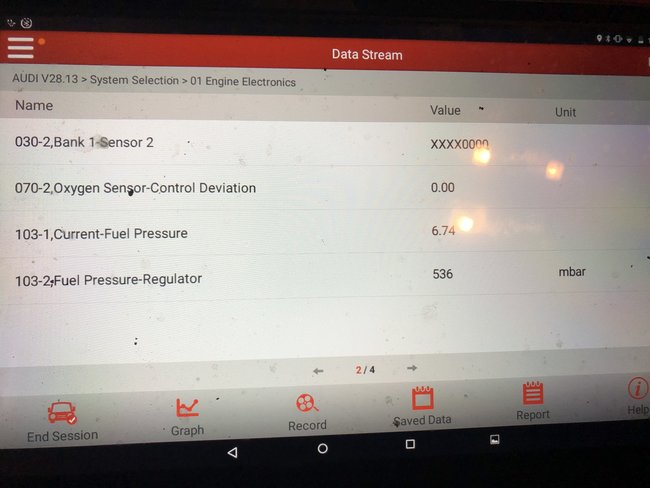

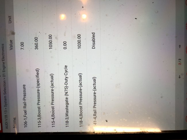

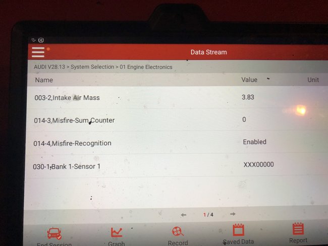

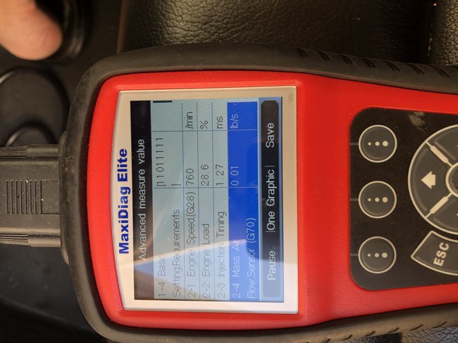

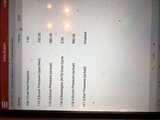

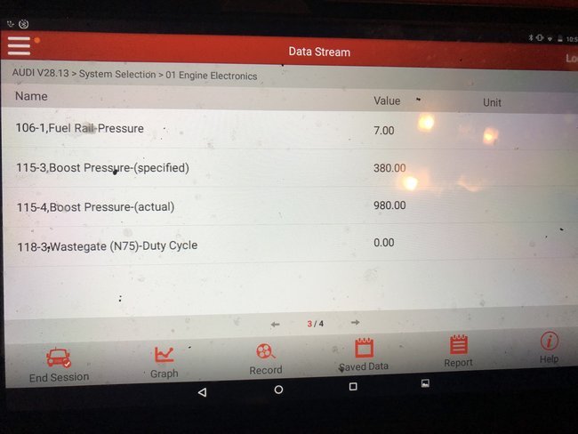

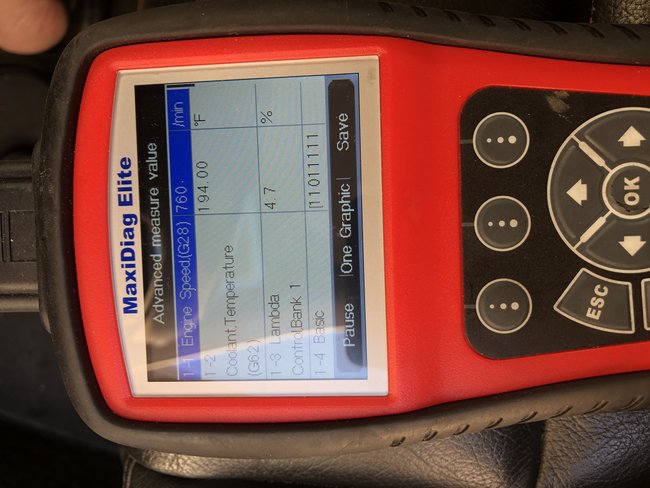

These are some data from when the car is cold. When the gas pedal is pressed the intake flap arm moves. Again it is a long crank and for few seconds it is idling rough then stabilizes. Can you see if you can spot anything from these data when cold and I will send another set when warm. also in this picture here is before and after i press the gas to boost the turbo.
Oct 29, 2019 at 9:03 AM
NASER NASER
  • 836 POSTS

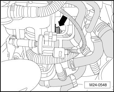

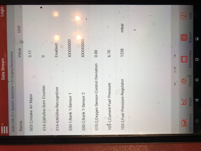

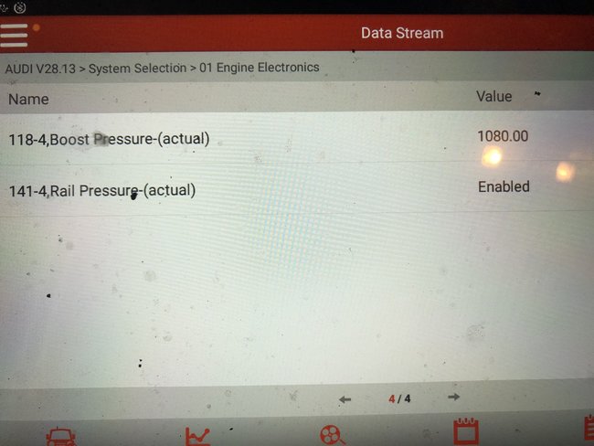

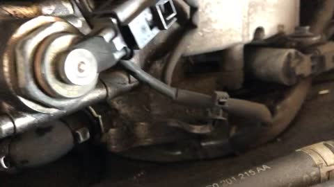

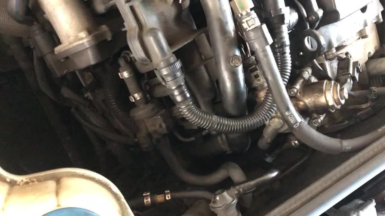

These after she is warm. I checked the connections at the turbo, the evap, and hpfp and all are good.
Oct 29, 2019 at 9:05 AM

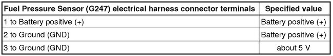

can you please tell me how much voltage i should be getting from the number 2 fuel sensor which is in the HPFP?
Oct 29, 2019 at 5:26 PM
  • 110,190 POSTS
Welcome back:
I believe I got what you are looking for. I attached 4 pictures below. Let me know if that is what was needed.
Oct 30, 2019 at 5:34 PM
