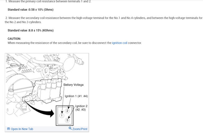

I have seen the ignition coil cause this problem and not cause a check engine light. Get a quality replacement part. Here is the location of the coil in the images below.

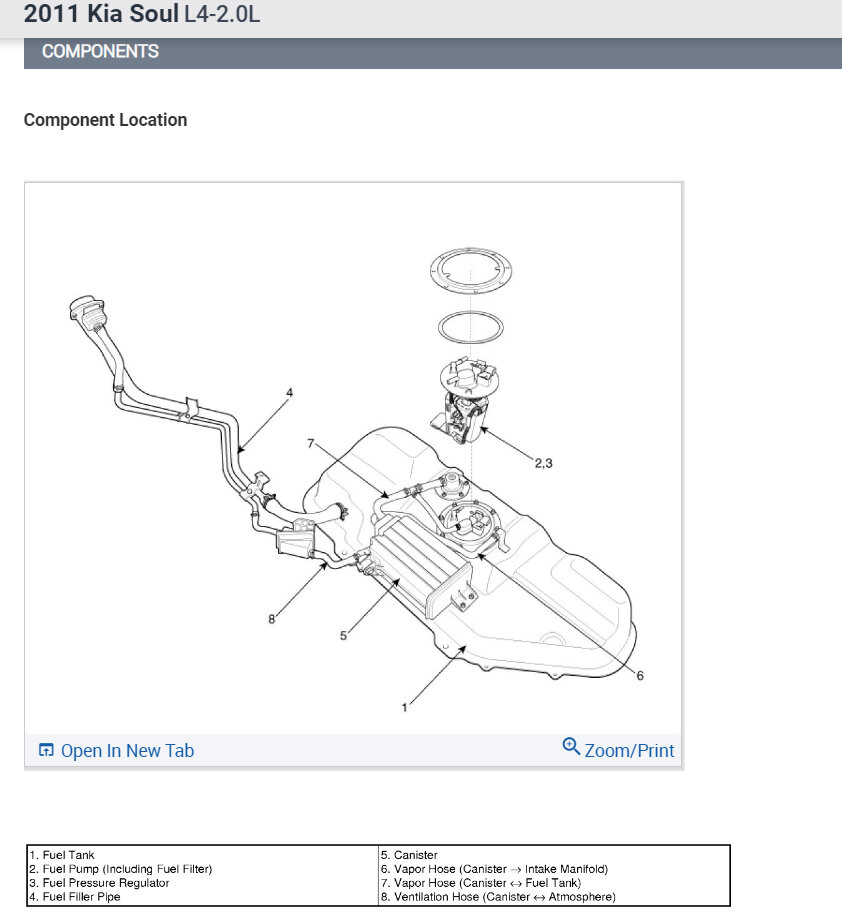

That can be, a weak fuel pump can cause that, we can confirm the problem if we do a fuel pressure test. This guide fan helps and you can get a fuel pump pressure gauge from the auto parts store and rent it for free or cheaply.

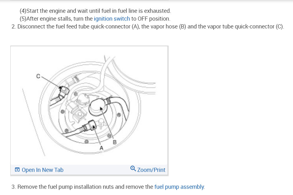

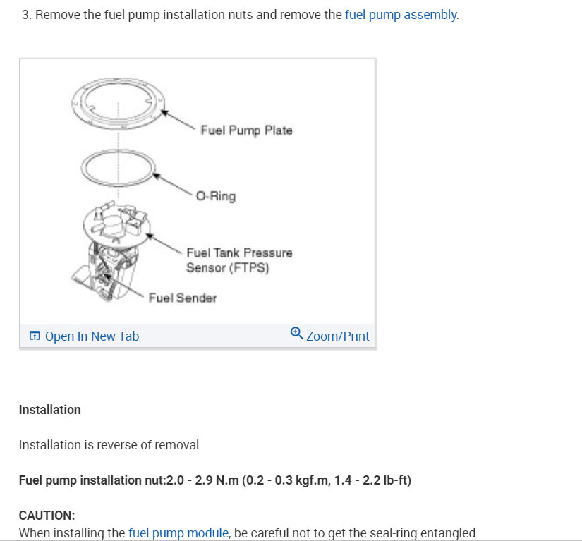

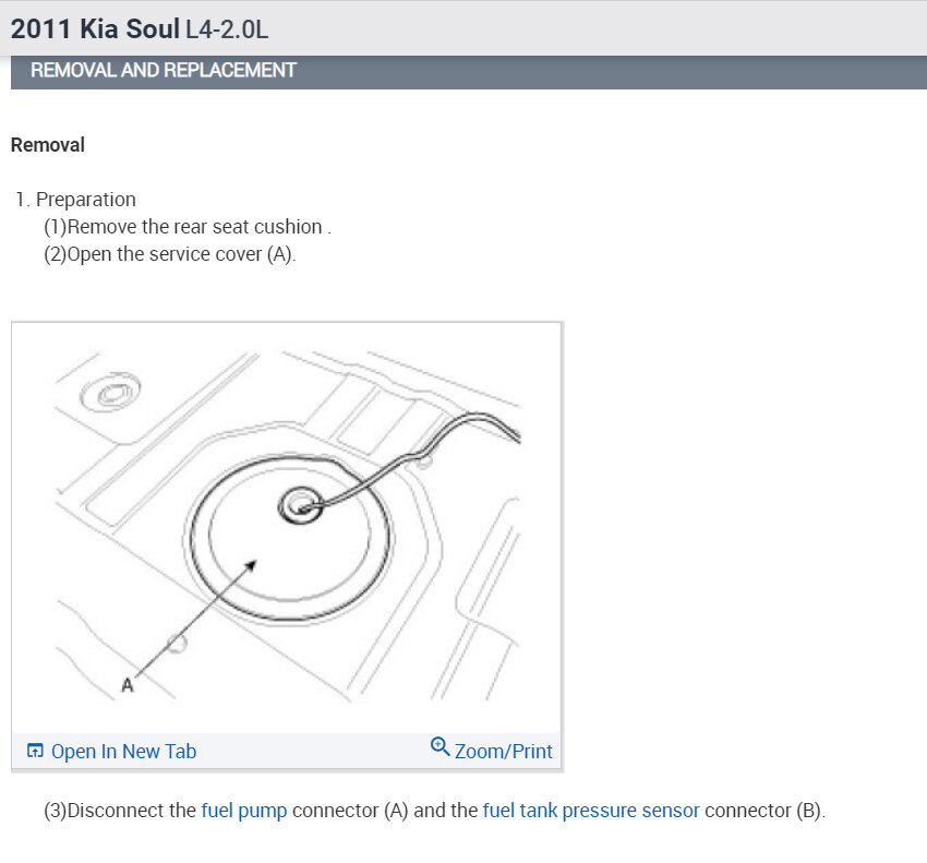

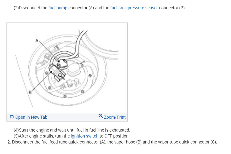

Yep, it is under the rear seat which is nice here is how to change the pump out, please get a high-quality replacement part to help the repair go trouble free. Check out the images (below). Please let us know what happens.
