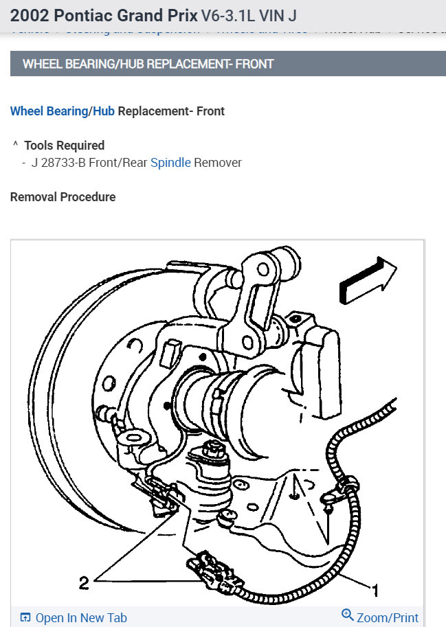

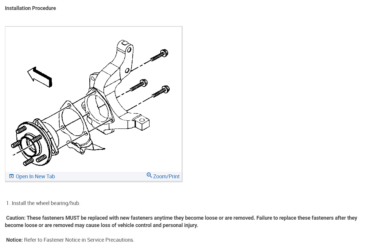

I've wrote you a few times on this same vehicle listed above, why would it sound like I'm riding on all-terrain mud tires on the front, it just started doing this about a week ago with the loud road noise, could it be the wheel bearings because I replaced them a couple years ago with a cheap set. Any help is appreciated!
Thursday, November 2nd, 2023 AT 10:00 AM
7 Replies
KEN L
  • MASTER CERTIFIED MECHANIC
  • 55,522 POSTS

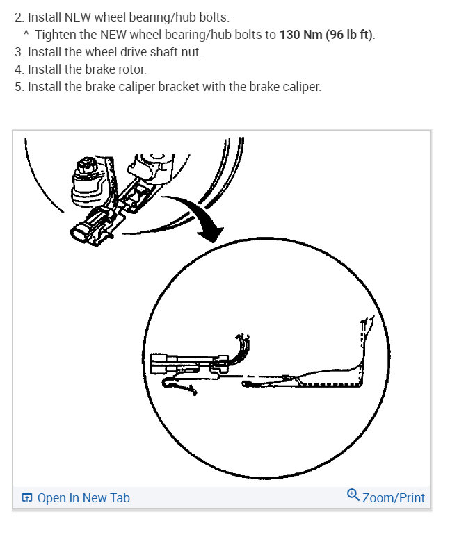

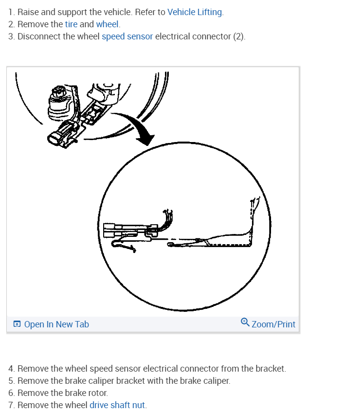

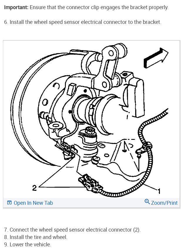

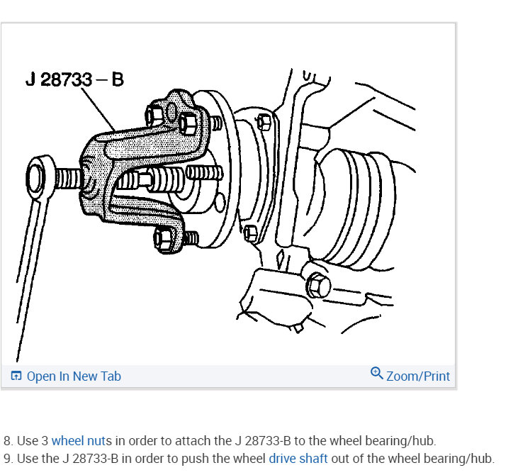

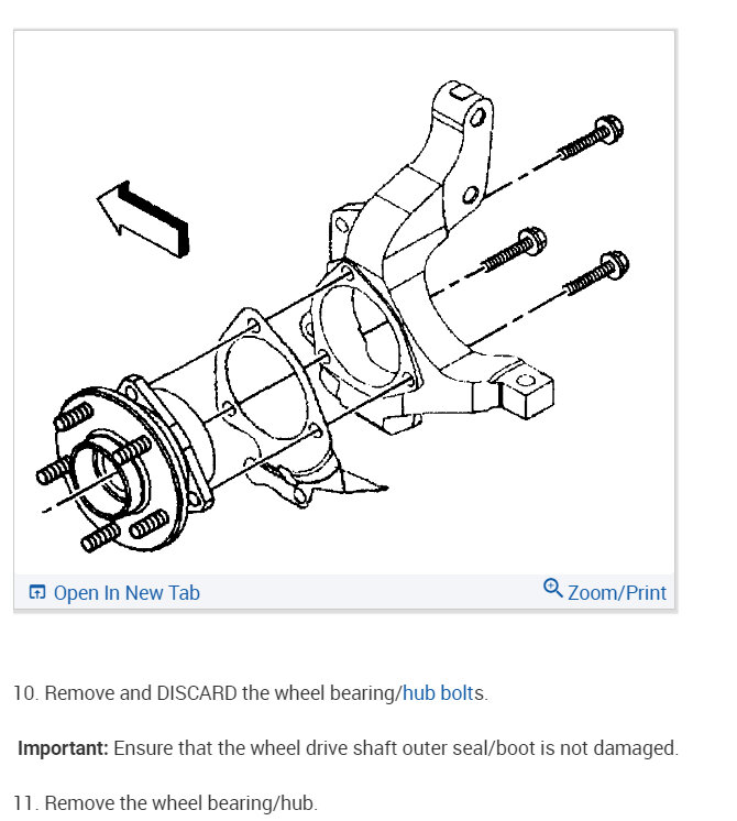

Yep, you nailed it, the wheel bearing hub will make this sound when they go out. Here is how to change them out correctly in case you need it. Check out the images (below). Please let us know if you need anything else to get the problem fixed.

I replaced the front wheel bearings and the ABS and Traction lights are still on, don't I unhook the battery to reset the lights.

Is the noise gone? Also, the ABS system will reset on its own with no need to clear codes. Let's run the codes to see what is stored.
https://www.2carpros.com/articles/anti-lock-system-testing-and-repair-abs
Please go over this guide and get back to us.

The noise is gone but the lights are still on!

Good job, we need to run the ABS codes to see what code it says, also did you try clearing the codes?
