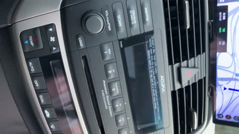

It stops when I lift my foot off the gas and continues when I push it. It will go away after like 10 mins but it’s a really high pitch sound like the sound after your ears pop. And I hear it from the inside like it’s coming from the radio or something.

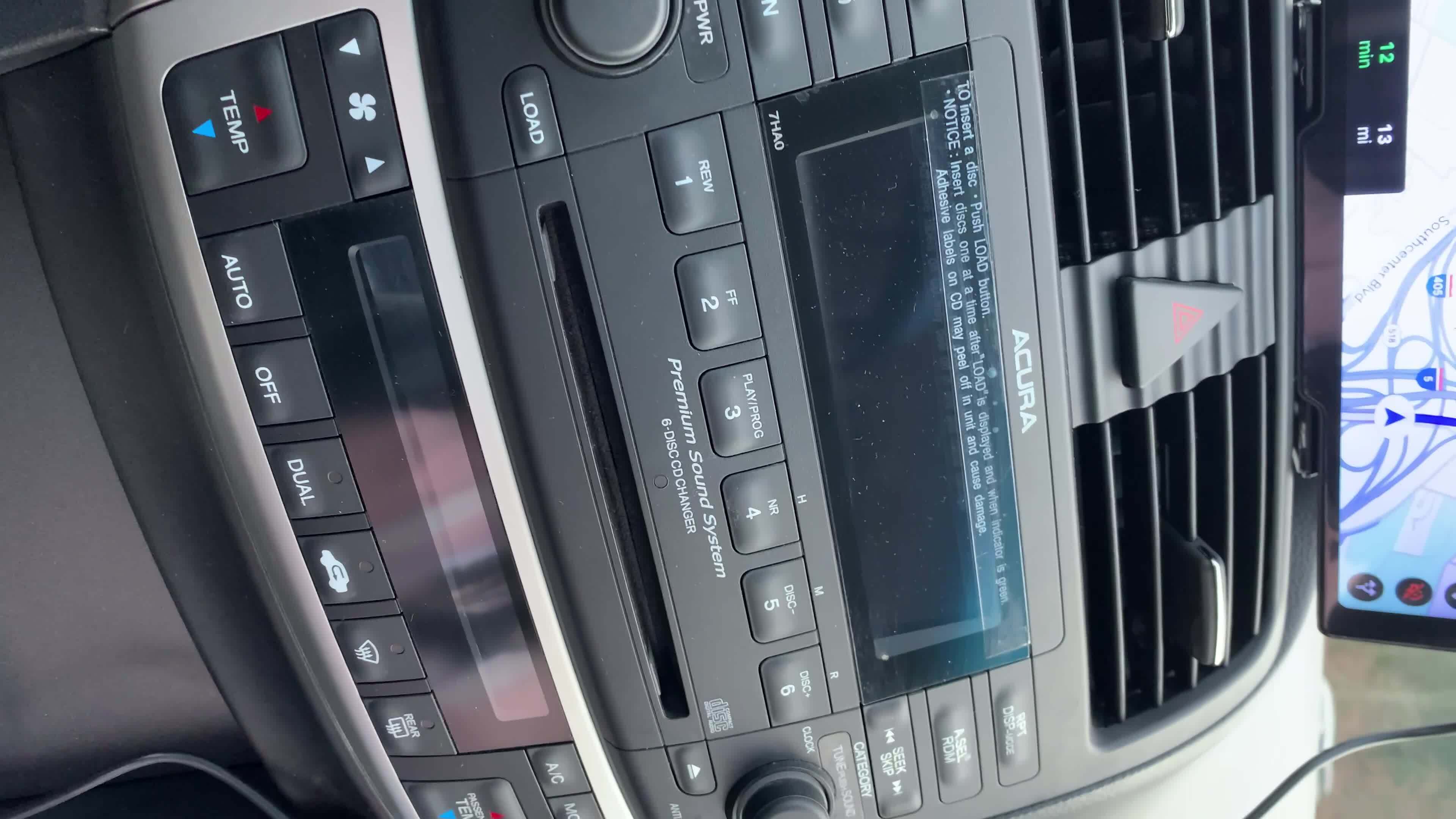

You can’t really hear it well but the air and radio is off. As I go faster than 60 MPH the pitch gets higher and louder.

No, not a hybrid model, and it seems to be coming from the front, like almost from the radio. Also both the screens are extremely dim and I don’t know how to fix that.

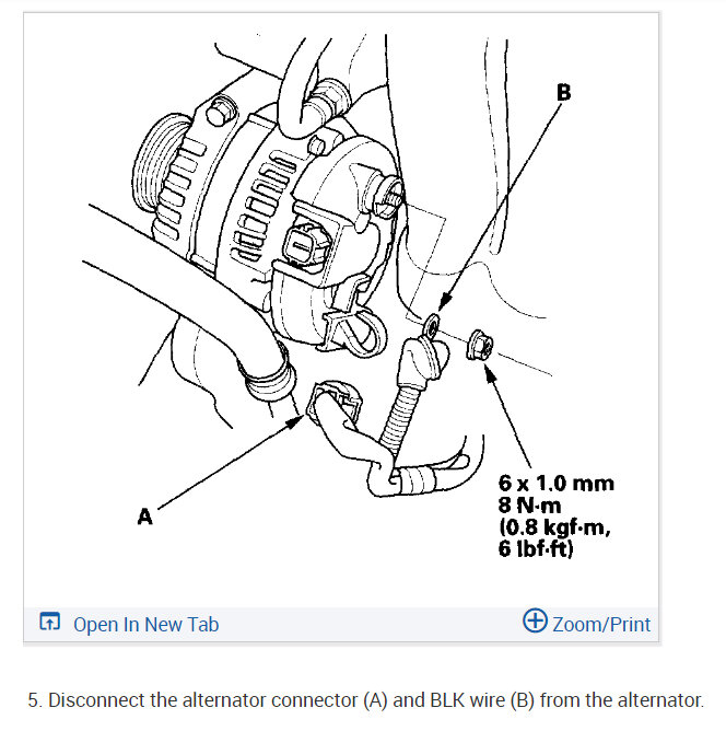

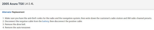

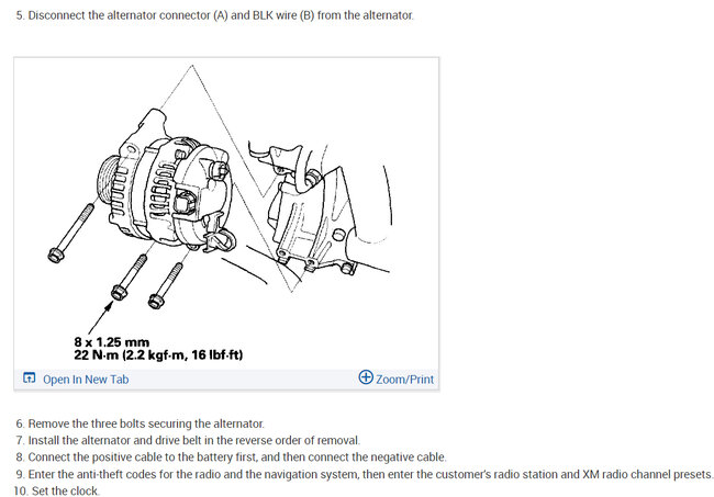

Okay, it sounds like the alternator or battery needs to be replaced. This sound can come from the electrical system/alternator if one of the diodes inside the alternator has gone out or if the battery is having a problem and the alternator is overworking causing the noise. I would use a voltameter and switch it to AC voltage, then rev up the engine while the leads are connected to the battery, the voltage should stay at 0, if you get any voltage the alternator is bad.
Here is a guide to help you:
and
Here is how to change the alternator in case you need it or what to see what needs to be done. Check out the images (below). Let us know how it goes.
